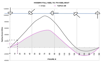

Here is a good article on stability:
Here is a graphic from the article comparing an Island Packet (blue) to a Tartan (red):
The higher righting moment of the Island Packet to the left shows that it will resist heeling about twice as much as the Tartan. The Tartan reaches vanishing stability at 120 degrees (where the red line crosses zero), while the IP is around 133 degrees (blue line crosses zero).
Extensive tank tests show that these curves are not so relevant in preventing a capsize. All hull shapes will capsize when struck on the side by a breaking wave higher than the beam of the hull.
The curves are critical for recovery from capsize (assuming the cabin is watertight.) The IP only has to tip over 43 degrees (180 less 133) in the waves from the inverted position to return to upright. The Tartan would have to roll over 60 degrees (180 less120) from inverted for the same result. The shallower depth of the IP curve on the right (inverted) side also means it takes half the rolling force from a wave to get to positive stability.
