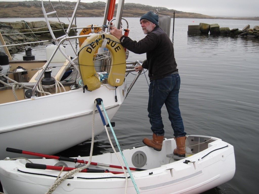

Some years back I installed a SS rail in our 10 ft RIB to facilitate boarding from docks and from Maxine. Unfortunately I do not have a pic but the rail is approximately 48 inches high and spans the full deck width of the RIB. Such a device is very helpful boarding and could be helpful in standing after sitting. We have an 11 ft Whaler also and I understand the rising and sitting issue with all traditional whalers. In the 11 ft I made seat backs for both seats and that also helps. One's butt has a long way to travel when sitting or rising in the Whaler. I know it well.
