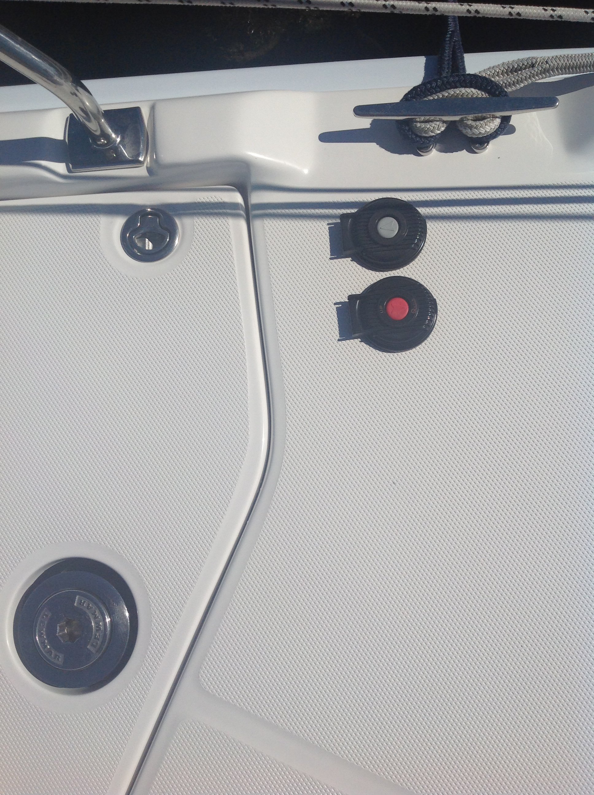

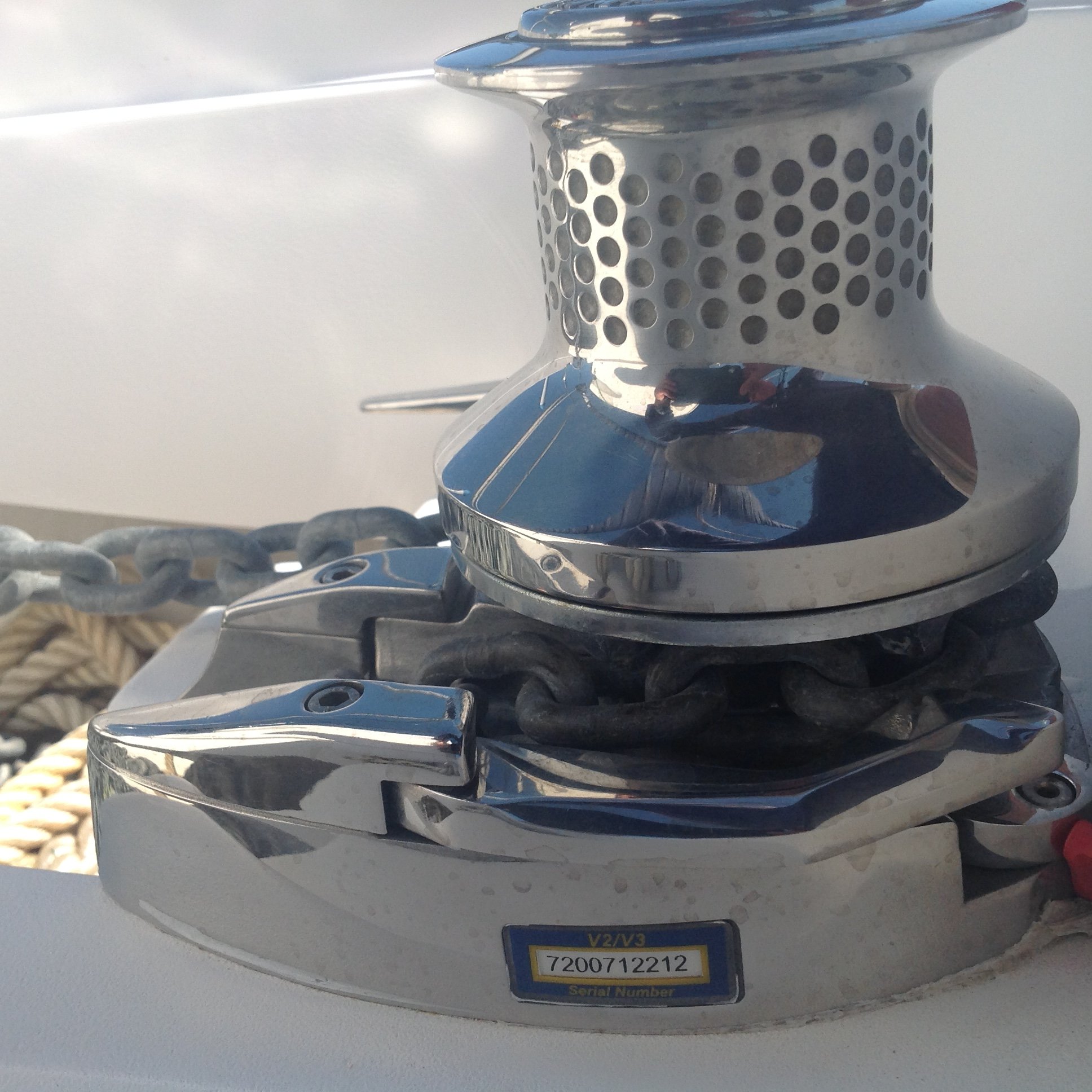

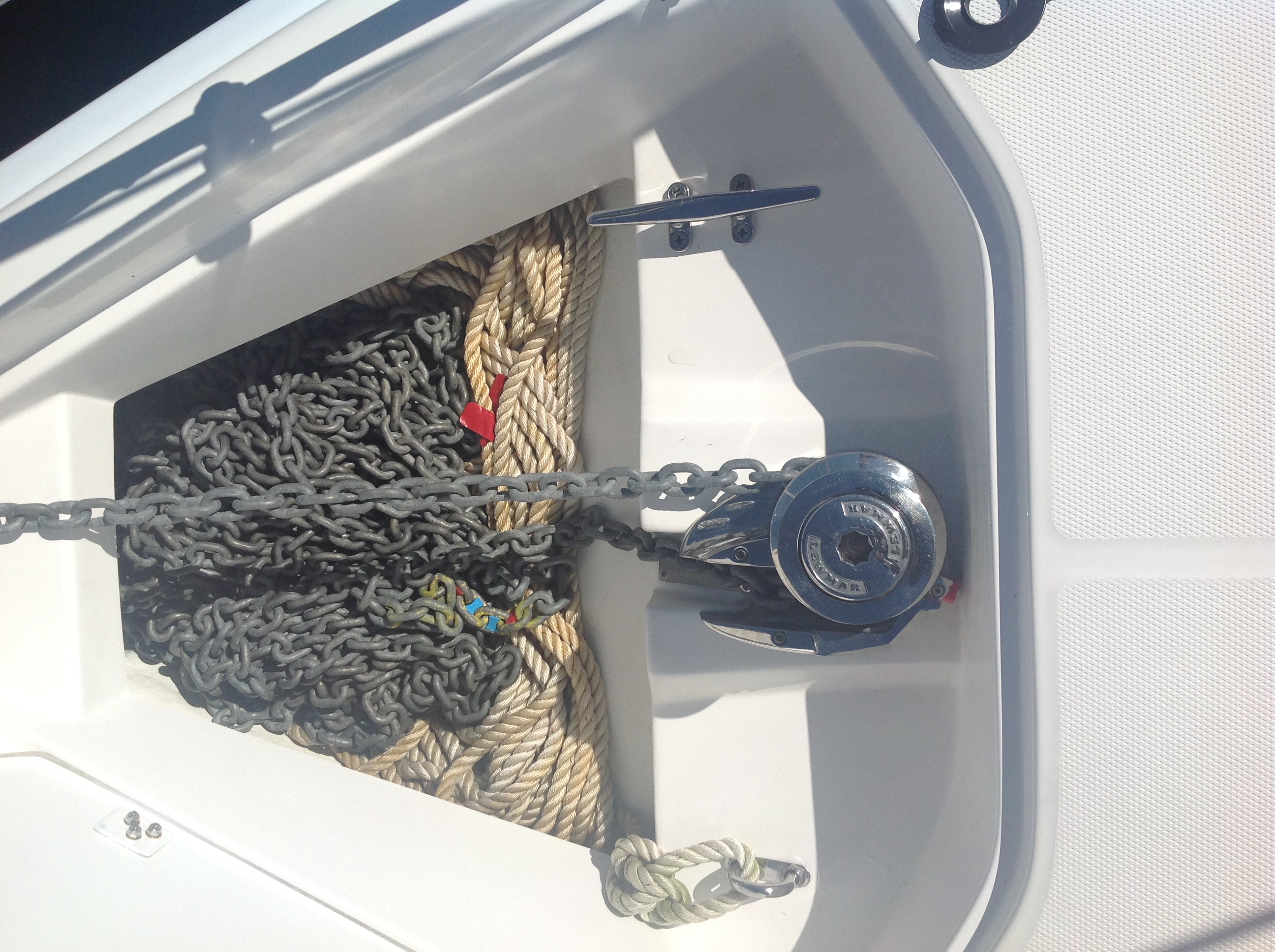

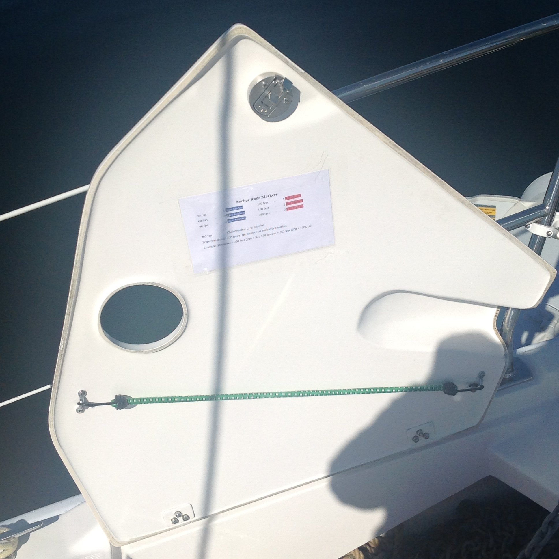

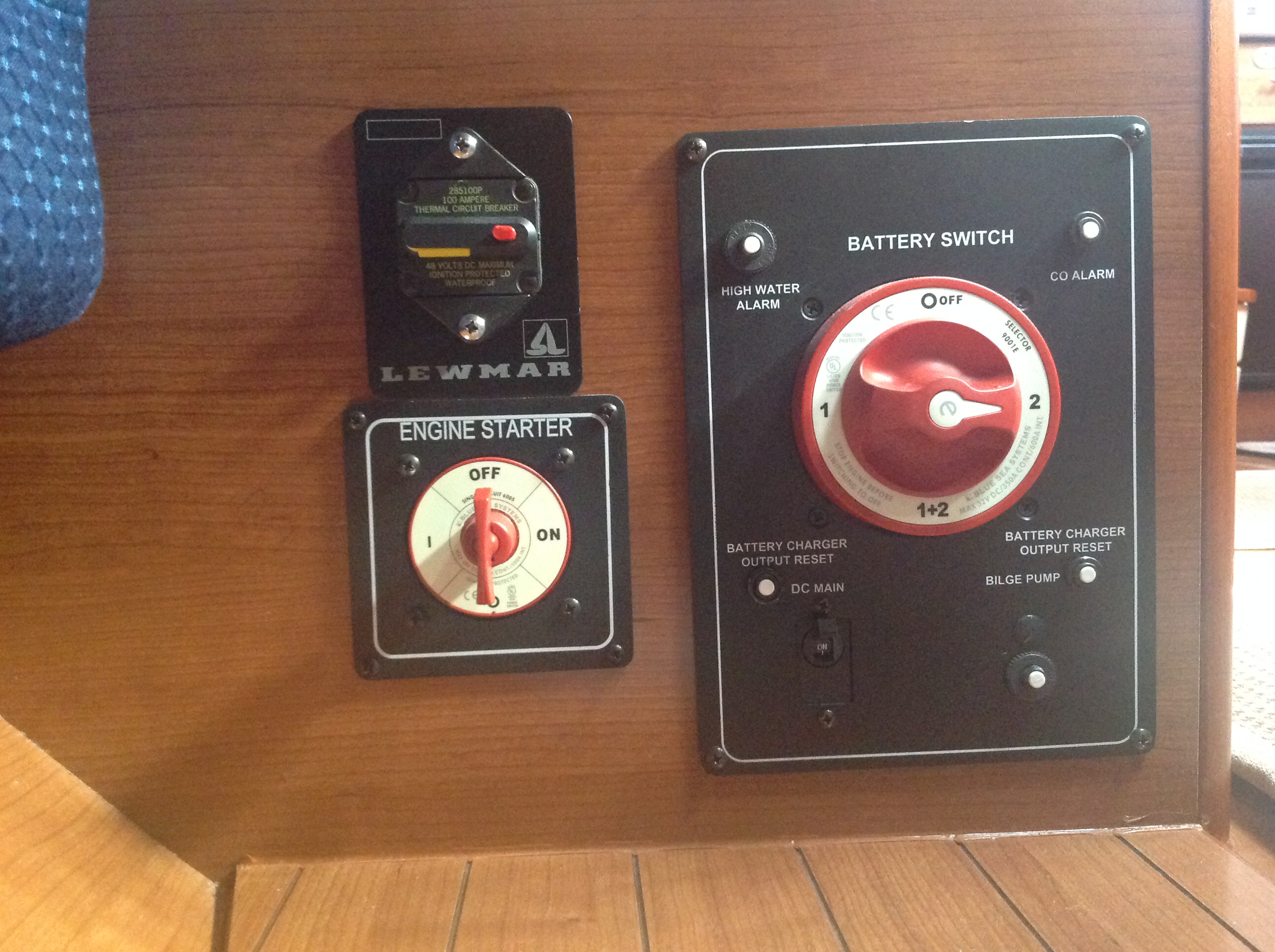

Sometime ago I queried Lewmar about the model of the windlass fitted on my 2012 e33. The reply email was lost with the death of a laptop this spring; however, if I recall the windlass is a Lewmar V3 modified especially for Hunter. It is a vertical windlass with a gypsy and drum. I am currently using 200' of 5/16" G4 spliced to 250' of 1/2" three stand. Hanging off the end is a 35 lb Manson Supreme. I have used the drum, in the past, to hoist a friend up the mast to do some inspection for me. I assume that because the windlass was an option that year that the mounting base is in place. If you would like some pics, I can help you out.

I agree with post # 6 (Ice Breaker ) If anchoring is easy you will do it more often and in bad conditions its a must. Ive decided to get a Lewmar V3 with the drum if post #9 (Hello Below ) could send some pics that would be great. Thanks to every one for there opinions its very helpfull

Thats way too clean for an anchor locker.... where is the mold and algee?????? haha
Thanks . . . I think??? Since boat new 5 years ago, that ground tackle has been up and down more than 100 times. Funny the Manson Supreme label is still hanging on. Just.

Looks great. I wish I made the time to do the things I would like to do........maybe in retirement.
