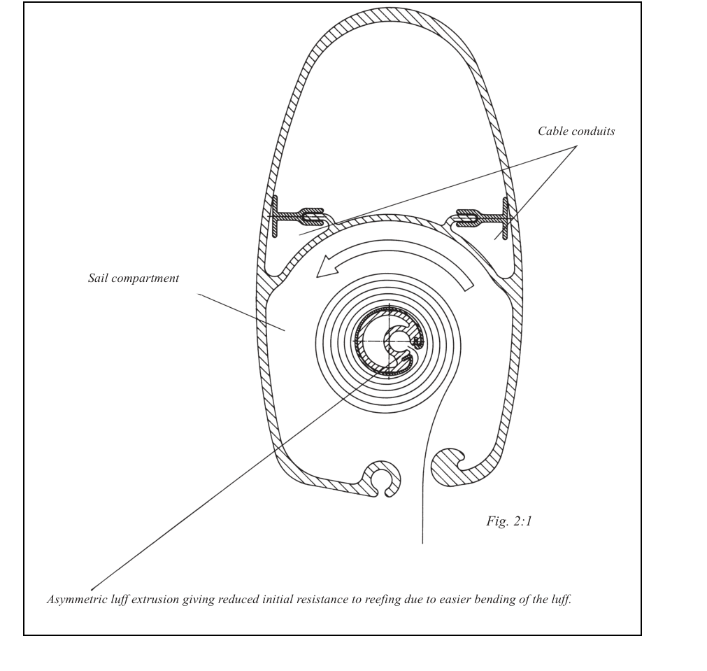

Struggling with my Selden inmast furler system on my C315: After problems with unfurling the sail, I tried all remedies: tensioning the extrusions, adjusting the boom angle when furling in, greasing the bearings, re-adjusting stays and shrouds . Now I got the sail down and it will not get up anymore. The halyard swivel jams (most of the times) where the Selden Mast pieces are riveted together. I can get the swivel through that, but then it stops completely at the lower spreader point. I have adjusted the tension on the extrusions from quite loose to medium tight (the extrusions are NOT touching the walls inside the mast), but do not see any difference in the extrusion position. Has anyone experienced this problem? Does anyone know if there is only one extrusion piece inside the full mast length or are those several pieces (like the jib furlex)? If I do not get the swivel going I think i need to unstep the mast and examine the Selden system in the horizonal. After that I can continue evaluating the furling issues. Right now I am ready to abandon the entire system and re-rig the mainsail the traditional way. Any suggestions are welcome!1

It sounds like the slot in the mast is pinched at the lower spreader that is giving you grief getting the halyard swivel up past that point. The halyard swivel 'tail' that extends out through the mast slot will bind in the slot if this is pinched enough - sight up the back of the mast to see if this is the case.
