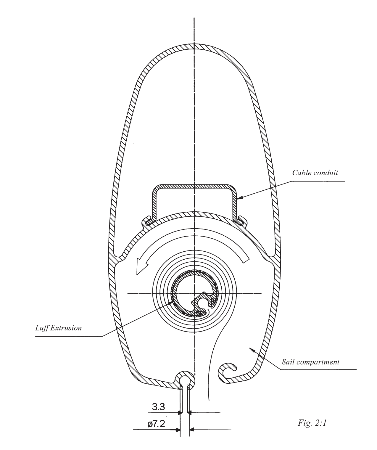

I agree with the suggestion to ask Seldén for the manuals. It's easy. Take a picture of the serial number etched into the base of the mast and send it to info@seldenus.com
Ask them for links to the manuals and parts list for the mast and boom. They will reply in a day or two with links to download the manuals.
The sail should wrap around the starboard side of the furler according to the picture below. Turning the furling winch clockwise ensures proper wrap.
I bought a new sail using relatively light 7.5 oz cloth and it required a little more encouragement to furl the first season. But only a little more. It should be something you can accomplish from the cockpit using the furling loop assuming the other things mentioned are setup correctly. I would not go back to a traditional mainsail now. The little bit of shape control you sacrifice for ease of operation is well worth it for my type of sailing since I'm not racing round the bouys.
