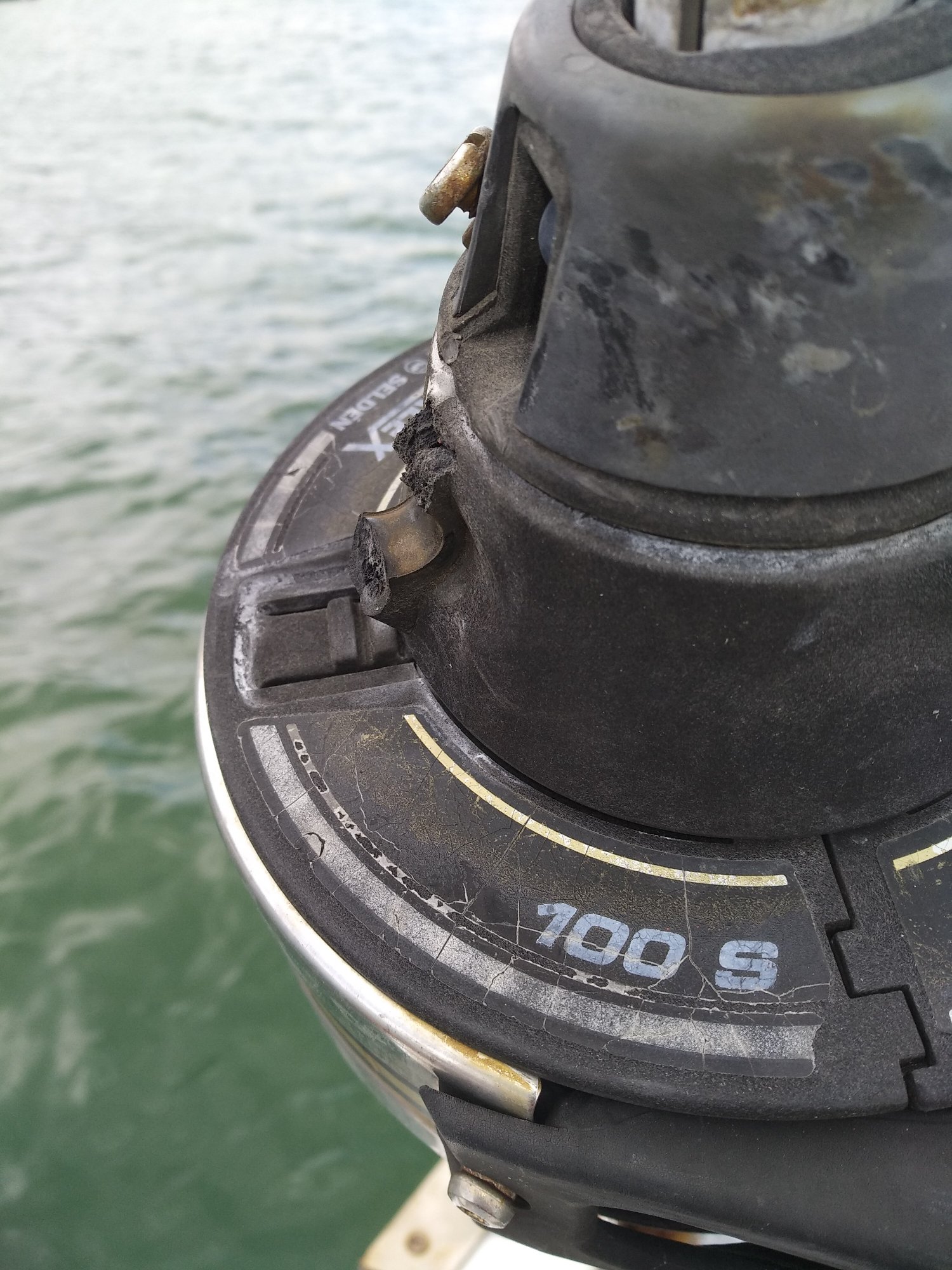

I broke my Tack Ring for Selden Furlex 100S. Would appreciate if someone could advise an English website that sells this item. Or perhaps Hunterowners Store has this item?
Selden 100S Tack Ring p/n: 539-355.

Thanks for the idea. Let me think about it. Btw, my Tack Ring was seized. Usually it could turn about 270deg. Not sure if that's part of the problem.

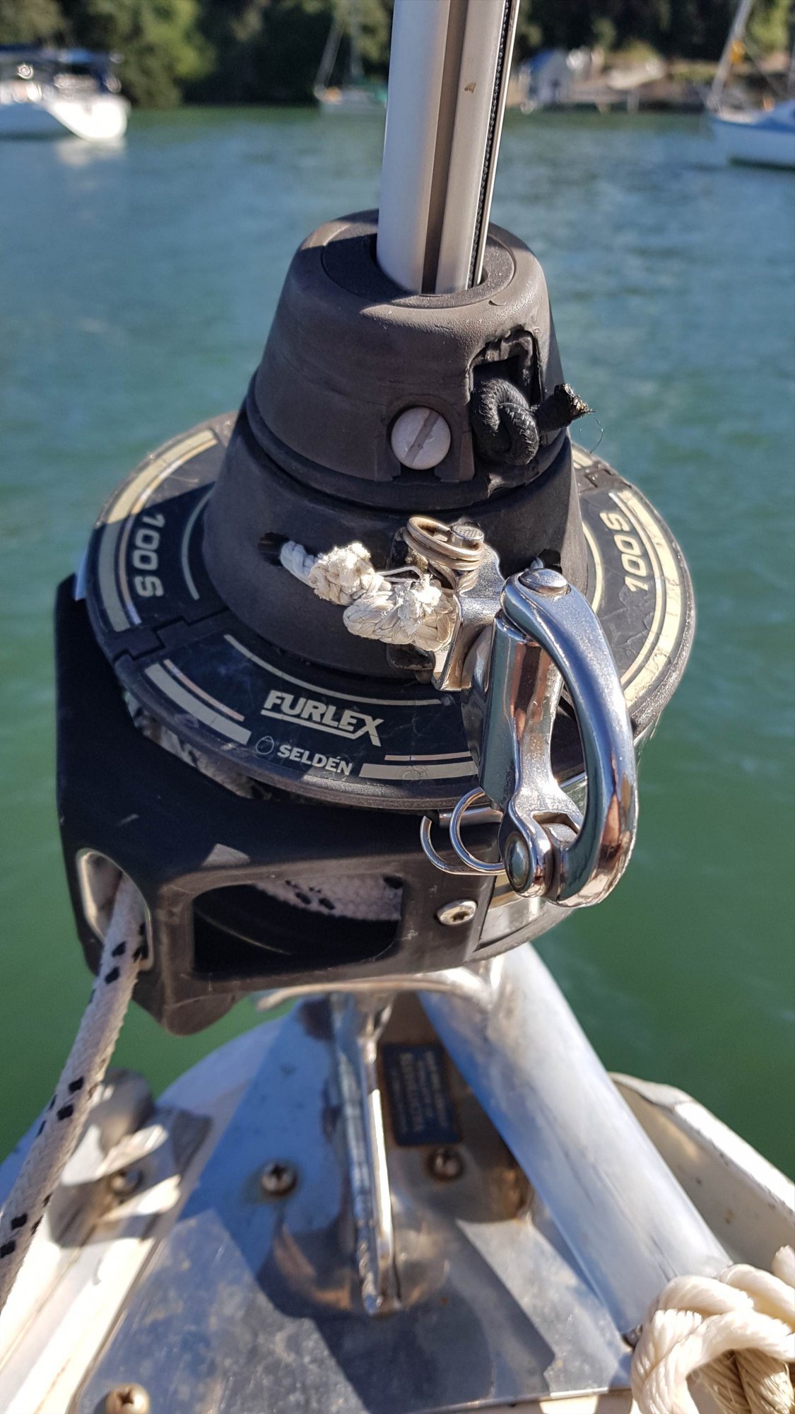

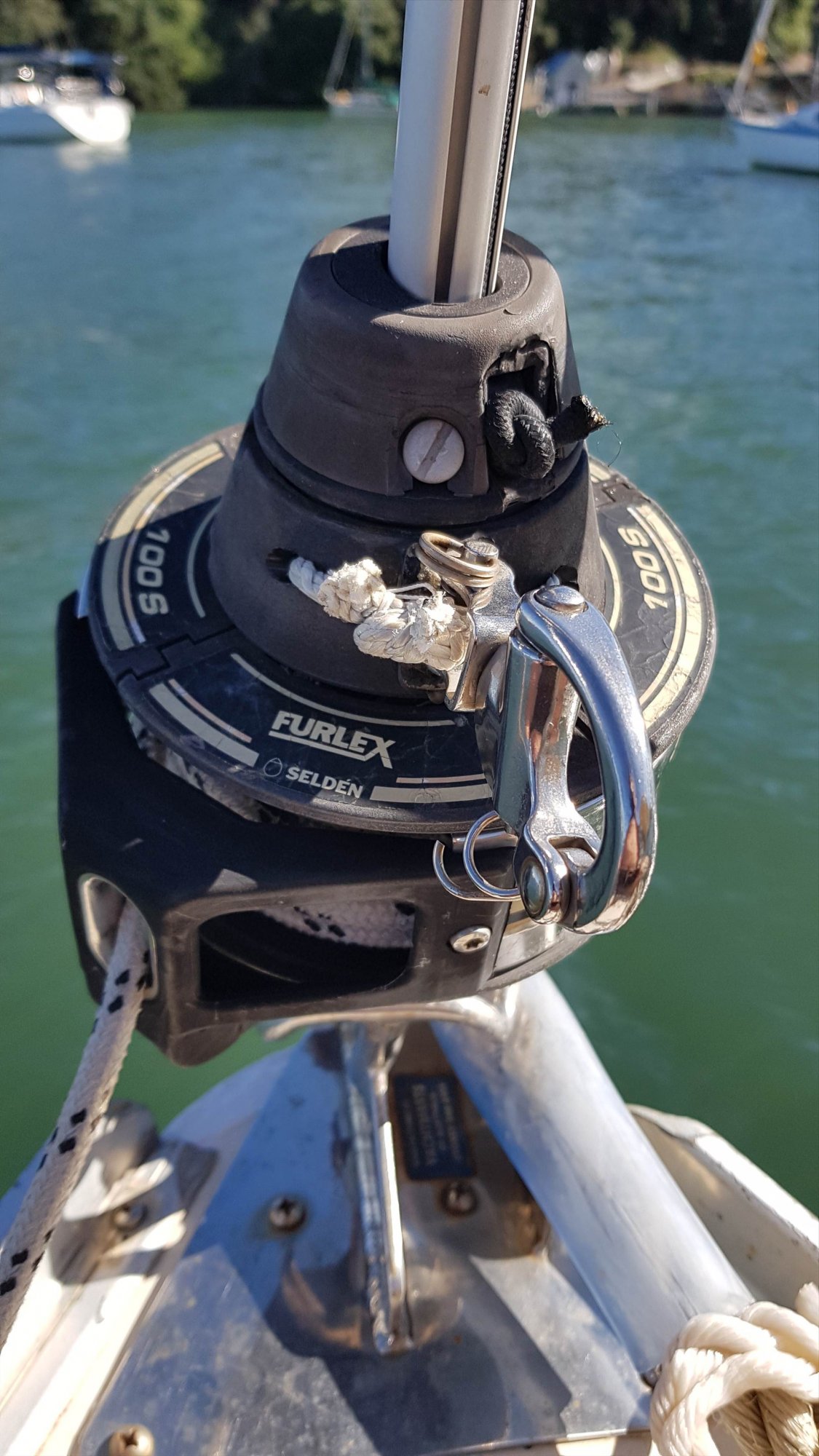

Found this "Quick Fix" like you mentioned. Maybe worth a try.
Thanks.
Ken Y
After 2_1/2 years, the quick fix Tack Ring still holds. One mistake I did was to use a smallish line (2mm) which cuts through the plastic Tack Ring part way. Should have used a large sized cord like 4-6 mm. I'll try change it.
