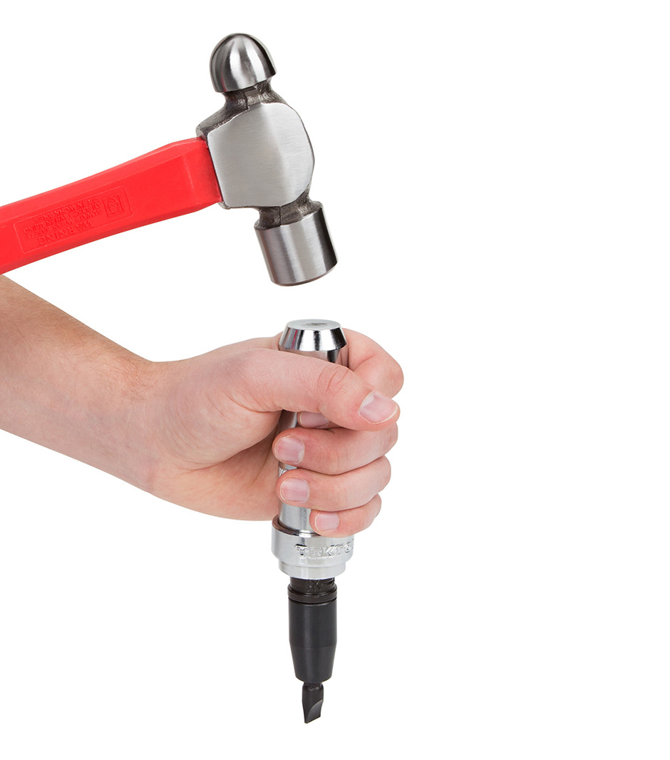

You can use an extension and socket with these too. Just make sure it twists in the right direction.

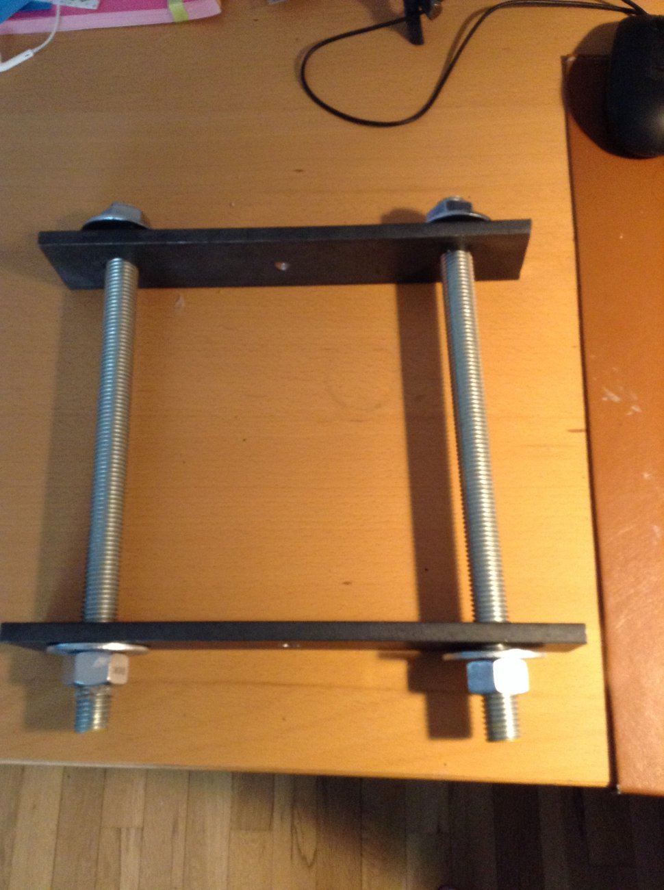

I had some stainless u-bolts stuck in aluminum that I applied PB Blaster to twice a week for two months, applied heat etc. In the end, I had to cut the "U" in half so I could unscrew the two-halves of the u-bolt (even that took a long pipe for leverage) - once apart, I could see that the PB Blaster hadn't penetrated the (white) corrosion at all. The bolt that holds the quadrant to the rudder stock (mine was actually a SS pin) was also really stuck - I had to build a substantial press (3/4 thread rod, 1/4" steel bar) to press it out - took a lot of force and made big noises. Again, there was white corrosion that PB Blaster didn't penetrate. You might consider designing a press if you can access the bottom of the bolt. Here's the press I used:

I have an impact driver that is powered by a hammer. Check Powerbuilt 648002 at Home Depot. This works by striking the end cap with a hammer. The force of the strike does 2 things. As the base is driven down ( in) it's internal mechanism turns the bit. Second, the impact forces the bit to maintain deep contact and negates walk out.
