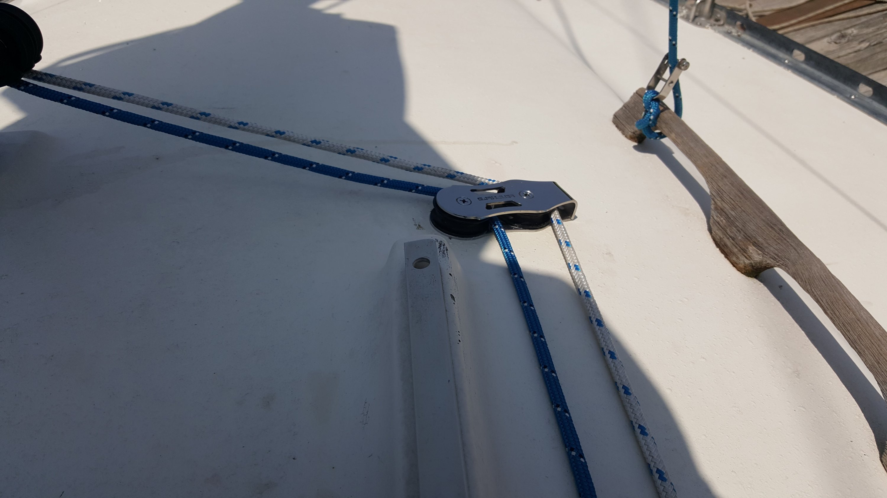

Replaced all running rigging
Added a tiller tamer

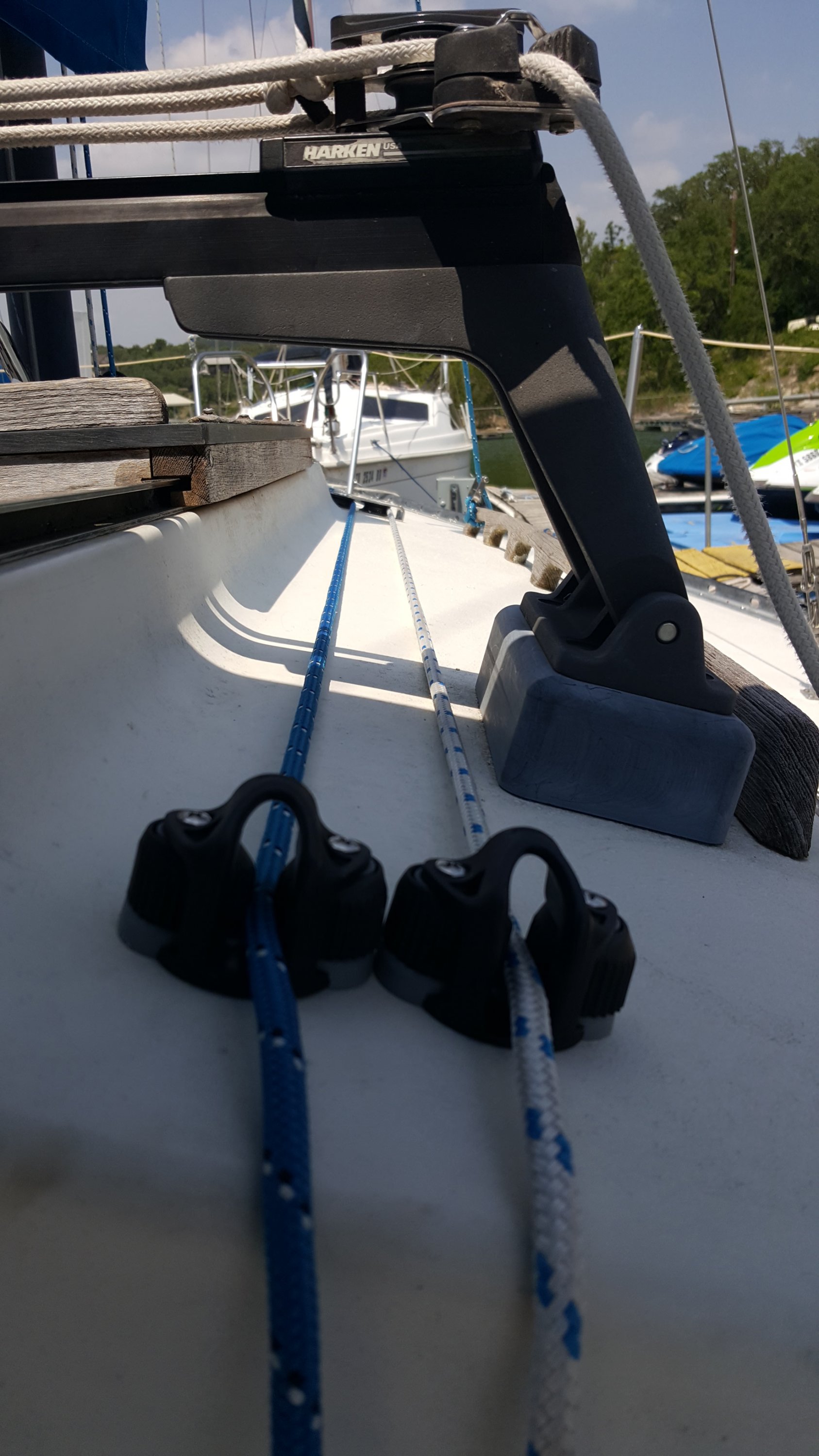

All running rigging has been run to the cockpit.

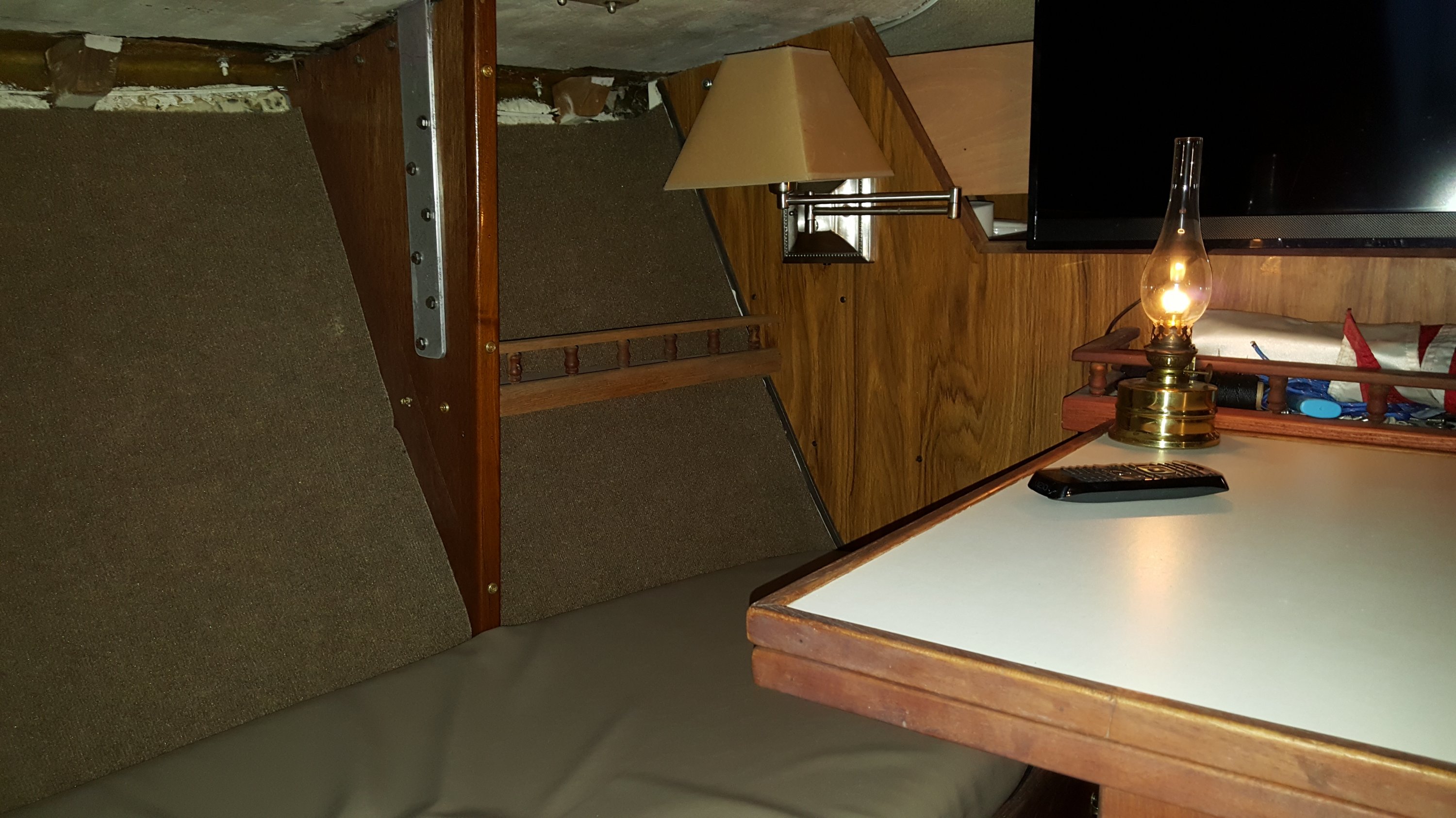

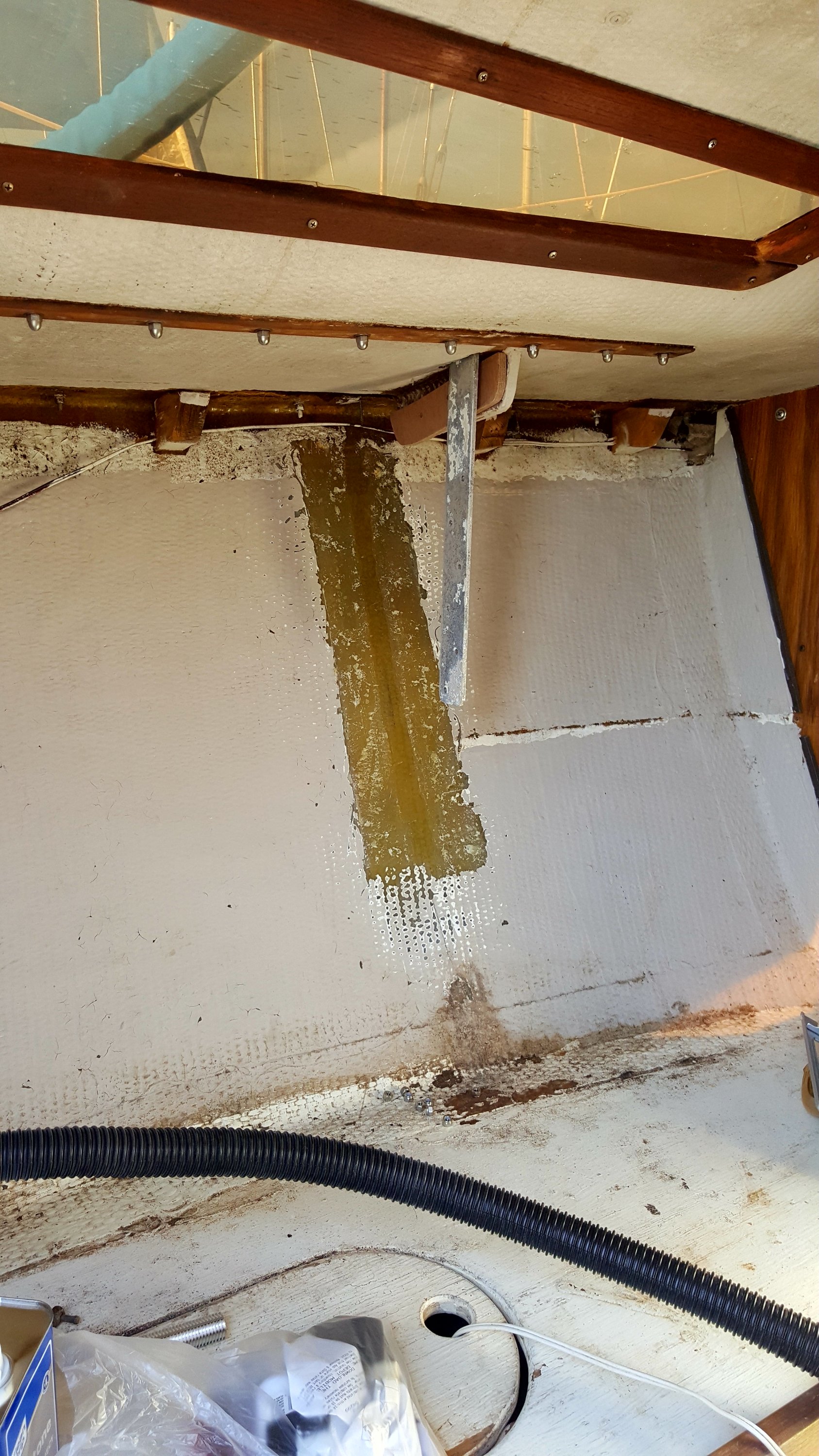

Bulkhead replacement and core repair at the chain plates. Much improved over the original!

@Thedillo you have completed some nice work on your boat.

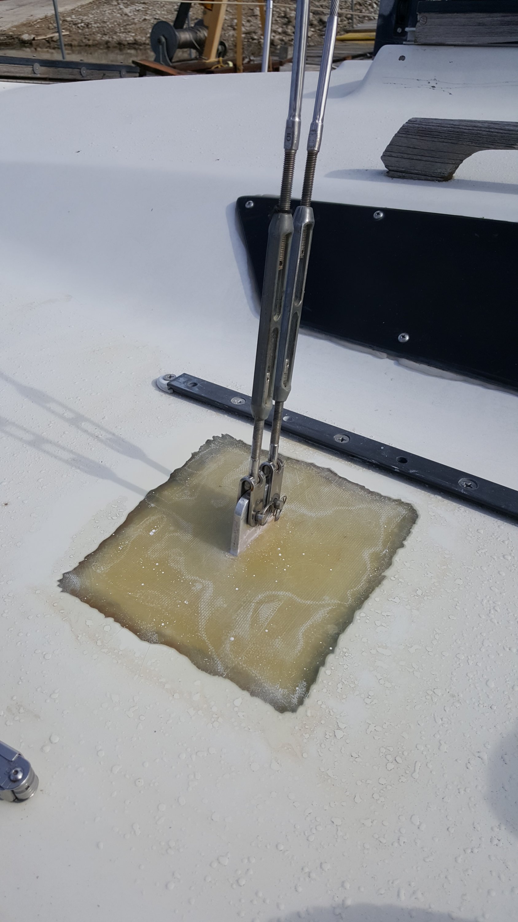

I noticed the chainplate repair. It appears that some water managed to slip under the surface and get into the wood core where the plate goes through the deck. Is that correct?

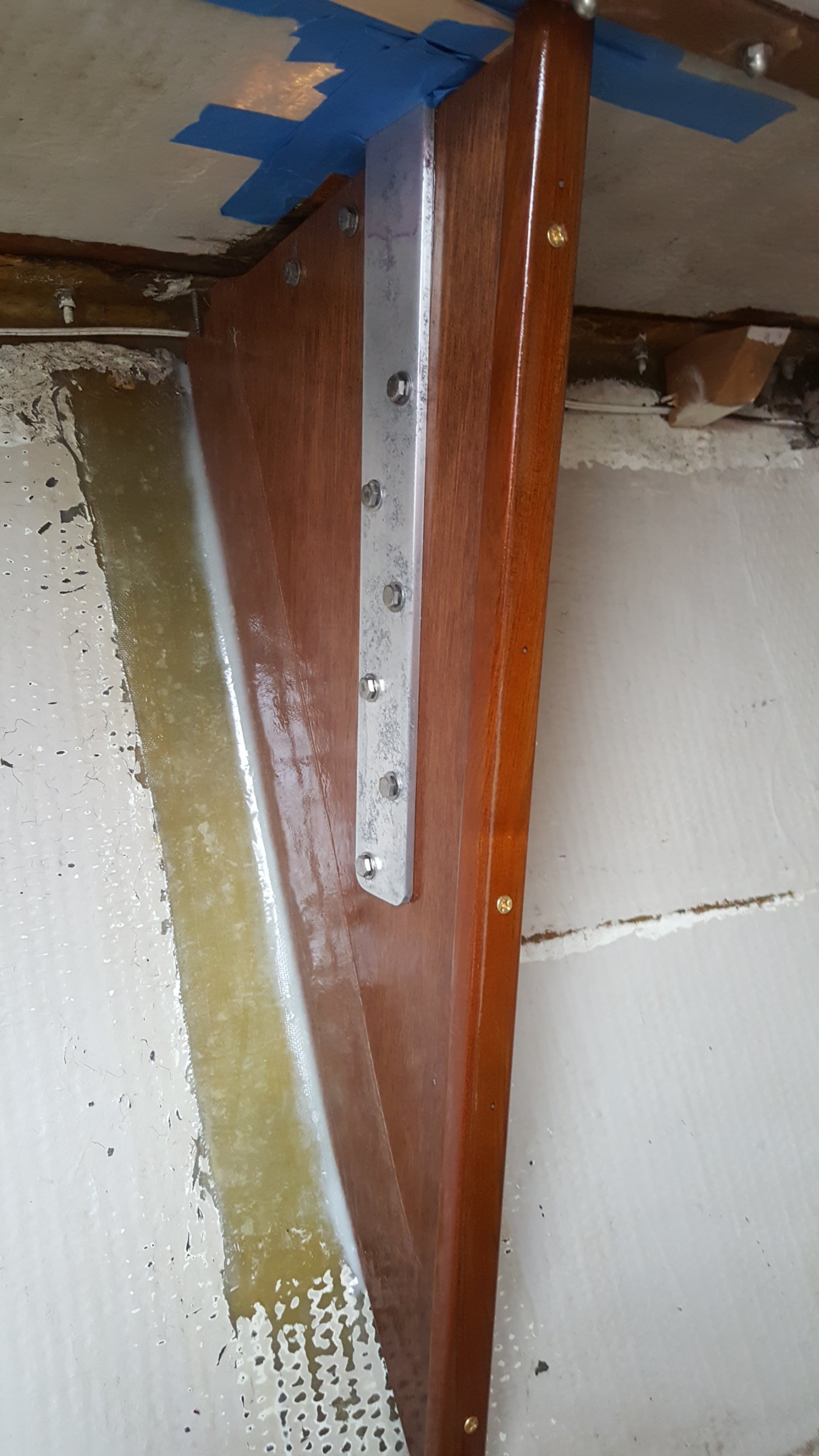

If so you were right to repair it. Your image looks as you fiberglassed the chainplate into the deck to seal it. If so this will give you a problem. Chainplates are meant to go through the deck. Their attachment point is to a strong point attached to the hull. Your very nice new wood bulkhead. The bulkhead should be secured to the hull with fiberglass tabbing.

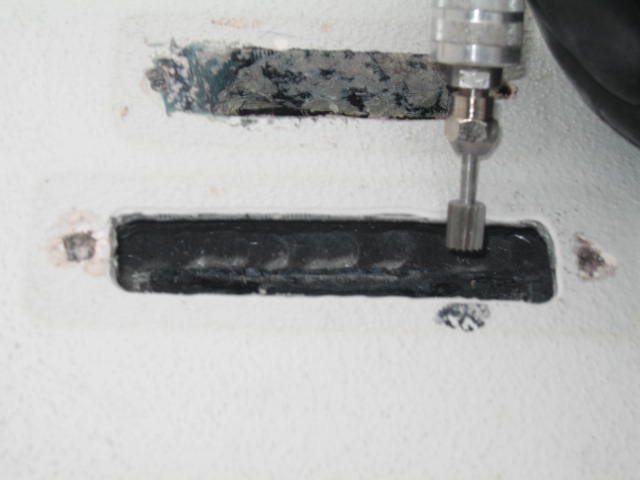

The point where the chainplate goes through the hull can be sealed with a watertight caulk or butyl caulk. Often a chainplate cap is used to dress up this sealed space. The purpose is for the chainplate to pull against the bulkhead not the deck. If the chainplate pulls against the fiberglass deck it will flex and crack the deck where you made your repairs.
A second issue is that the chainplates need to be inspected for pitting corrosion occasionally. If not careful the chainplate will corrode from the inside and suddenly fail. As in such cases will likely happen at an inappropriate time when your enjoying a rail buried sail.

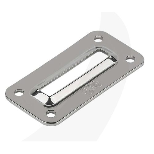

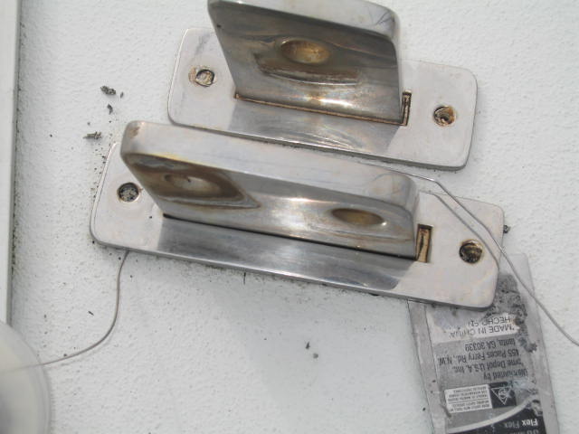

Here is an image of a chainplate cover
Here is a link to MsineSail’s great info on how to caulk the chainplate with butyl.
http://www.pbase.com/mainecruising/rebedding_hardware
Here are a couple images of a chainplate cap and beveled space under the cap that gets the butyl or caulking to seal the chainplate. D50DA316-073A-4605-924F-D7905FE522DB.jpeg

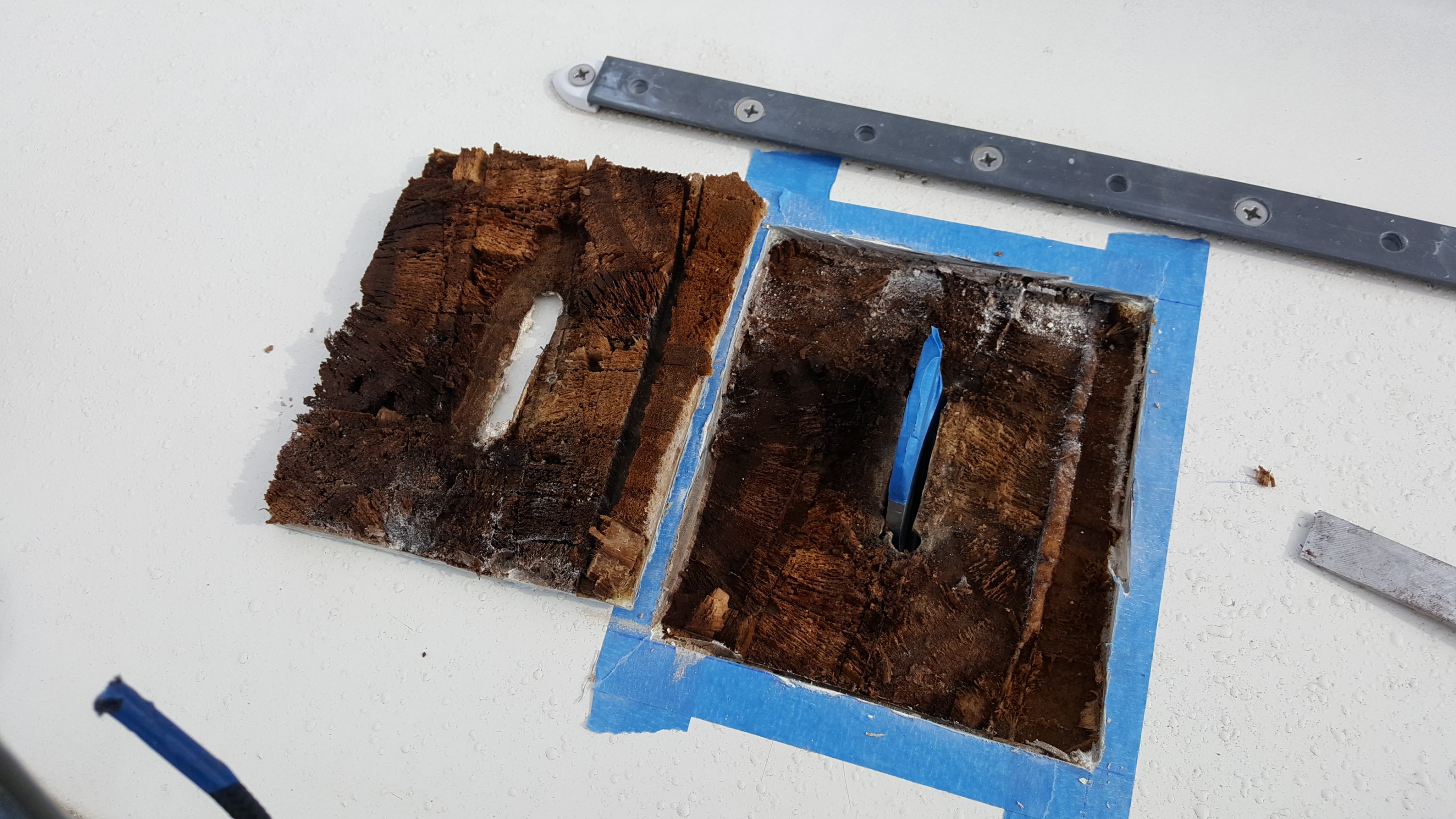

The bulkhead was not installed properly from the factory causing it to fail by pulling away from the hull and started to push up on the deck causing cracks and water to leak in.
During construction the the bulkhead was installed in the wrong place resulting in a very large hole with no core where the chain plate went through the deck. PO tried to fix this problem by injection 5200 into the void. A pain to remove! Both the inner and outer layers of fiberglass were horribly damaged and the inside layer was paper thin. I had to install the chain plate during re-coring the deck to insure proper placement.
I coated the chainplate with PVA allowing me to remove it to finish the repair. The hole will be routed out and beveled to allow byutal to be installed to prevent water intrusion. Due to current temps/weather that project is on hold for now. What remains is making a mold of the non-skid for gelcoating the area to match and reinstalling the chain plate and cap. I do plan to replace the aluminum chain plate with stainless due to pitting.
The bulkhead was coated with epoxy, filleted and tabbed to the hull with layers of chop mat and 6 oz biaxial cloth. It appears to be a very solid repair and should last a very long time. I will be redoing the other bulkhead after the current project is complete. This one should go much better as there is no major damage to deal with.
That's life with an old boat!
