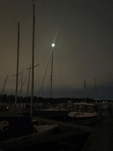

MarineBeam also doest say anything about this. But try sending orders of magnitude brighter than my old aqua signals
Marinebean DOES state that their LED switching 360/tricolor bulb has been tested by Bureau Veritas and meets horizontal AND vertical angle requirements. A little homebrew triangle testing with confirms, you could see this baby from SPACE.
