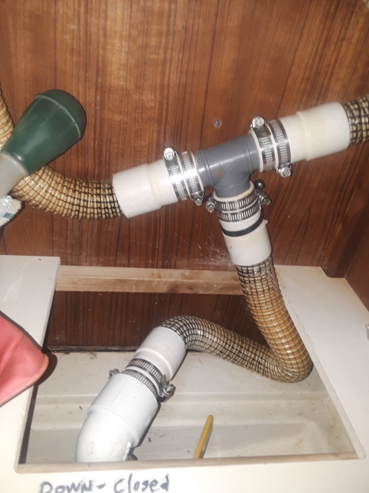

This is what my sink drains looked like originally. Not only were they cracked, they trapped junk in those loops. I replaced the PVC ell on the thru hull with bronze and connected some left over Saniflex from it to above the waterline where the new plumbing joined. I used PVC from the sinks to the join, All above the waterline. I still need to take pics of the "after" for my records
Likes: swshogren

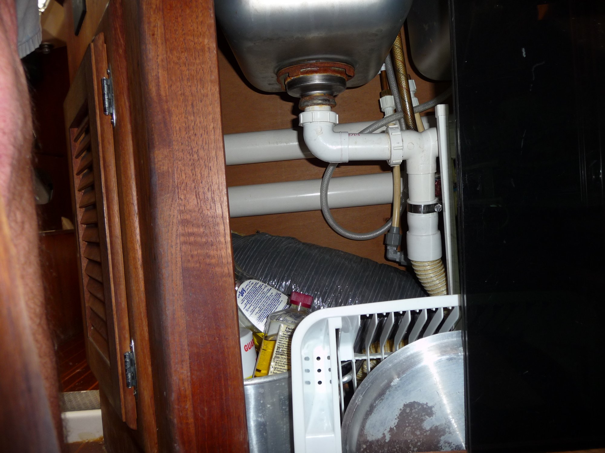

I just did mine with butyl rubber ($13/ft) sanitation hose and was able to put a Y in instead of the T. I got all my shelving back, easier access to thru hull, and a clear drain path, sink drains well, I never worry about the sink hose anymore. Still inspect though...
