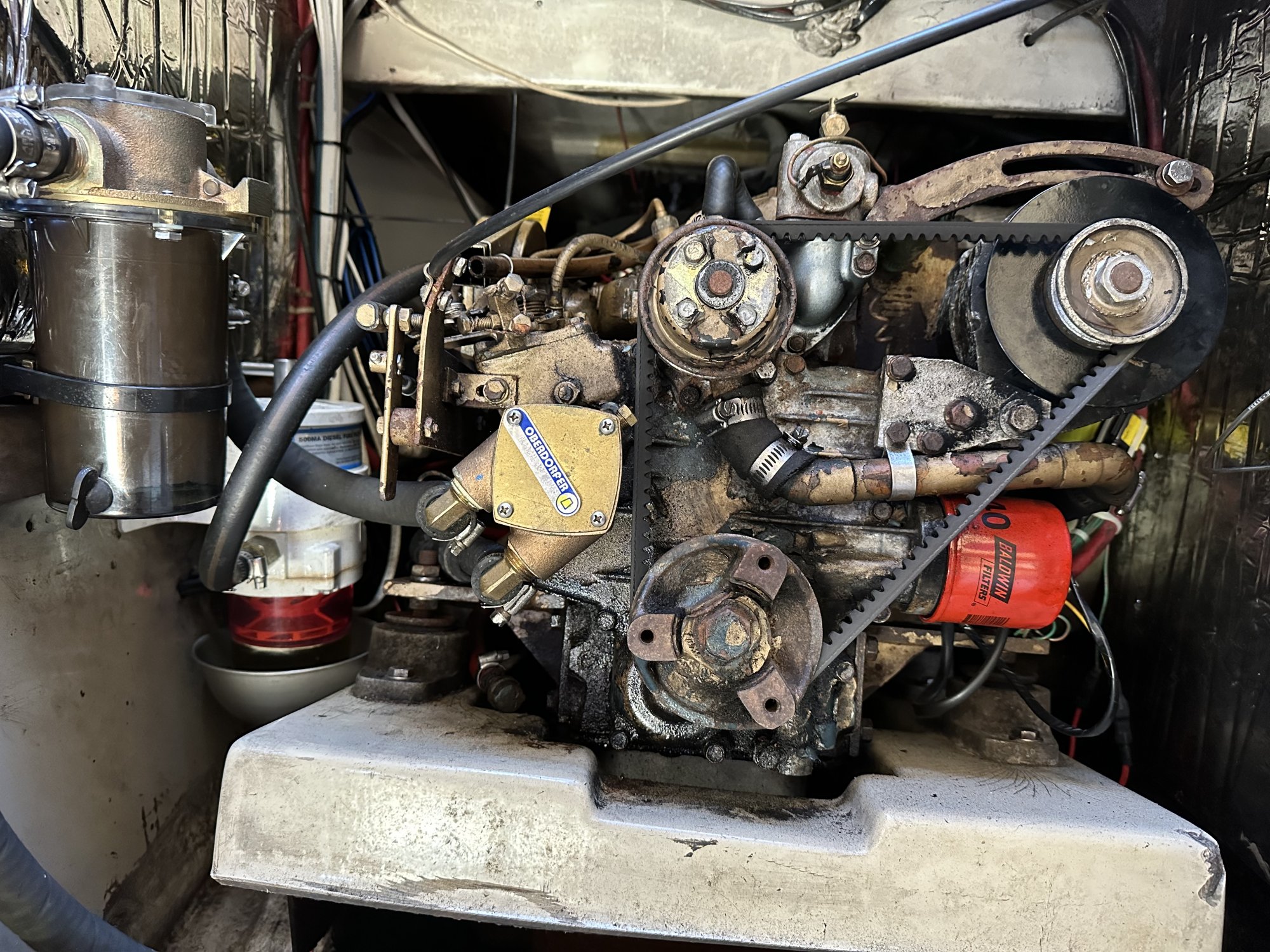

I have a 1984 Universal diesel M-12 inboard motor on my 1984 O'day 28. I have the replacement impeller (part # 302875). I'm looking for the short hose that I will replace when I do the impeller. I have the Oderdorfer pump # 301357. The hose might be 301076 but I'm looking for help to confirm this and also need to know where I can purchase this hose

I think your part number 301076 goes to the coolant pump.
Since you are talking impeller I assume you are refering to a hose on the raw water pump. Is that right? If so then maybe the hose from the raw water pump to the heat exchanger? In case maybe it is 301066?
Do you have an in place photo of the hose you are looking for?
24,938
Randall without adding where the pump hose goes to (raw water intake or pump to exhaust) we are left to guess.
If it is the Hardwall 1/2 inch hose imaged by @Richard19068 then your local truck or auto shop can supply a Hardwall 1/2” id 22” long hose. Just take the one from the engine to the shop and ask for a match to replace it.

I took a photo and now recall the tiny hose was for the fresh water pump not the sea water one. It looks l should be able to replace the impeller on the Oderdorfer by remove the facing screws and the face plate. Should be simple. Will also change oil and filter using a hand pump to withdraw oil. Maybe change fuel filter too?
