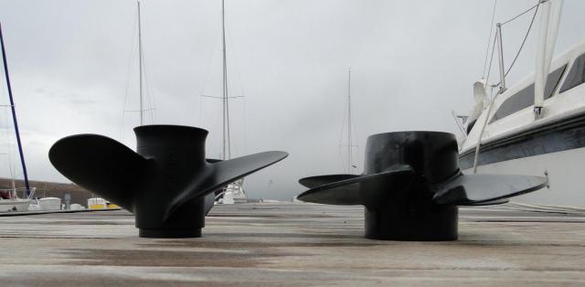

Ive never used a big foot on a sailboat - but I dd buy a 9.8 Nissan XL shaft electric start late last winter and I think its completely adequate for the sailboat application (in my case, a 1990 Mac 26S).
What I wanted to point out is my experience with a couple different props. The Nissan XL shaft 9.8 comes standard with a four blade 5 pitch prop. 5 pitch means the prop will turn faster for a given thrust than a higher pitch prop will - and can allow higher rpm's and hence higher horse power output. What this prop did REALLY well was maneuver when your coming into a dock. I could put the outboard in reverse, apply lots of throttle and pretty much immediately stop the boat. In the picture, you can see that the blades on the 4 blade prop are symmetrical - ie, they work pretty much the same in forward or reverse.
However.. if I was motoring for any distance at all at a reasonable speed (not really pushing things at all), the five pitch prop required fairly high RPM and both the noise and vibration go way up.
After a few weeks using the 5 pitch 4 blade prop, I got tired of the noise and vibration and tried a more conventional 3 blade 8.5 pitch prop. The first thing I noticed about this prop is that it works MUCH worse in reverse than the 4 blade 5 pitch did - and you can see that the "angle of attack profile" of this prop is much different between forward and reverse. It almost feels like its cavitating in reverse compared to the symmetrical four blade prop. The three blade prop blade shape is optimized for the forward direction - and apparently is somewhat poor in the reverse direction. The three blade prop still "works fine" in the reverse direction, just very noticeably worse than the symmetrical four blade prop.
The three blade 8.5 pitch blade is in my opinion way nicer if your motoring for any distance as it efficiency works at a lower rpm - less noise, less vibration, probably better gas mileage. Ive ended up preferring the three blade 8.5 pitch prop because its just way more pleasant for any sort of motoring with the boat. But the reverse stop of the four blade prop sure was nice if coming into the dock on a windy day.
Anyhow, I don't think you really need the big foot - you can do all the "adjusting" you need just by changing prop styles with the standard outboard.
