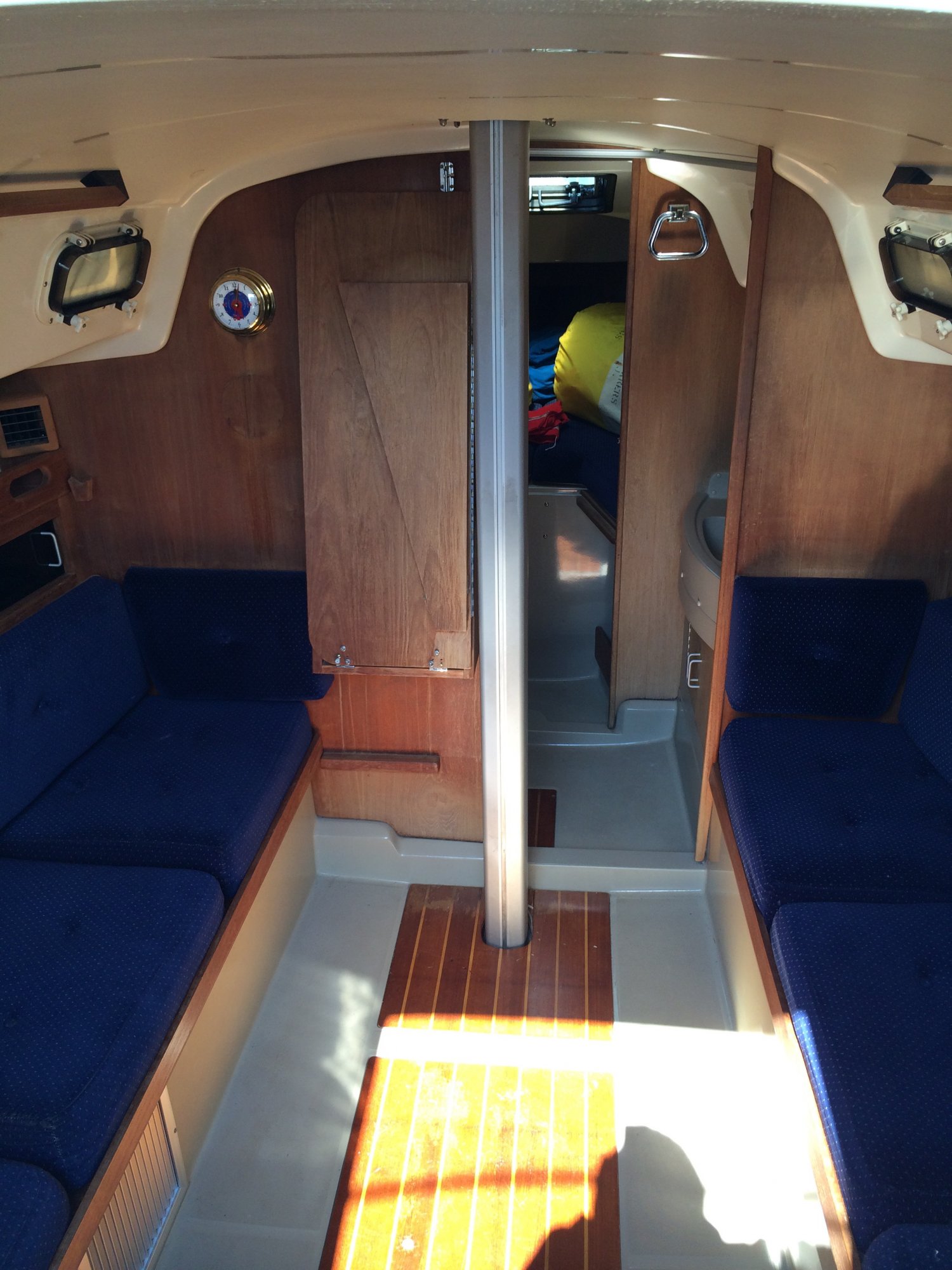

Well, I purchased the sheet of teak & holly plywood, made the cuts and finished the flooring. It fits like a glove within the fiberglass floor pan where it goes. The original was tacked down with wood screws and the heads were concealed with teak plugs. I think I would like to avoid dealing with the plugs and am considering using some adhesive to secure the plywood to the fiberglass,
I don't want to use a contact cement because I'm afraid that it would be too unforgiving with the initial placement. My thought is to use 4200 around the perimeter and at the perimeter of bilge cut-outs to seal the edges and just apply spots of 4200 to tack it down. I would set some heavy weights over the flooring for 24 hours to let it set. The recessed pan of the fiberglass base holds the flooring from shifting and my fit is very good. I am most concerned about future lifting. What do you all think?
This is a loose fit with the old bilge covers in place. It was almost perfect at this point. I took it home and sanded the edges for the final fit. Now it's finished and ready to install!
