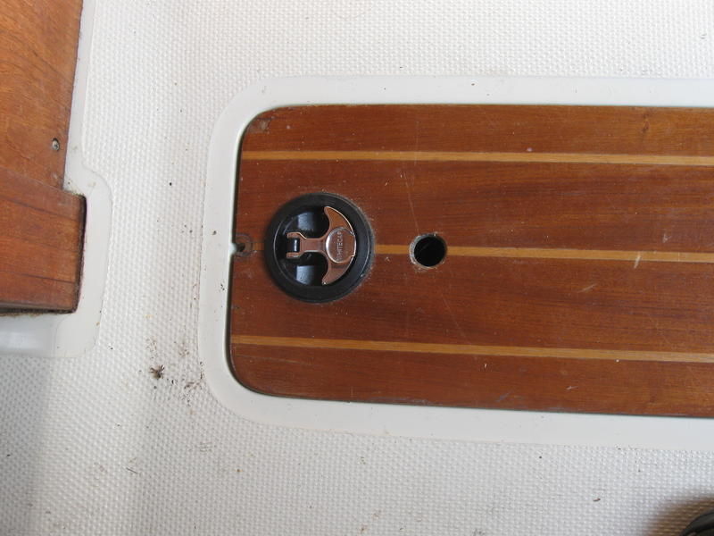

I have a 86 Cat 27 that had the same problem. There are 4 screws that hold down the bilge cover. Some were stripped out and were a pain to remove. I made and attached a wooden 'L' bracket under the aft side of the cover. On the fore side I got one of those quarter turn hatch locks with a T handle that folds down flush. They have an adjustable bracket underneath to engage the lip of the floor. This way the cover is held firmly in place by a simple twist of the cover lock and sliding it forward removes the bilge cover. I would attach a picture but I don't have one. I could take one today and reply if you wish.

Ah thats exactly what I was thinking about!!!...pic not necessary but would be a bonus if you could get one! Thanks so much Joe.

Interesting way to hold it, but the first picture suggests you might have it front to back, the hole looks a lot like the hole for the foot pin of the drop down table leg which on my boat is more to the front.

Hmmm not sure about that...the hole on my bilge cover for the table pin is on the port side about halfway back, not in the center of the board.

The small hole behind of the twist lock was always there. It was a finger hold to lift the cover after removing the screws. Table leg never comes close to the hole no matter what and has a plain bottom. My table comes down and rests half on the bilge cover and half on the floor.
