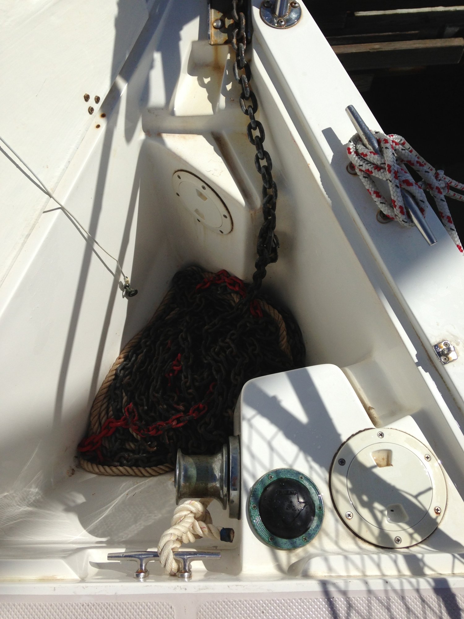

Any suggestions on how to secure anchor / anchor chain in our C310 anchor locker?
At present I wrap couple turns around drum then slide chain link around each horn
of cleat at stern side of locker and hold with light cord with slip knot.

At present I wrap couple turns around drum then slide chain link around each horn of cleat at stern side of locker and hold with light cord with slip knot.
I do the exact same thing.

I use a turn around the windlass and lock a link on the cleat horn then behind the other horn to lock it in. I have a short line from the cleat with stainless carabiner that fits through a link of chain forward of the windlass as backup. I also tie a line between the two bow pulpit stanchions with a dead turn through the anchor eye (Rocna 15 kg). If you ever were sailing along on a reach at six knots and suddenly heard anchor chain paying out through the roller in big seas under full sail when exiting the tunnel in Chesapeake bay and wondered if you can turn up into the wind before the anchor sets and rips the dead end cleat out of the anchor locker you learn to go belt and suspenders so it never happens again.

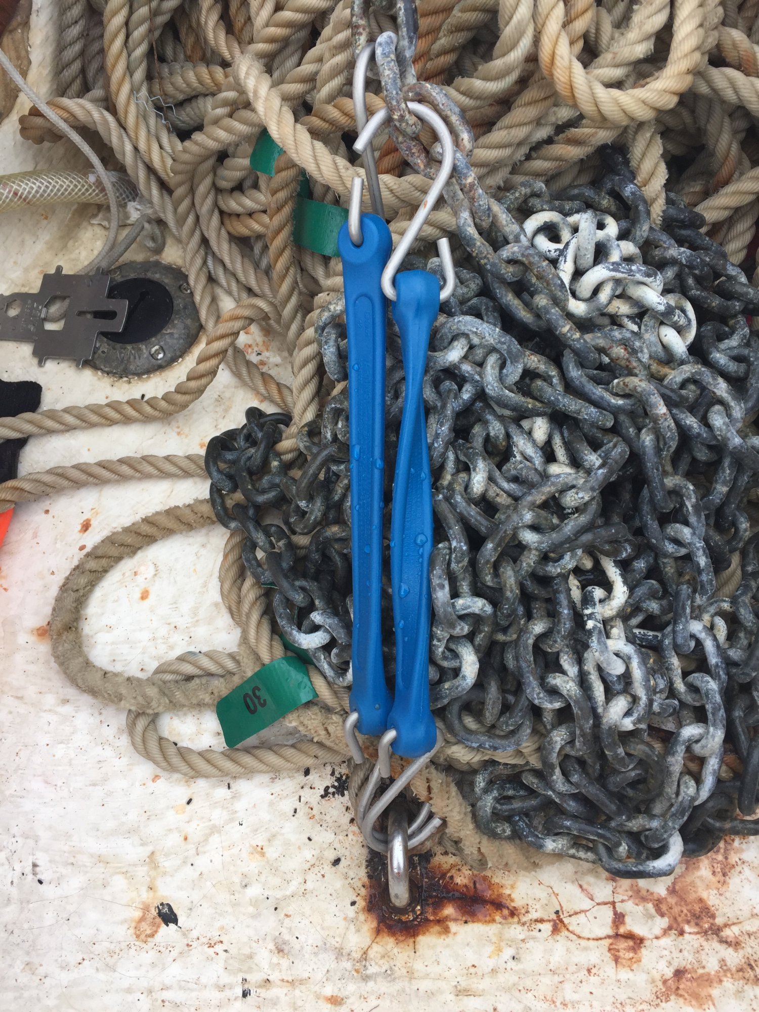

Two quality bungy cords. Buy the solid rubber with stainless hooks versions. Hook one end in the chain with a little stretch and the other end to a U bolt at the rear of the anchor locker that is probably already there for the bitter end of your anchor rode. These will be totally within the locker. No real risk of failure with two in parallel. Will keep anchor snug against the roller without rattle. Take a few seconds to manually connect or disconnect.
