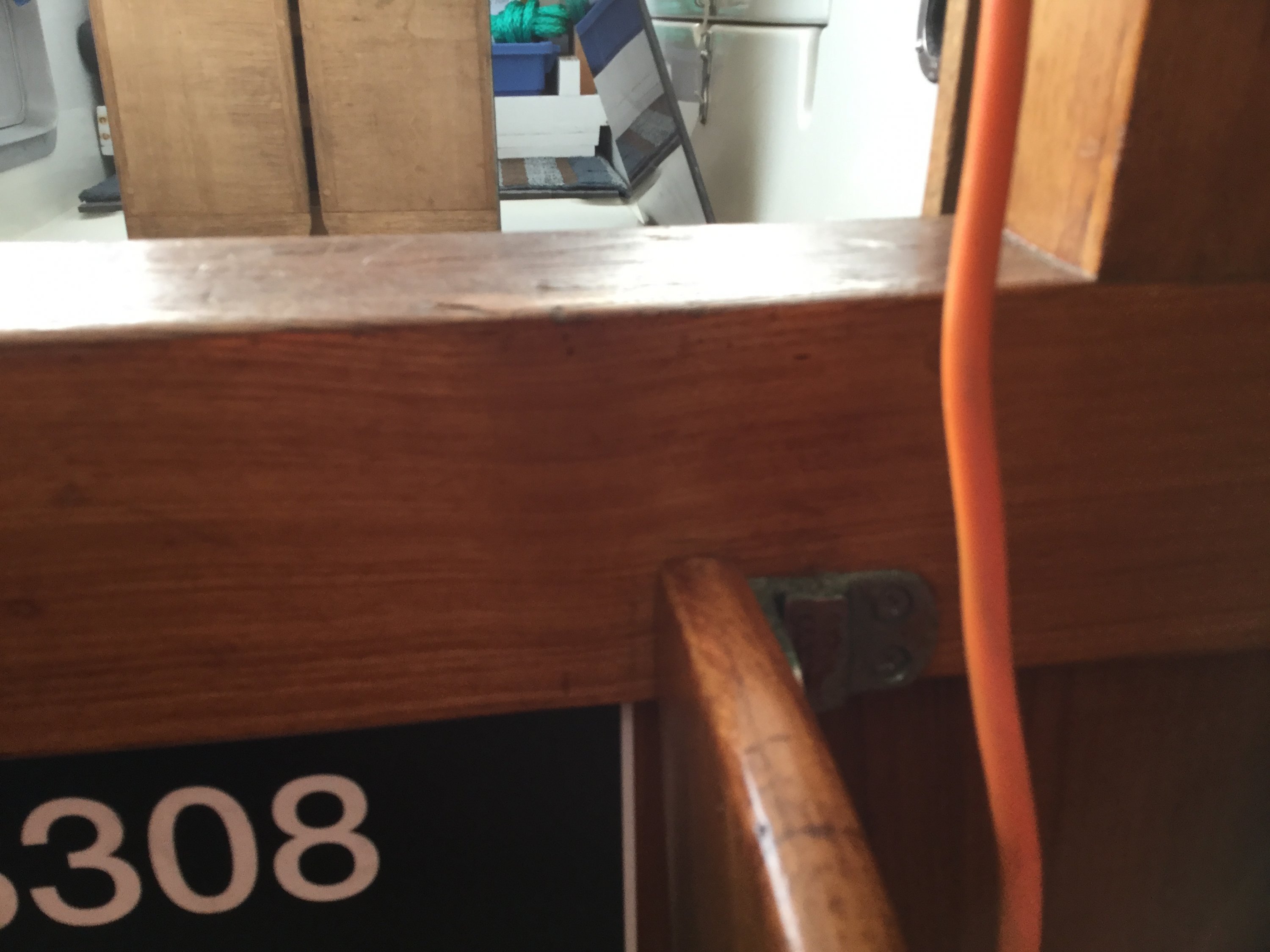

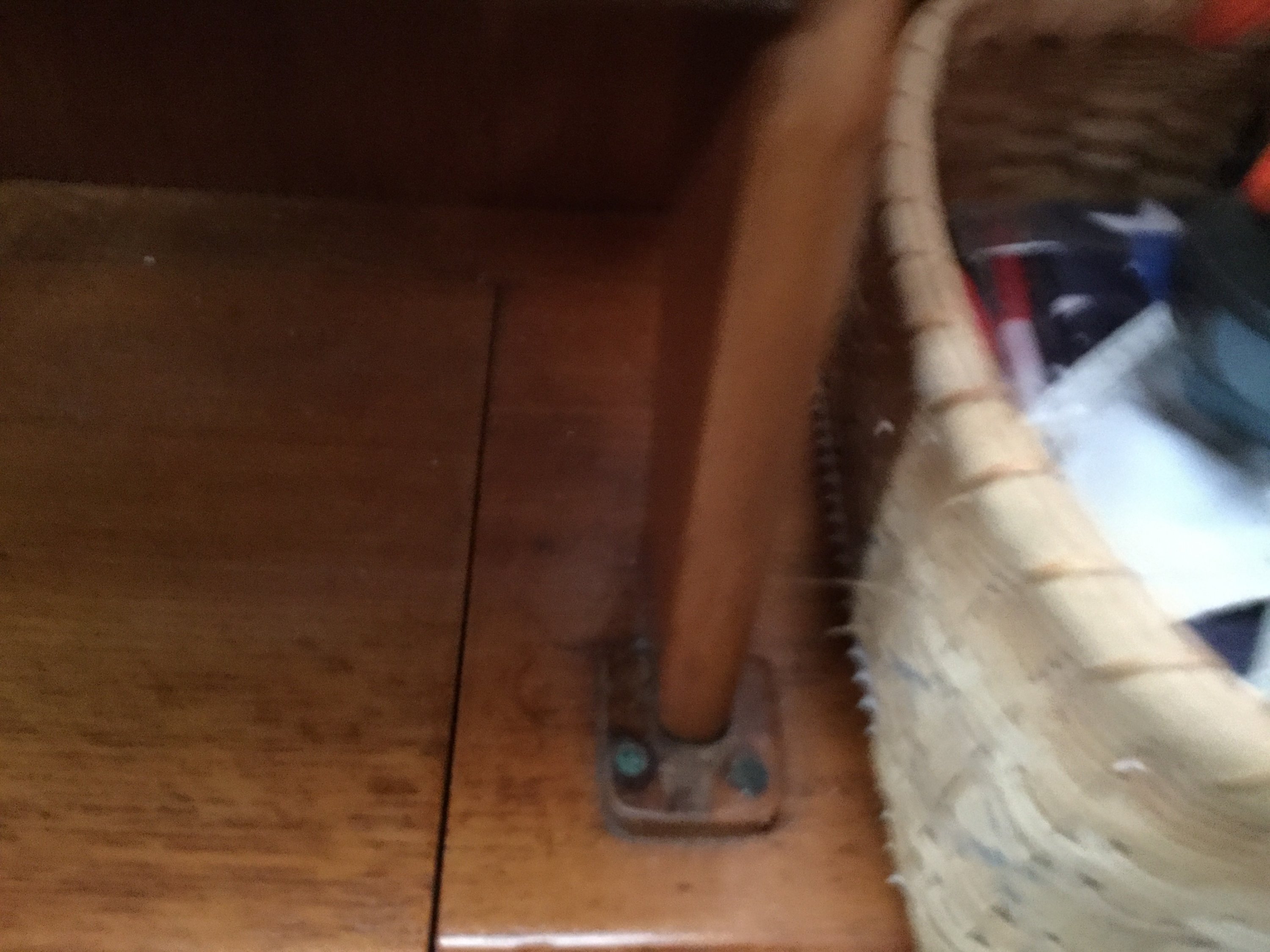

IMG_0343.JPG Ours fits tight into a teak stop at the foot of the ladder.
