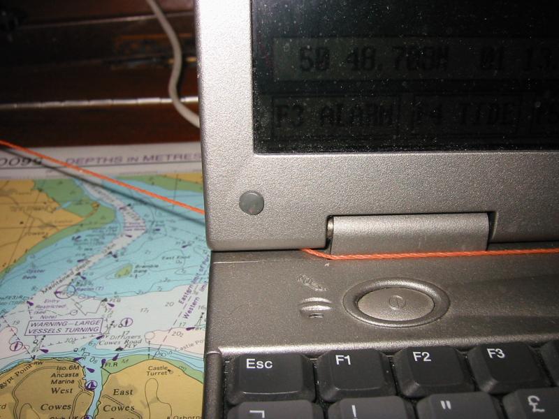

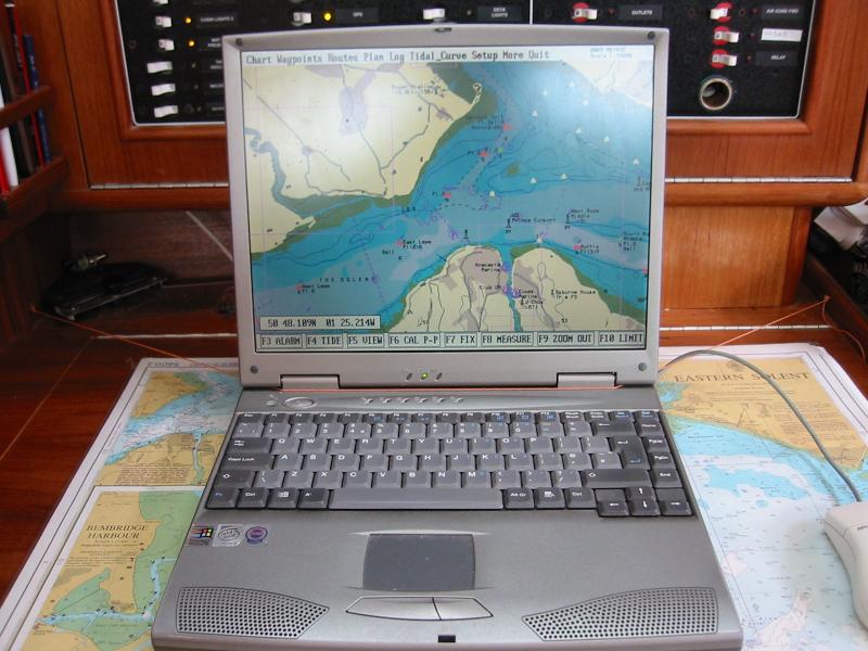

For years I have just had a small SS screw into either side of the upstand on my nav table. A short length of the orange polypropylene line the kids use for crabbing, tied off on the left side and with a slip loop on the other end.
Just put the laptop on the nav table and pull this line across the hinge between screen and keyboard and fasten the loop over the other screwhead on the RHS.
Over a decade my laptops haven't moved an inch.
Make sure you put the appropriate chart under the laptop first just in case the cigar lighter plug on the laptop power brick becomes disconnected and the laptop switches off!
See Photos
