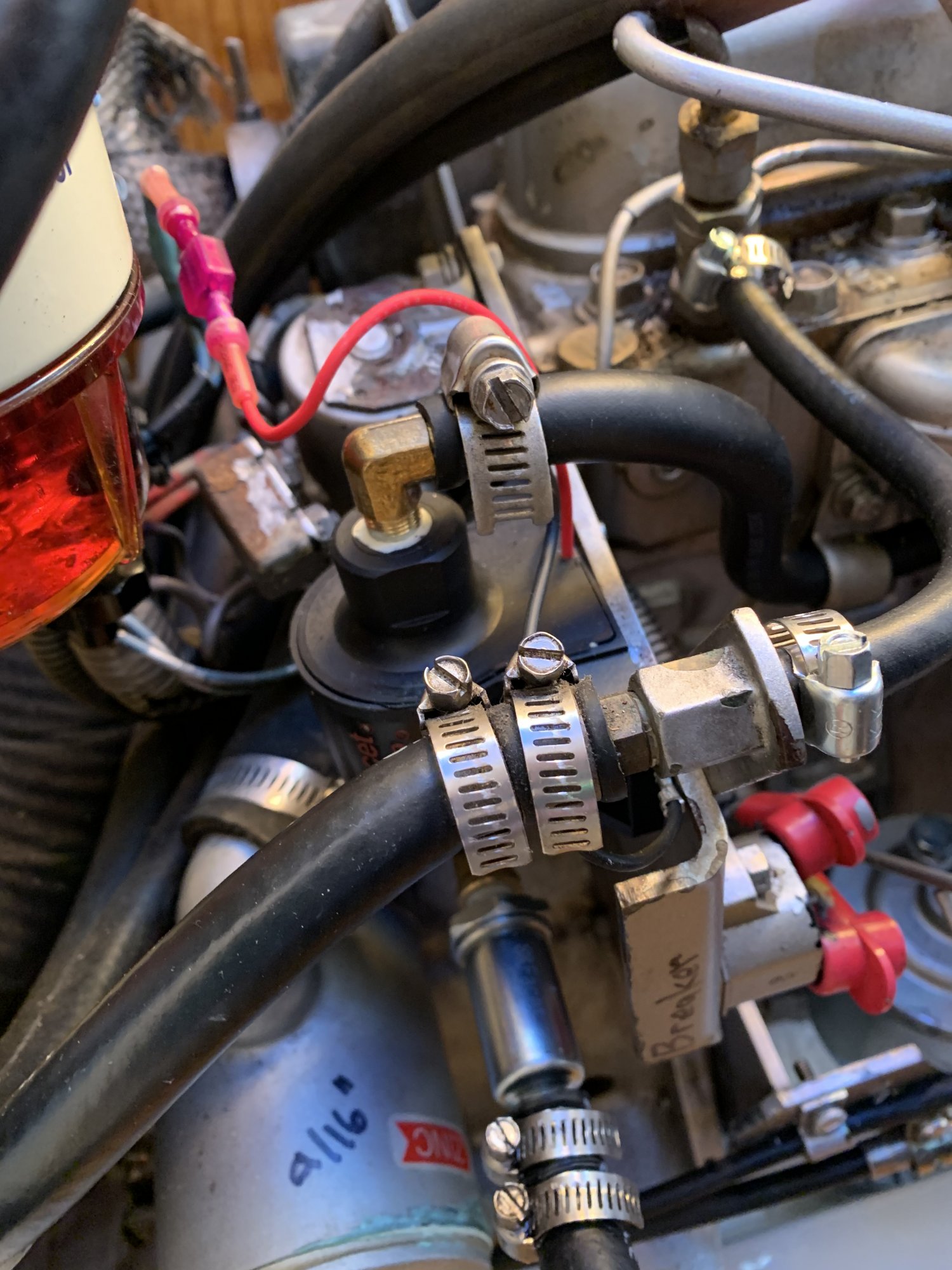

When I installed a new fuel pump on our M25XPB I used a spade connector on the hot side. I can unplug it and hold it against the hot stud on the breaker by the pump to manually run the pump (red cover at bottom right of photo).
