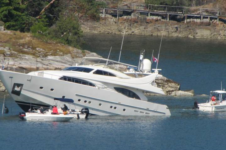

The consensus in this forum seems to be that a second bilge pump should have its own discharge hole; one not shared with the pump already installed. There is somewhat less consensus as to the viability of a second pump depending on what you wish, or expect, it to do, e.g., keep the boat from sinking or do something less demanding. The question of a "high water" alarm has come up, but again--to what function other than to alert you that the lower bilge pump is not keeping up with the ingress of water. My bilge alarm is set very near the level of my centrifugal (impeller) pump, and there is no other electric bilge pump. There is a manual (diaphragm) one operated from the cockpit that also drains the bilge. It's also been noted that the rated discharge capacities of the centrifugal pumps are very misleading in that they do not consider the height that water must be raised for discharge, which affects the actual discharge rate, significantly so. A pump(s) that cannot actually move 3000 gal/hr out of the boat (50 gal/min) probably cannot save it if there is significant ingress. For example, a 1.5-inch-diameter hole one ft below your water line will admit about 44 gal/min of seawater. So, if your two pumps together cannot match that through separate discharge ports, then you may end up hearing your alarm, but also finding little that you can do about it, in the worst cases, except to get the raft ready to deploy!!:yikes::yikes:
I followed this boat into Pender Harbour and took this picture and.... the water and was coming in over the transom also when I took the picture.
Pender Harbour had one emergency pump and had it working in minutes and the Canadian Coast Guard brought in another pump by fast boat in less then 1 hour.
This is the follow up
http://bc.ctvnews.ca/multi-million-dollar-yacht-runs-aground-on-sunshine-coast-1.3014099
Just another story.
