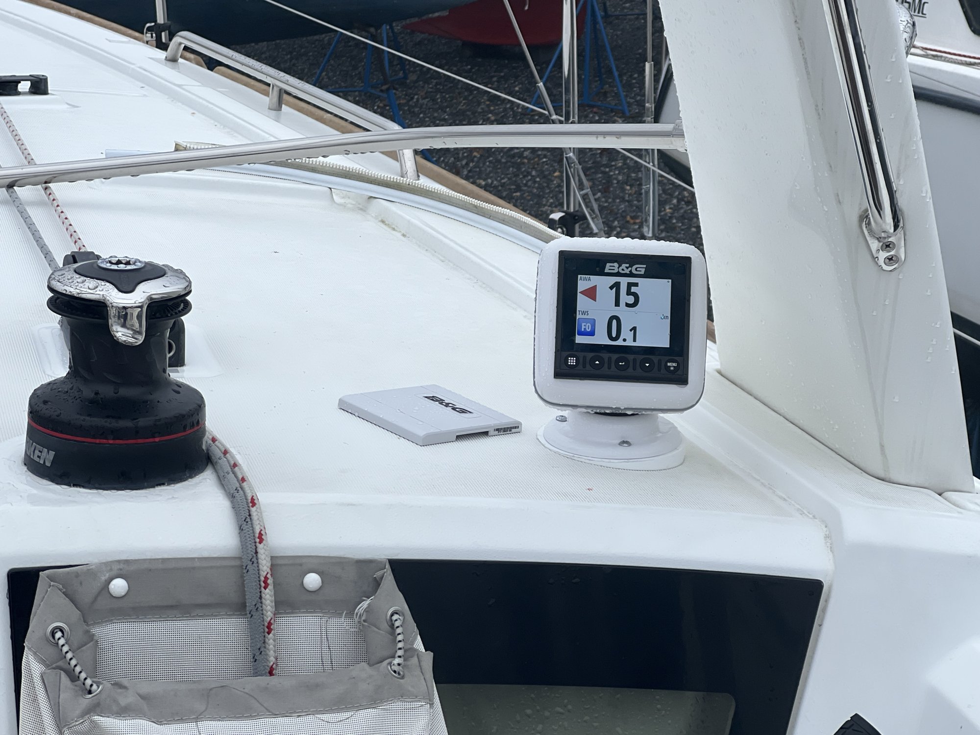

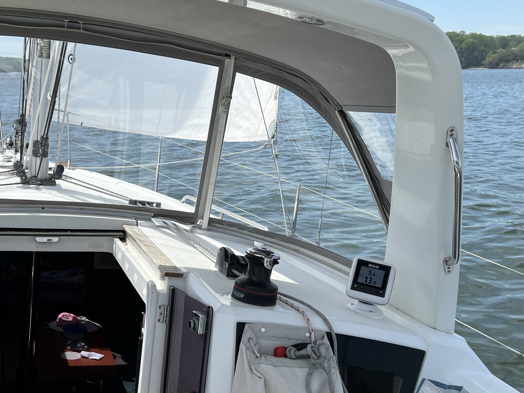

My 35.1 has the standard setup: Zeus3 to starboard and Triton2 to port. There have been several times when a crew was forward in the cockpit, or when I solo forward in the cockpit, and needed to know some data. Either ask someone at a helm, or go back to a helm.
So I’m thinking of installing a second Triton2 on the coach roof, to starboard. Anyone done that, or other add on for similar reasons?

I have 2 tritobs above the companionway, one with wind info, the 2nd boat and water data. Eazy peazy, just connect into the nmea backbone. Done
Mar 20, 2016
595
Beneteau 351 WYC Whitby
I installed a veratron go data , nmea 2000, low level bluetooth cheap 120 bucks . download the app from app store . This transmitts all nema data to cell phone or tablet . I have tablet at nav desk and to my phone no wiring or installation required just plug into backbone anywhere on boat and hide it. There's a good video on youtube about it
12,912
Yes, we have 2 Triton 2 displays. Very easy, add a drop T to the network, connect the drop line to the T and to the display. You're good to go.

BTW, the thing holding the Triton2 is a Navpod PP4102. They also make other size/shape pods for different instruments.
