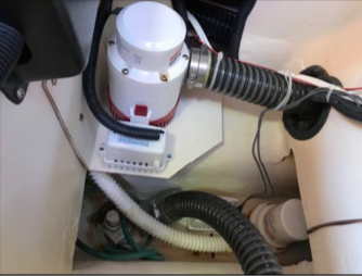

has anyone added a second bilge pump? Where? The bilge is very shallow but it seems a bit underwhelming to have only one pump. I have never spent a lot of money for pumps, only typical Attwood, Rule, etc. I know that there are some high end pumps that I have seen on charter boats. Maybe I am just a little paranoid since the eye of a hurricane is passing over my boat at Bald Head Island as I write this.

Good plan if you have room!! My sailboat has 2 electric bilge pumps: Primary RULE 1500 w/ Rule-A-Matic float switch and Secondary RULE 4000 w/ Rule-A-Matic float switch, wired to bilge water alarm.

You can use a remote, self priming pump that can be mounted conveniently and only has a pick-up and switch in the bilge.

Two bilge pumps is a prudent choice in my opinion. My primary bilge pump is on a digital cycle counter so it can’t mask a minor problem until it becomes a bigger one. The secondary pump is on an alarm. Both have fused connections direct to separate batteries.
I also have two manual hand pumps for emergencies. Thankfully have never needed them.
