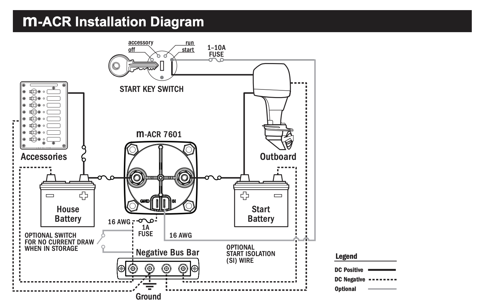

I like the idea of the ACR. Was referring to this diagram from Blue Sea Systems. Not sure where the current feed to the distribution panel is located right now, though. Obviously this is showing an outboard motor and the existing switch is not shown but you get the idea.

That diagram is pretty much the right idea. The group 24 you have is better suited for the engine than house loads, so you’d probably want a larger true deep cycle battery for the house. Make up an energy budget and see how many amp hours you’ll routinely need, then roughly double that to find the minimum battery size you’ll want.

I bought the Add-a-Battery kit and I have a solid plan to wire everything up. The ACR has a connection for a start/isolation wire that will temporarily disconnect the starter and house batteries when starting, thereby eliminating voltage sags on the house battery that would cause my electronics to reboot.
I believe this start/isolation wire gets connected to the start relay on the wiring harness behind the control panel. Of course, I have no idea which relay and where to connect the wire. Does anyone know the answer to this question?

it attaches to the wire that activates the solenoid on the starter. When current is applied to this wire it activates the disconnect on the ACR, once the engine starts and the starter is disengaged, the ACR resumes normal functioning. Without knowing what kind of engine is in the boat and how the starting circuit is wired, it is difficult for anyone to be more specific and the place to connect the starter interrupt wiring.

The feature of the ACR that @Souellette is inquiring about disables the ACR while starting. What can happen while starting is the start battery voltage drops quite a bit, the ACR sees this as the battery needing charging and allows a high discharge rate from the house bank. In a smallish house bank this can cause a significant drop in the house bank voltage which causes problems with electronics. Once the starter stops, there can be a voltage spike which can also cause havoc with the electronics.

The ACR could be closed before starting the engine if another charge source like shore power or solar are charging or floating the batteries. A common ACR profile is to open when the voltage drops below 12.75V for 30 seconds or 12.35V for 10 seconds. So if you’re, for example, charging with solar and floating at 13.3V, then start the engine, the short duration voltage sag could bring the house down enough to reboot electronics before the ACR would open. The Start Interrupt prevents the house bank from sagging in that situation.
