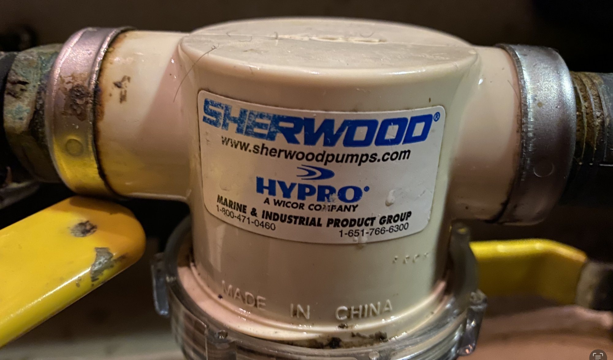

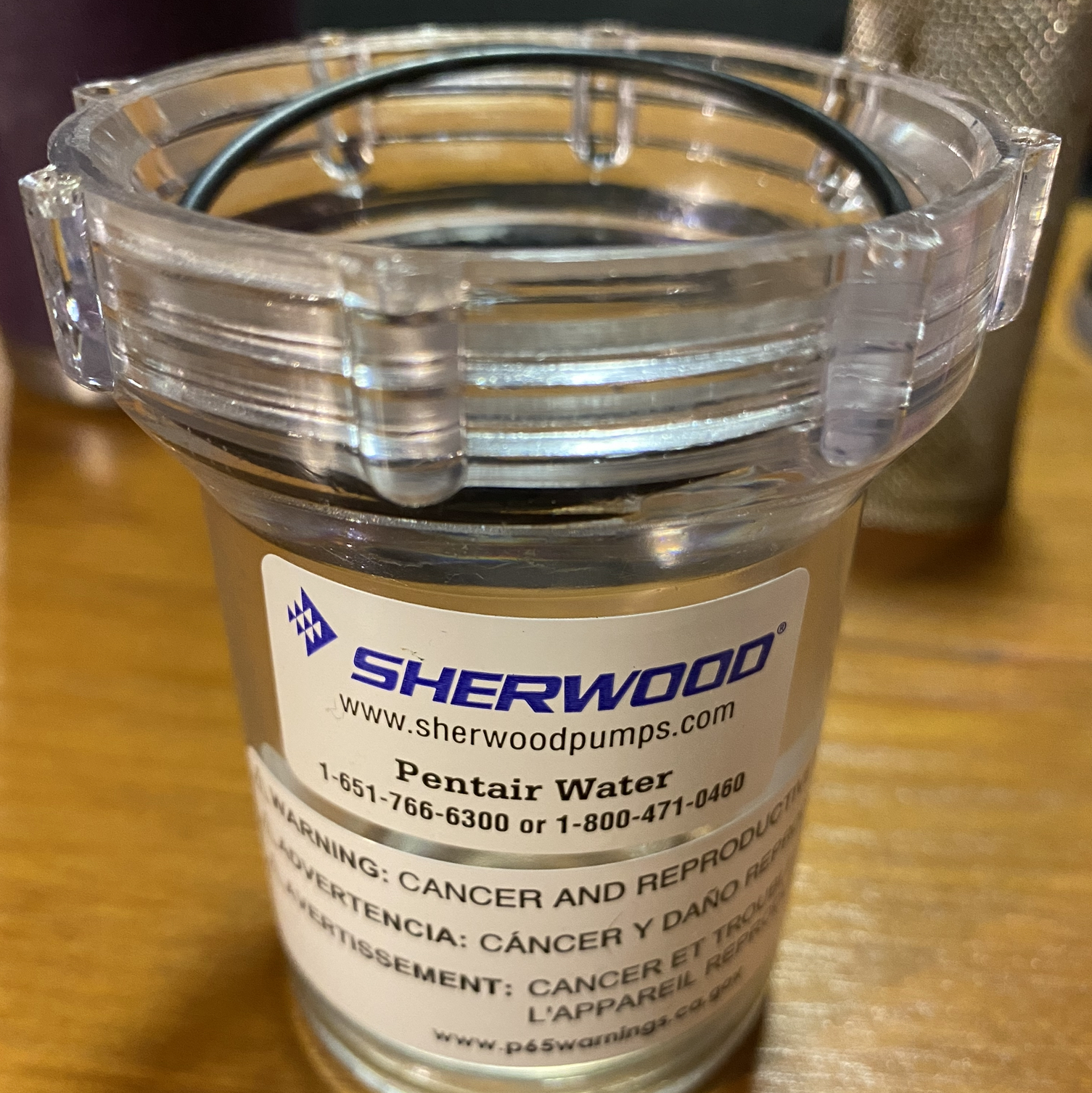

I’m have a really hard time locating a seawater strainer o-ring on my Hunter 33. I saw the old thread - “Donations to Neptune” which is exactly what happened to me. I even contacted the OEM - Sherwood who gave me a part number - 11803 however when they arrived, they are easily 1-inch diameter too big. The strainer itself has no part number on it!?? The o-ring appears to be 2-1/4” diameter which according to Sherwood, work for both the 3/4” and 1/2” intakes. Has anyone encounter this and can point me in the right direction?

Be careful with that O Ring. On my Sherwood Strainer the “O” Ring is a flat ring, top and bottom and sides, not round like your picturing it. Do you remember which style you had before it went overboard? Round may not seal the bowl properly.

Yeah it was the one above that went overboard. It was indeed round and seemed to seal fine.

I might be totally wrong about this but I think this is what you need. If you go to the website you can expand the picture and see the flat type ring they use on the size you are describing. Worth checking out.
Sherwood 11805 O-Ring Gasket

Here is an illustrated guide to standard o-rings. Find the number of the o-ring that you need and go to a decent hardware store or industrial supply and ask for that number.
Wow…what a great guide. I think this will help!

Thank you. I will check that our as I see you can cross-reference strainer dimensions to try and figure out the model too.

Take it with you to ACE Hardware. Most of their stores have a good selection of O rings. I know Sherwood's are square, but I put a round one in in 1999 and it's still working just fine.

A lot of equipment manfactured recently has metric dimensions so it is entirely possible (even likely) that the O-ring is metric dimensioned. Unlike Imperial dimensioned O-rings (which go by the O.D. and cross section diameter), metric O-rings go by the I.D. and cross section diameter (in millimeters, of course).
