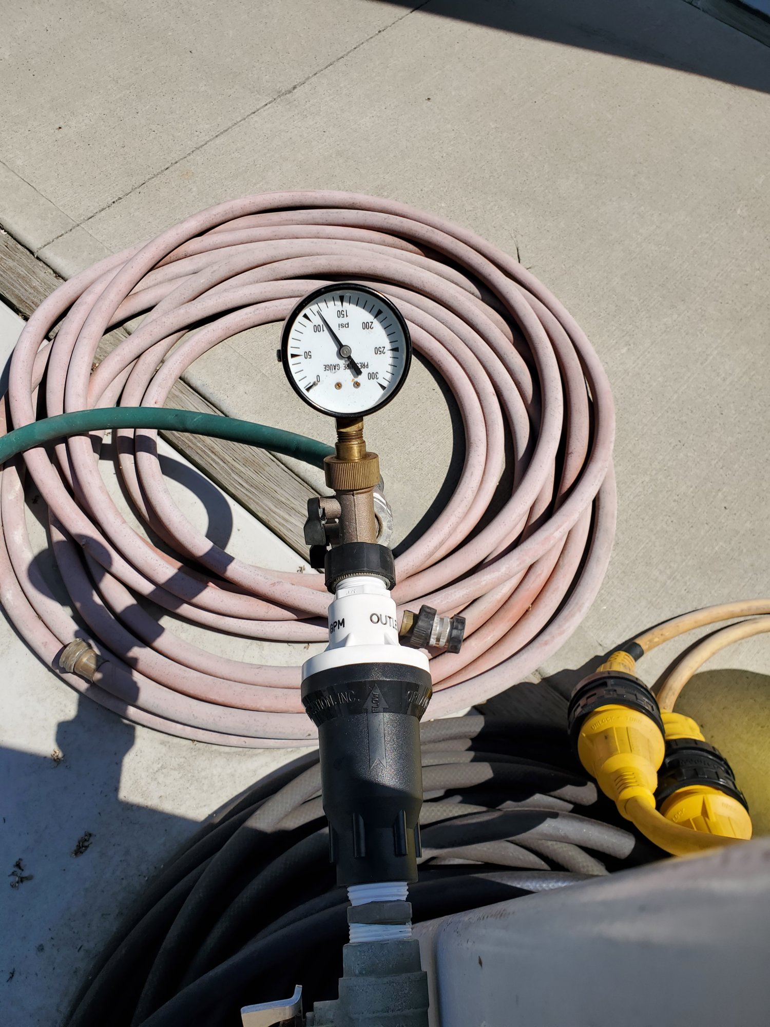

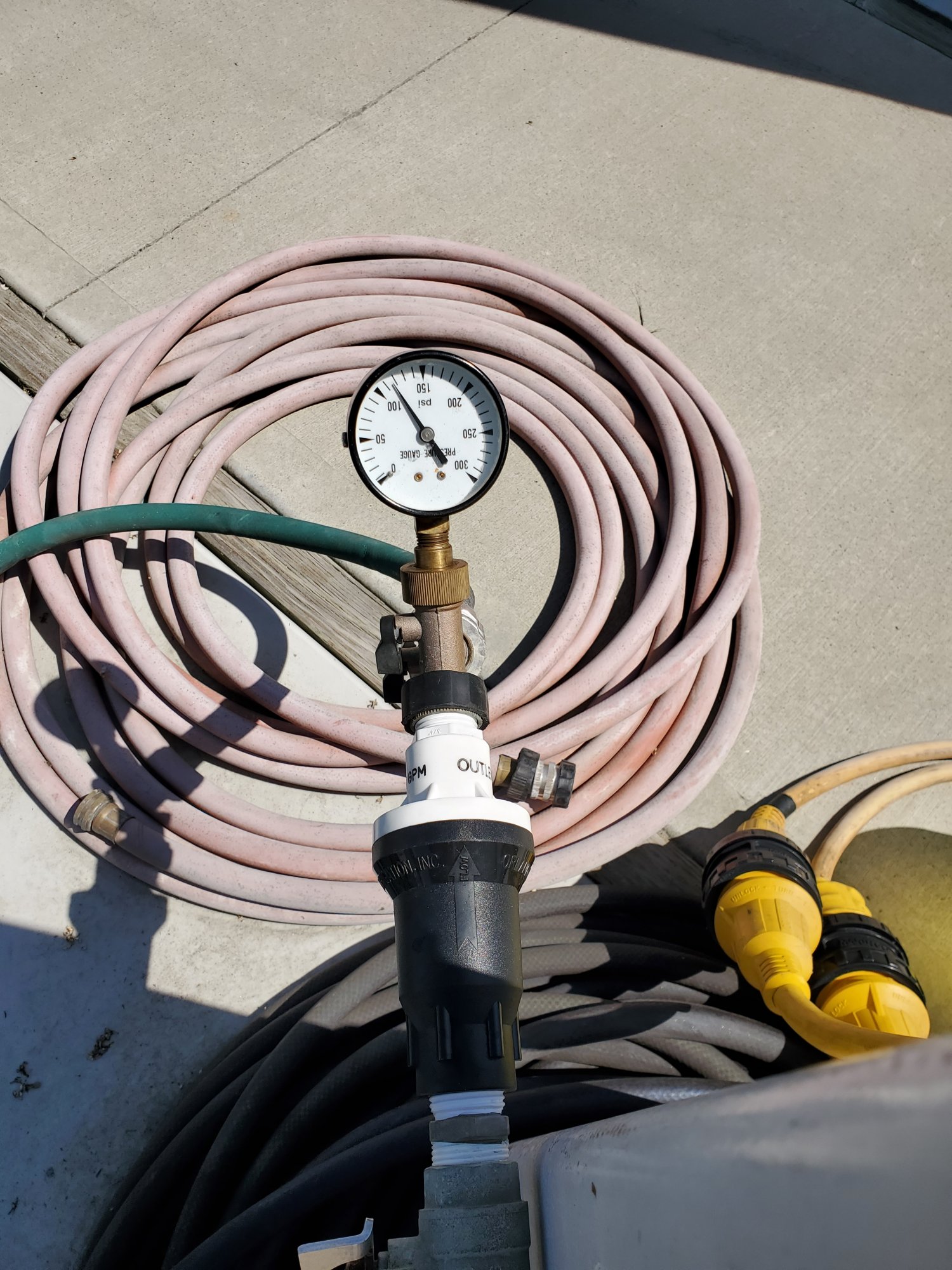

So I checked the water pressure and to my surprise found 115 psi after the pressure reducer. I got another one with a gauge on the reducer so I'm hoping that will solve the problem.
Would I be correct to say that all of your boat's potable water system has been subjected to 115 PSI ? OUCH !
Is the dock supply pressure the same 115 PSI ? I'd hate to think of it being more.

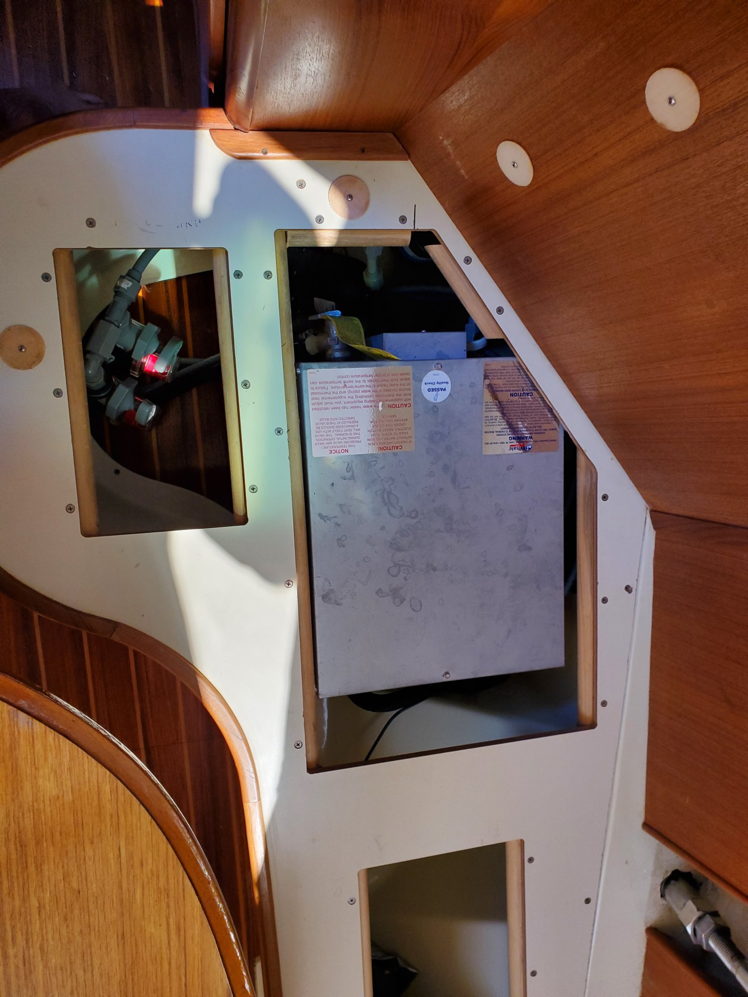

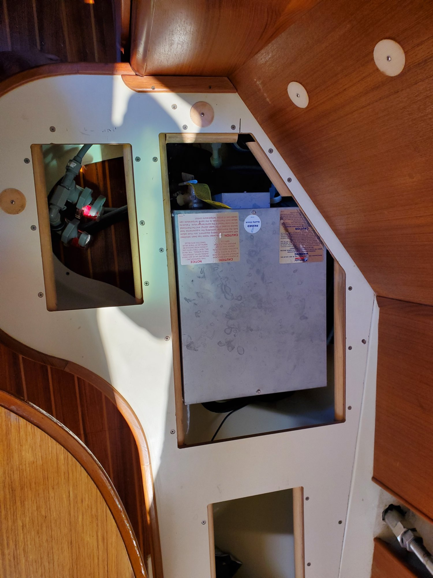

I'm attaching a picture of my access to the W/H and associated piping. I had to break it all down to replace the water heater and it is a huge pain in the ass. The access picture should help explain why I don't have good piping pictures. I could look in my log and at receipts for the compatible parts I bought when installing the new W/H, but I don't remember the brand and can't see from looking at it.
I do have a new spare water pump on the boat. Hopefully the PRV took the brunt of the high water pressure and I won't need to do a lot more once the pressure is actually regulated.

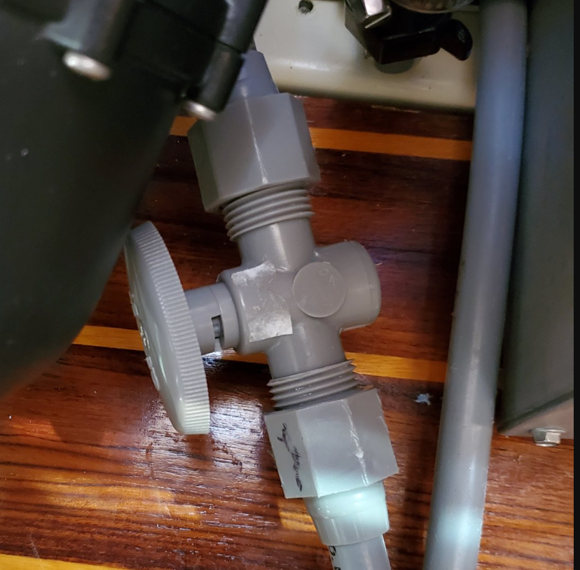

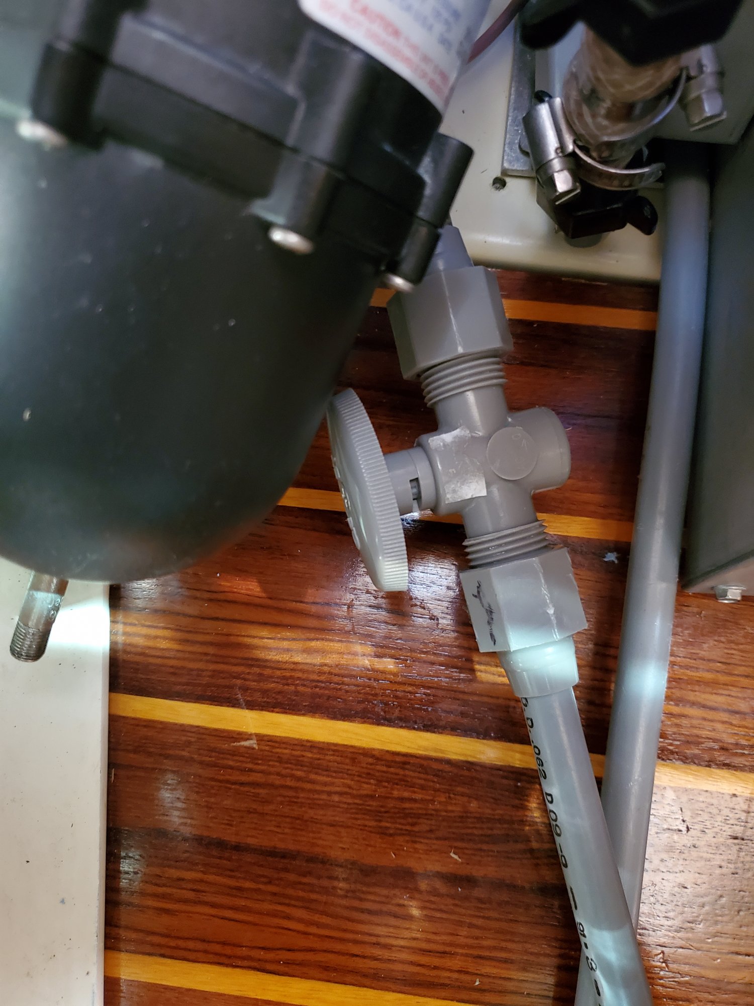

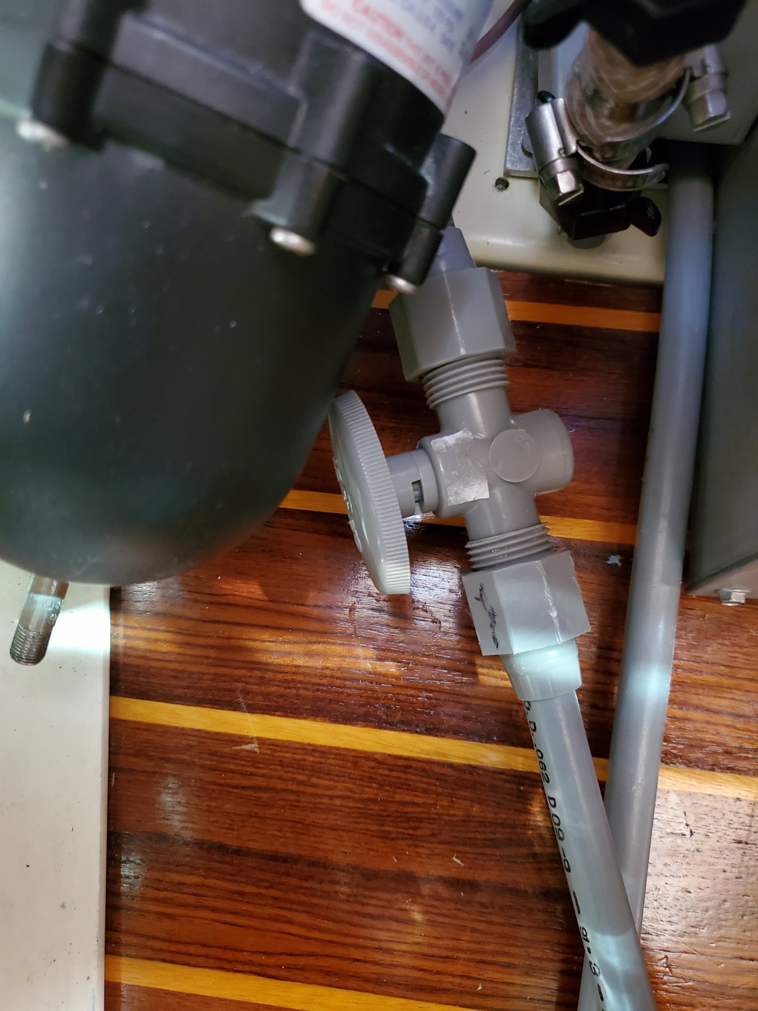

As far as the remaining soundness of your piping system is concerned, maybe not too bad. You have Qest fittings which I believe are rated for 100 PSI but I can't find the manufacturer's literature on this. 115 PSI for a few hours would not hurt these.

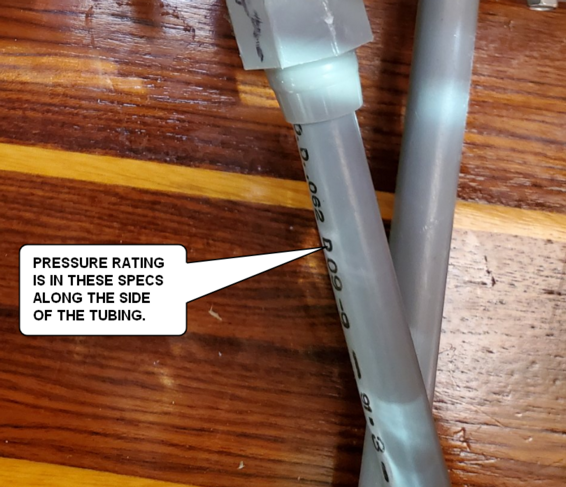

You tubing is grey polybutylene and you can find its pressure rating along the edge of the tubing along with other specs.
I also suspect its maximum rating is around 100 PSI.

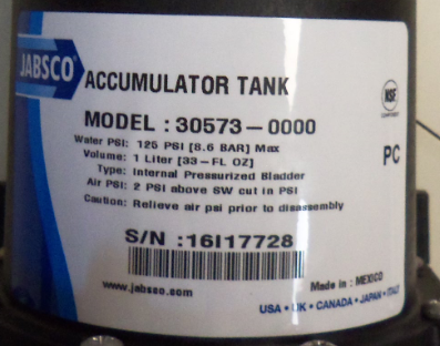

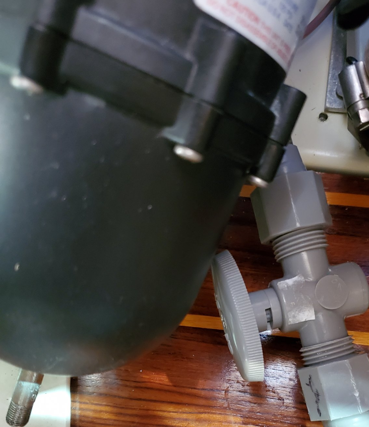

I also see you have an accumulator :
I would check its maximum allowable pressure on the label. It will look like this :
You should be OK to operate your potable water system with your new water pump set at 40 PSI.

I didn't know about the pressure rating on the tubing. But I guess I didn't garner the sympathy I had hoped for by showing the tight quarters of the W/H. I didn't do very well with picture taking before because of space but maybe I can turn the pipes enough to see the specs.
The picture you show of the water heater is almost a dead ringer for what I live with. All you need are skinny little fingers with the strength of a mega robot and you're set to change anything in there.
