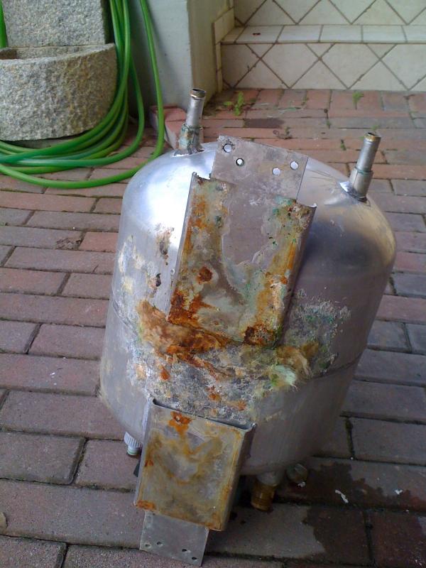

Ciao tanqueray, thank you for the Council, I hope to explain, excuse me if I do mistakes, i think it is better to open a new post, which is useful to all, I called him, seaward repair parts . so see also the pictures.

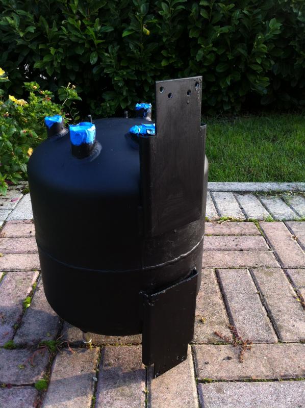

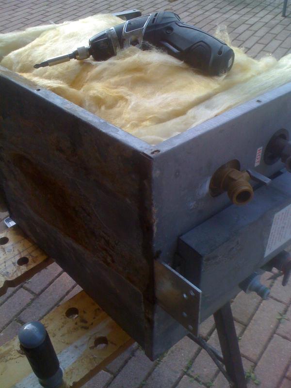

CLAMOROUS error and comedian,:eek: after that i cleaned, painted, repaired the electrical system .... i feel the tightness of the water heaters, disaster for the tank has a leak inside where you cannot repair,:cussing:IMG_0043.jpg first

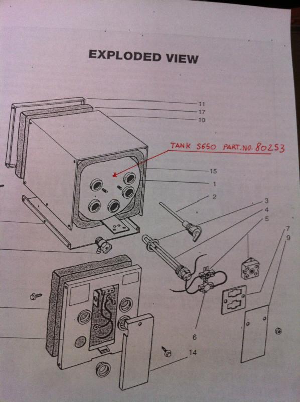

IMG_2863.jpg The spare

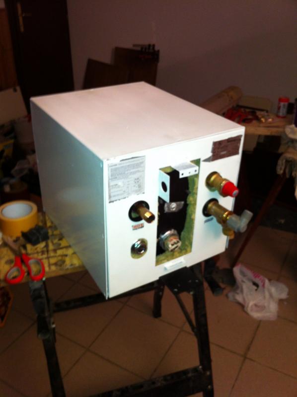

IMG_2427.jpg after
IMG_2600.jpg i think, now I need to understand if you find the replacement part, or if should buy new. appearance advice ....

Your problem with the water heater is corrosion of the aluminum tanks at the heat exchanger from the engine. This is not uncommon.
The square six gallon water heater is made by several manufacturers. Seaward, Atwood, Camco (Kumma) and Torrid are the ones most popular in the USA. There is also Quick. See the 'Store' tab on this website for some information on what they carry.
What you need to know to order a replacement is whether the heat exchanger inlet and outlet is in the front or the back of the water heater. Or, you can simply route your hoses to accommodate a different layout.
I would imagine shipping to Italy would be expensive. You can e-mail the store here to find out. It may be better to check in a marine store in Italy to find out if there is a local source.
