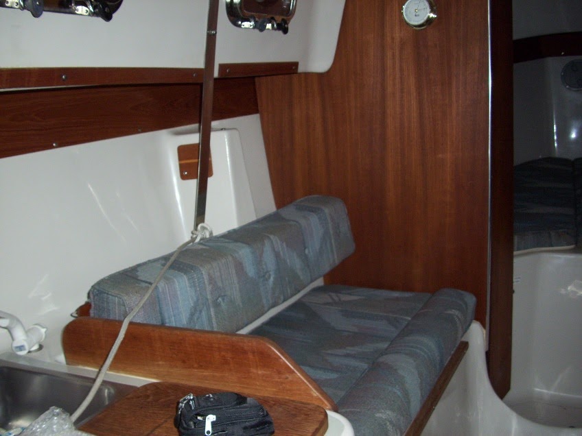

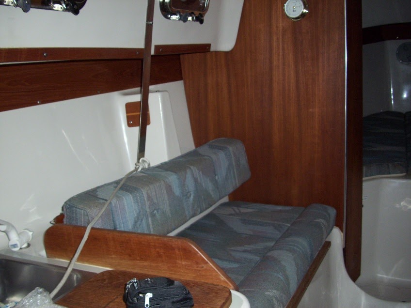

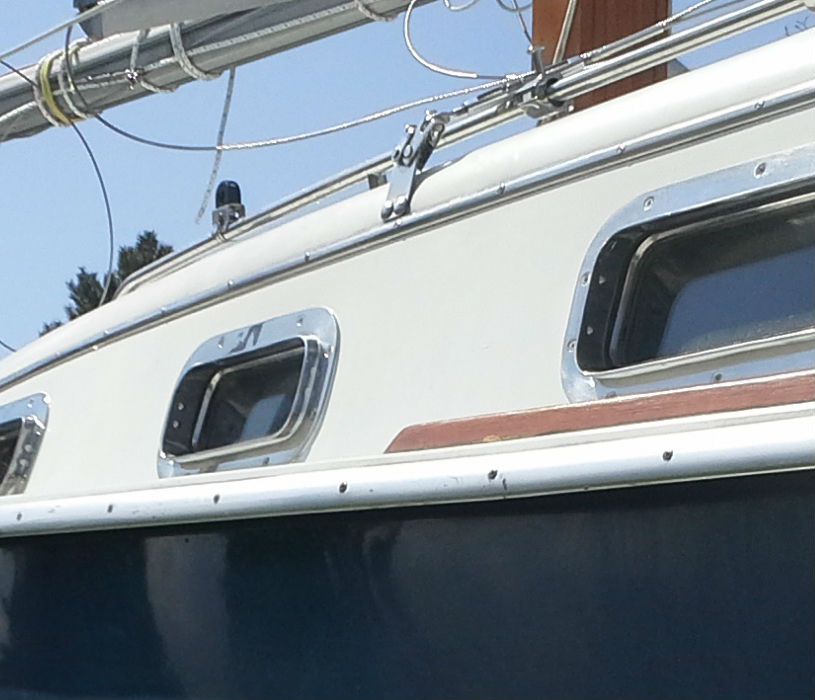

Stu,
These are a little different. They don't go down through the cabin top. There is an outer part of the chainplate, and an inner strap. They are attached together through the side of the cabin with bolts. Then there are 2 bolts that go through the hull just above the boot stripe, that attach the bottom of the chainplate strap to the hull. These are the bolts that are probably causing the OP's leak. They need to be bedded with a product that is good for below the water line. Butyl tape wouldn't be something I'd use for this. 5200 might be the best choice, the more I think about it, as its strength might be a plus at the attachment point.
23,544
Thanks for the photos. I still would avoid 5200 like the plague. You might want to look into what Maine Sail uses for bedding thru hulls.
