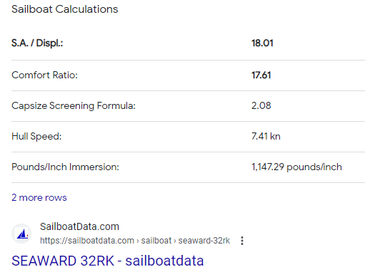

I suppose the answer is sure, you could sail the 32RK across an ocean. But would you want to? @David in Sandusky posted some good considerations. If you look at the 32RK you'd need to add a LOT of fuel and a watermaker to cross an ocean. And SailboatData shows the Comfort Ratio to be almost half of what is "recommended", and the capsize formula to be outside the "acceptable" range, per the recommendations above. The boat only weighs 8,000 lbs, which is very light for a blue water boat (whatever that is) . I read recently that the typical cruising boat to the Caribbean is 20,000 lbs, with the full keel boats being considerably higher. You could always ship your 32RK to Europe and have fun!

Here is the way I look at ratios about sailboats. The question I ask is what was the use for which the designer designed the boat. Every competent designer knows about The Capsize and Comfort ratios. So if they are designing a blue water cruiser, they will meet the minimums for that use. So the Capsize well above the recovery value of 2, and the Comfort well below 30 combine with the trailerability to tell me this is a coastal cruiser designed to trailer from an inland location to multiple sailing areas. Once there, its adjustable keel tells me it is a really good shallow water “gunkholer.” Lots of places in the North Chanel, Georgian Bay, Lake Erie, and Thousand Islands where it would really shine.
