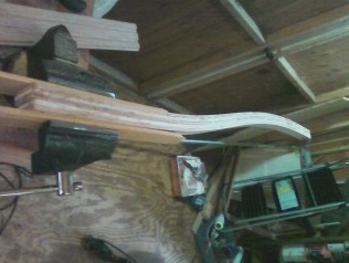

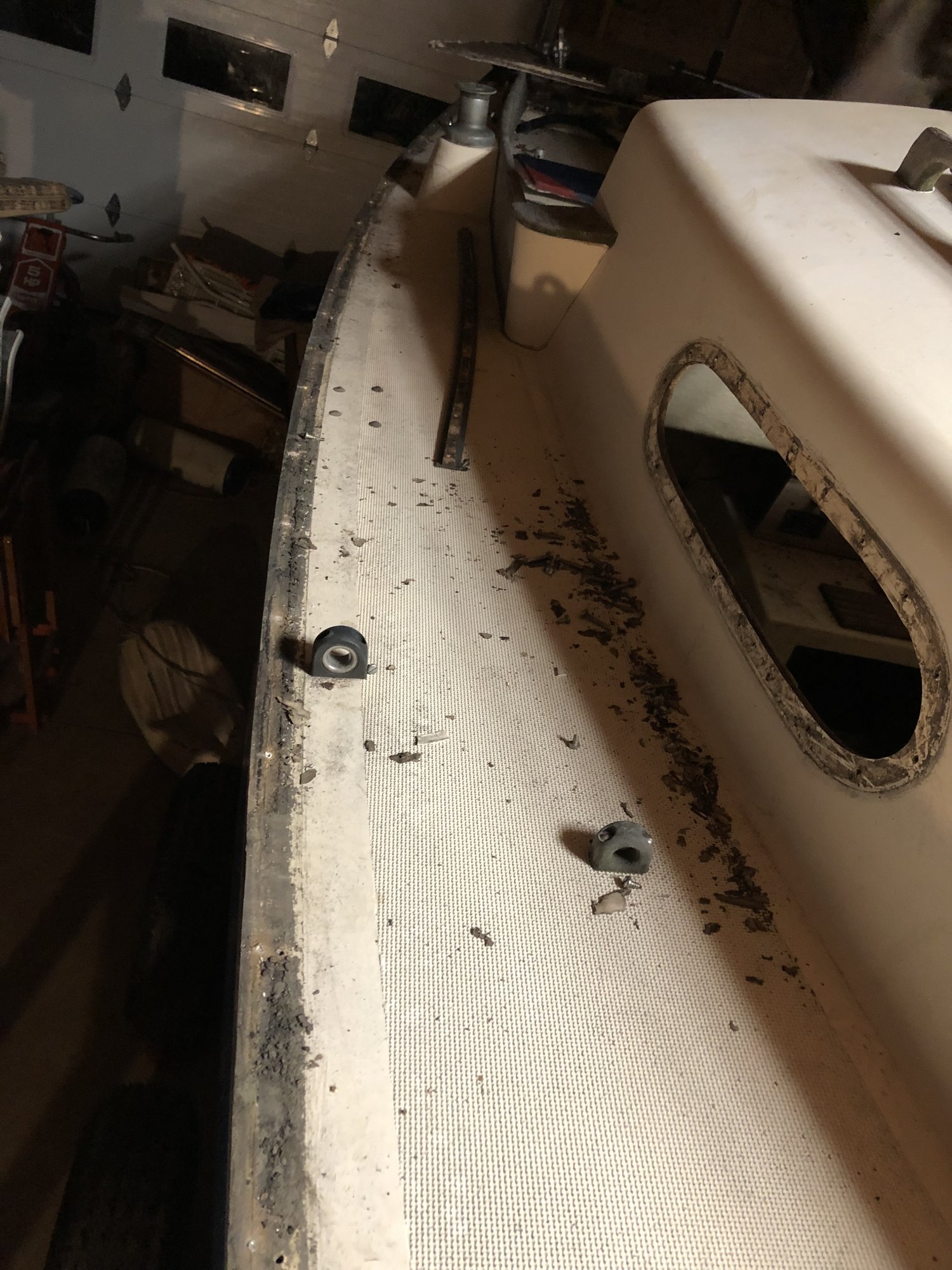

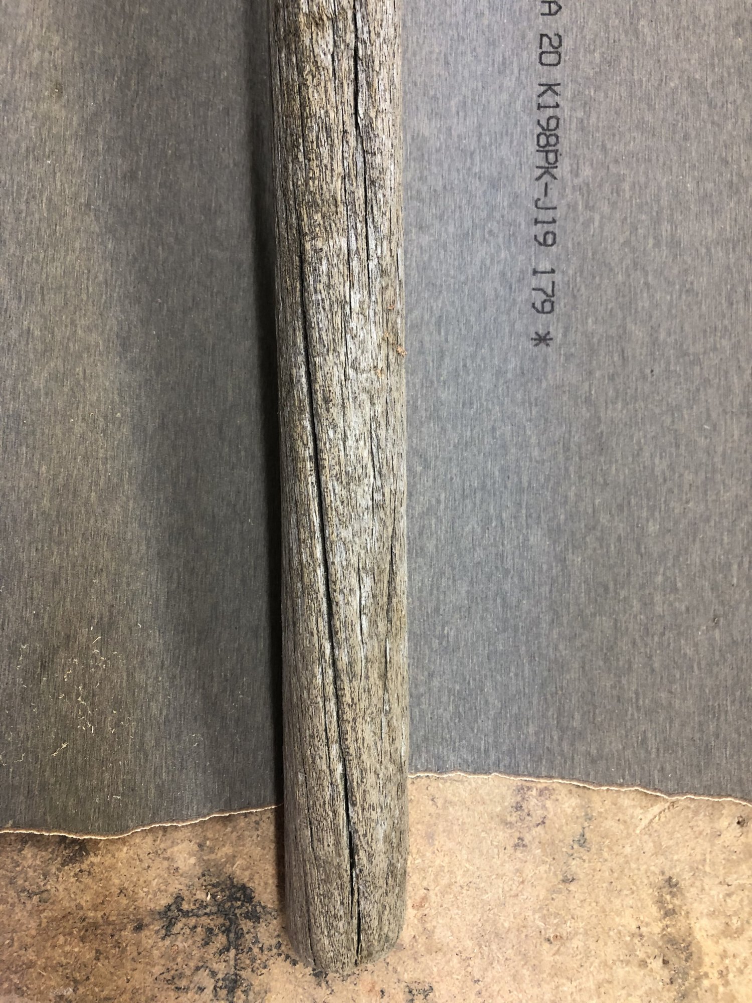

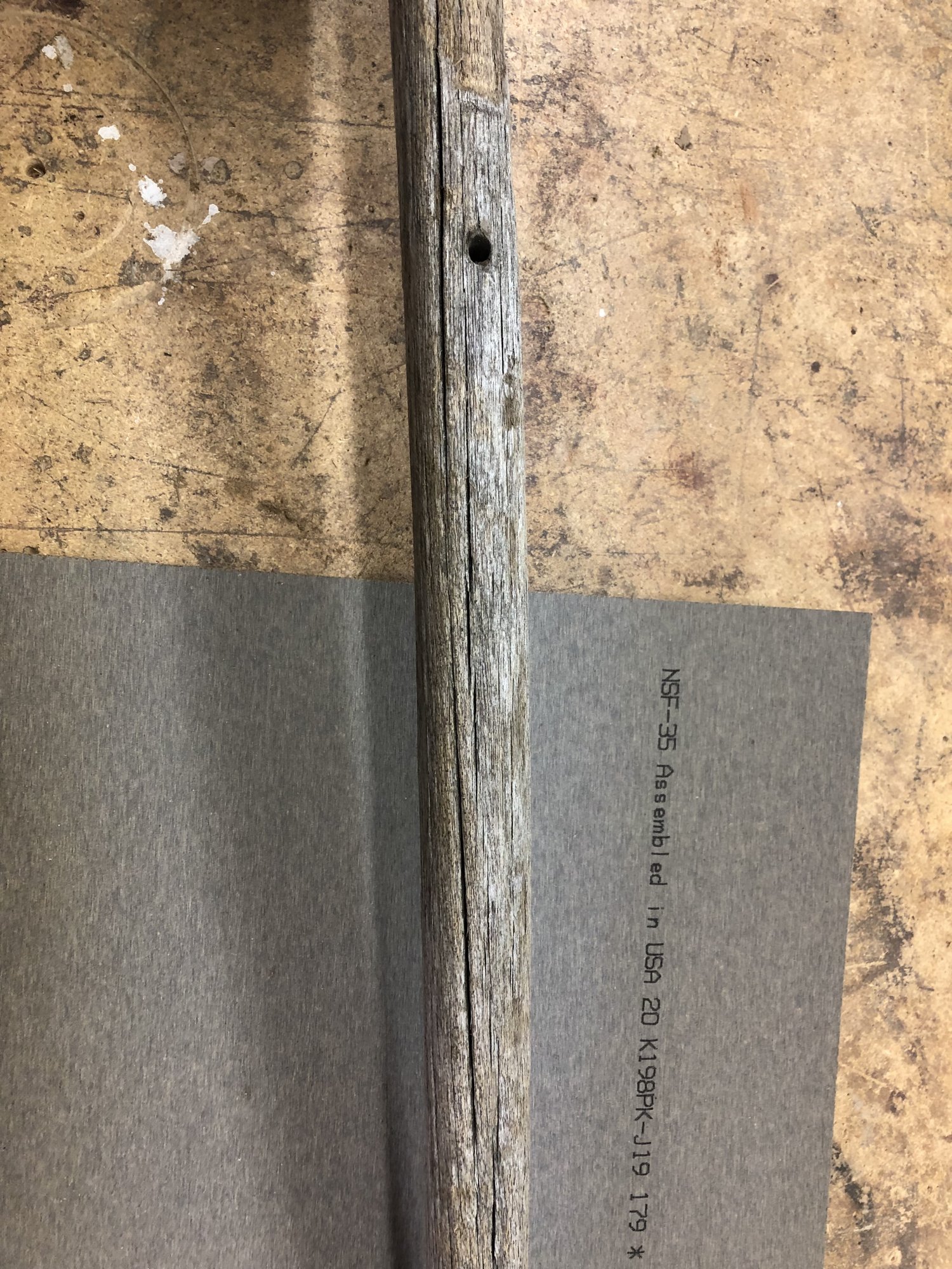

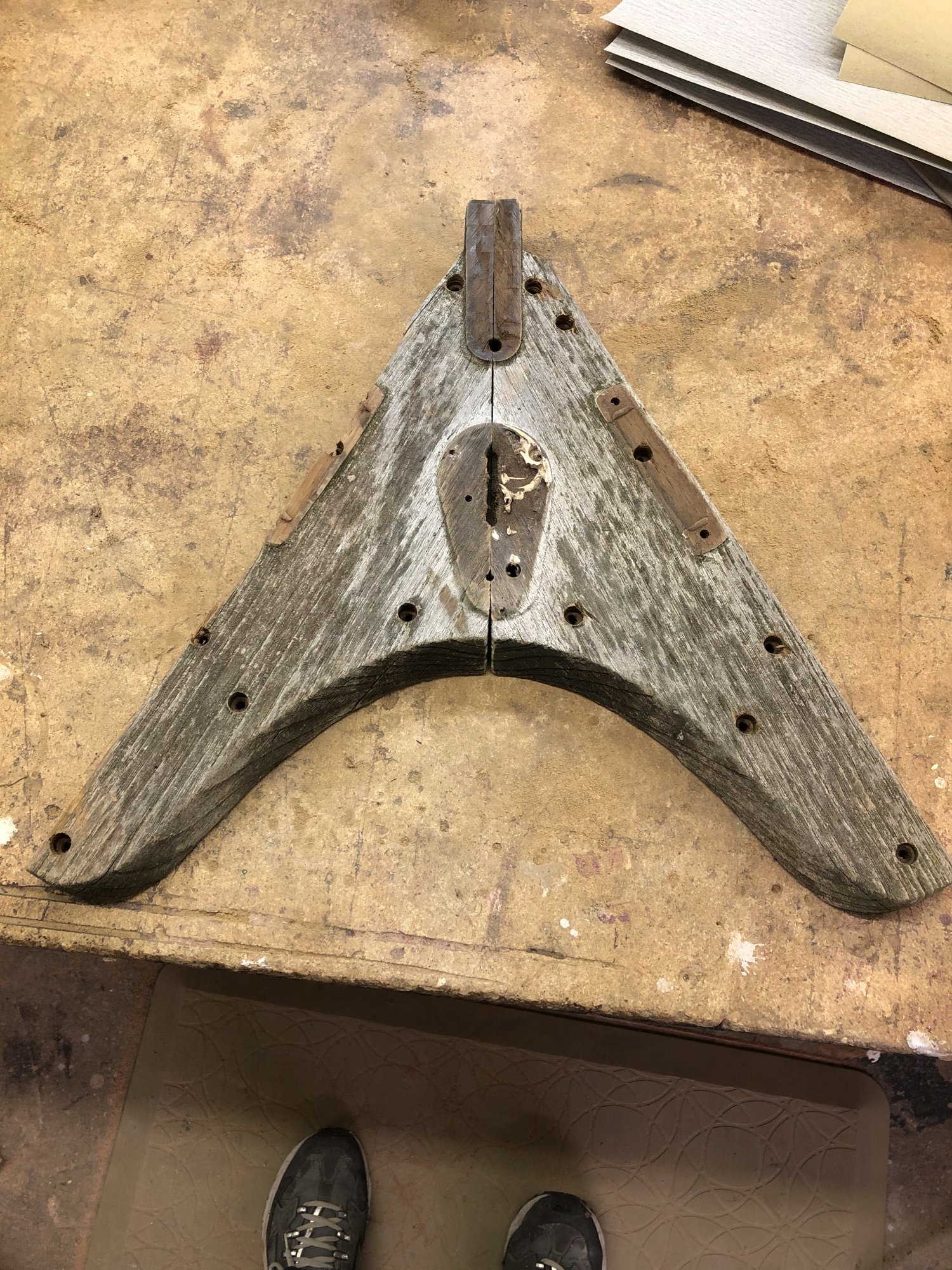

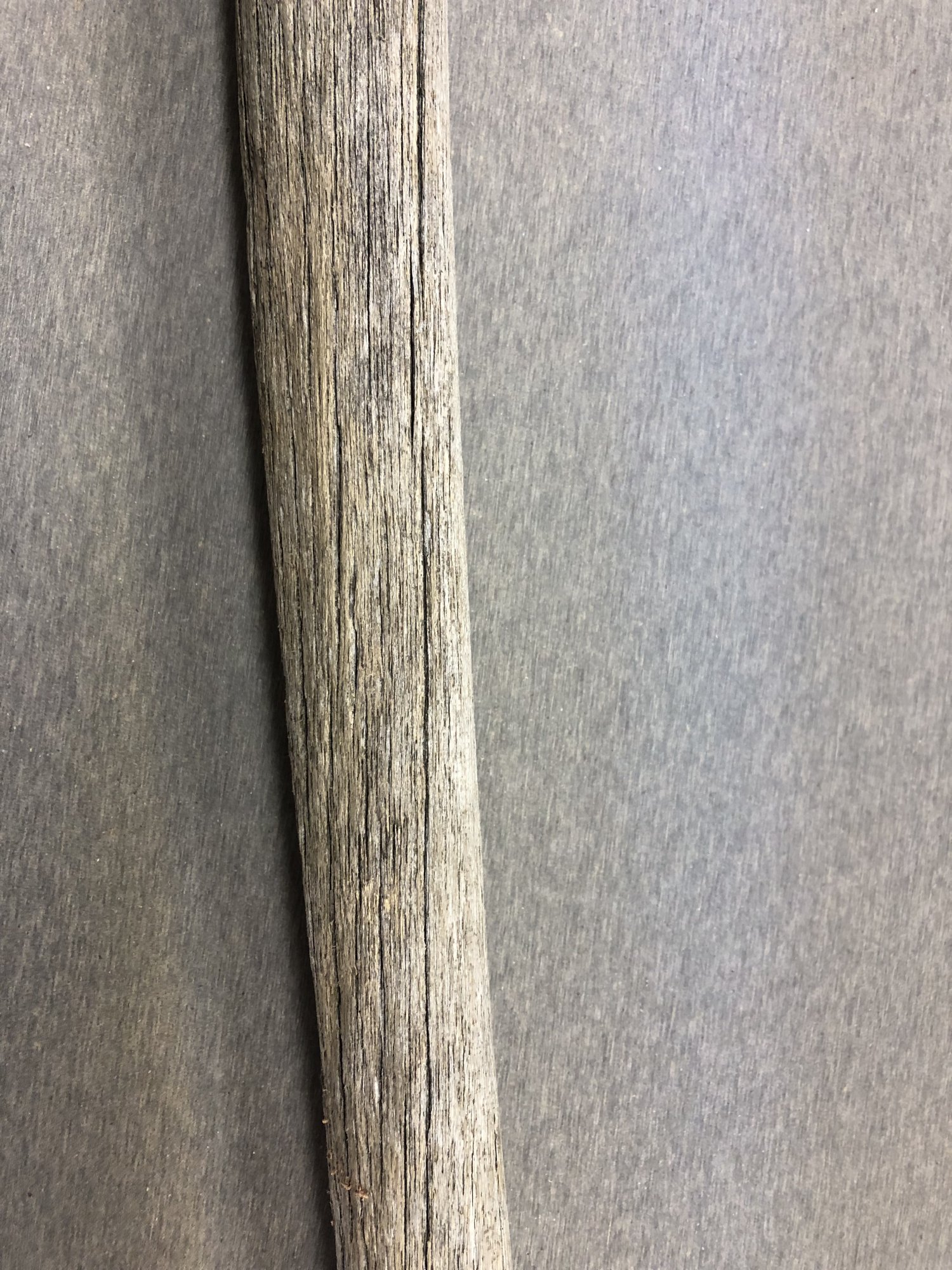

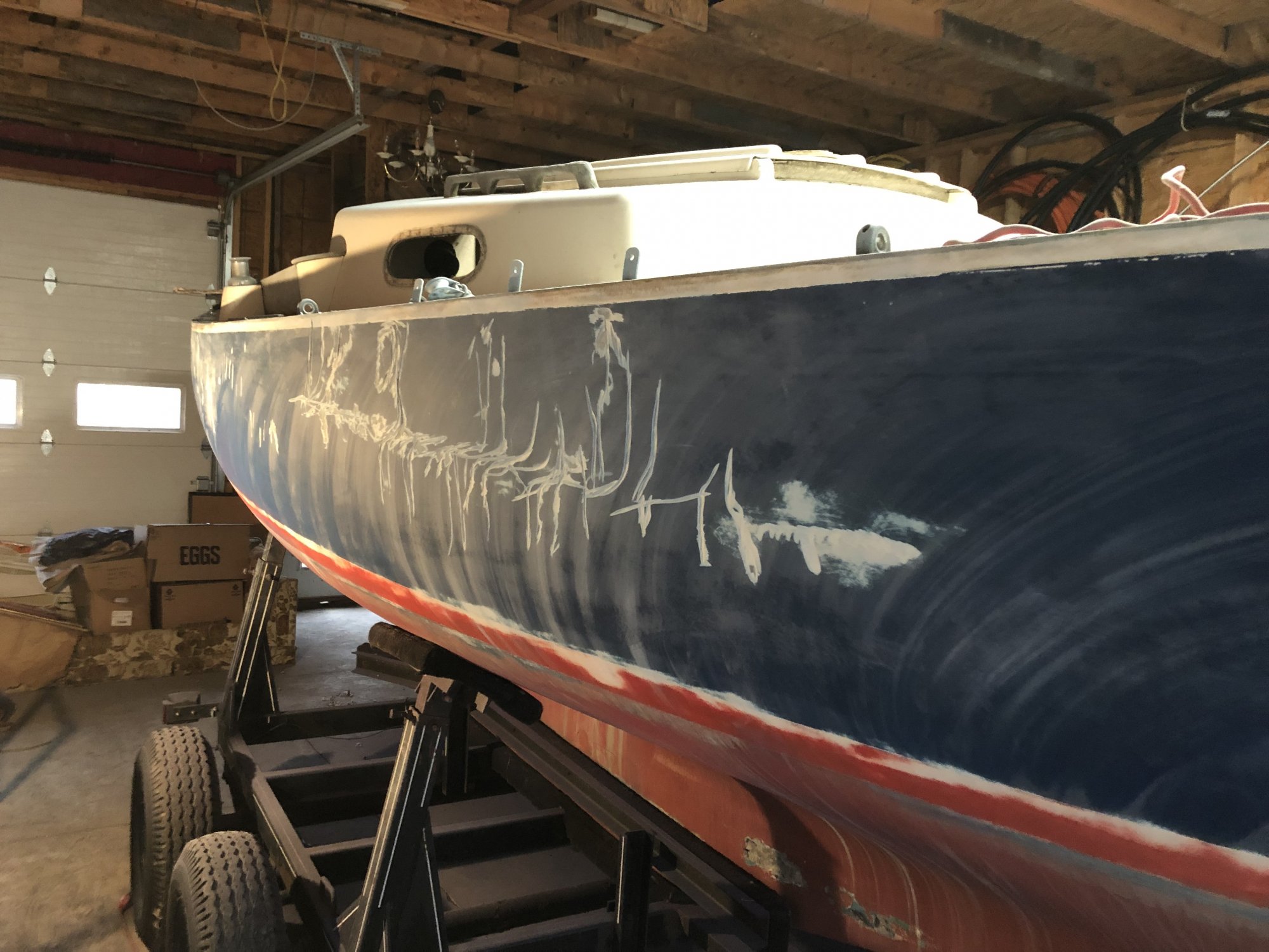

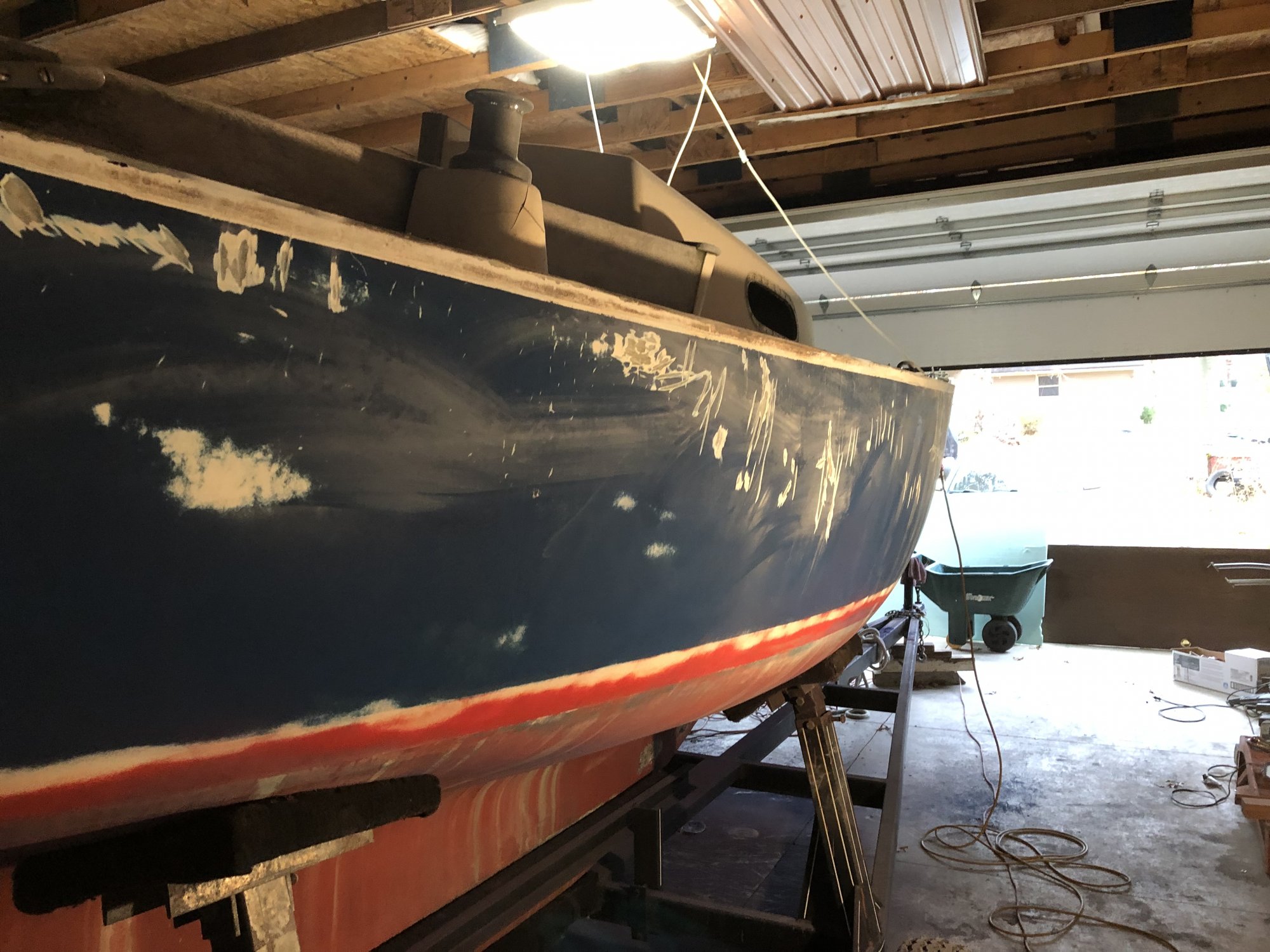

I sailed the boat a few times late in October on Lake Erie she sails fantastic. I could make a tiller not sure if I want to invest the time I have the original tiller I will try to bring it back to life first I guess Pics Posted

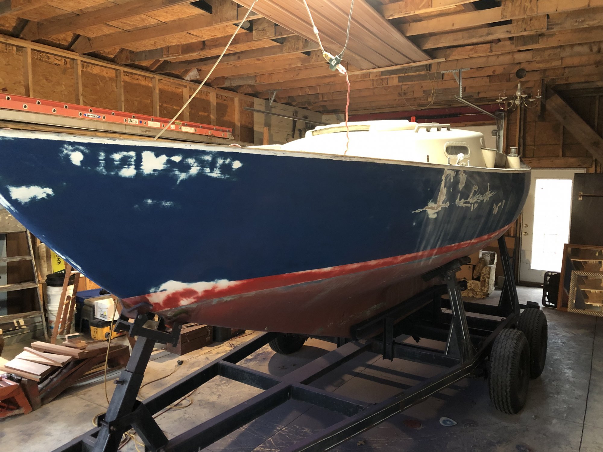

This Saturday is supposed to be about 60 here so I will be doing some epoxy work on the hull and sanding the deck. My goal is to have all the prep work for prime and paint done and have all the wood work varnished ready to be installed by spring
