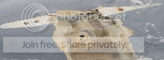

Very sad, I am no structural engineer but the BBC linked photo makes it look like the keel came off sideways?! How is that even possible?
Rick D
Jun 14, 2008
7,206
Skin Peeled?
To me, it looks like the keel just tore off the top skin and some of the core when it went. That's assuming it's a cored hull, which sounds right to me. Odd the ports were broken. Of course, the keel could have been attached by the skin and banged away at them a while, or the rig or who knows. What ever happened, it was sudden. RIP

Possible - weak keel design
How is it possible that the keel came off?
The BBC picture of the boat hull awash shows two bolt holes in the forward part of the keel and one in the aft part of the keel - all along the centerline of the keel. There is no keel stub on the hull and the keel is quite narrow.
The part where the hull skin is ripped off is the only place where there could have been some keel bolts that were not on centerline and that is a very small area.
For that size boat, and for that size keel, I'd proffer that there should have been more keel bolts nearer the outer edge of the keel to resist the moment arm from the loads on the keel. The way the bolt pattern is designed the bolts would have had to been really, really torqued up to prevent sideways (like a hinge, for example) keel movement.
The other thing interesting in the picture is the brownish area around the aft keel bolt hole. Could this be from rust? Or maybe an oil stain because the hole wasn't totally sealed and oily bilgewater got down in the bolt hole?
One weak link in some sailboat designs is the rudder system but when they fail we often hear about it. With keel failures it becomes catastrophic.

It sure looks like exposed core in the image but could also be the hull liner. Was just underneath a First 36.7 yesterday and the keel attachment point is very narrow. I doubt they could even fit two rows of bolts....

The high res photo shows a LOT broken rusted rear bolt and two broken front bolts with the middle section failing
It would be interesting to see how many bolts are there But it does not look like many
It might have been that the boat was hard on the starboard tack; one or more bolts gave way, and the keel peeled/ripped away part of the port side hull as it fell off.
