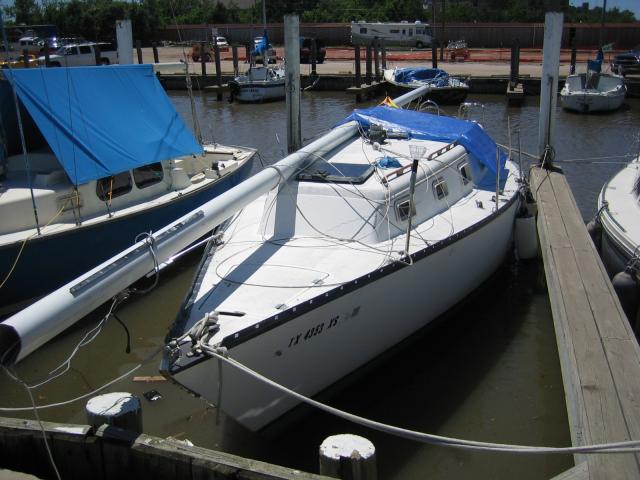

Looks like I finally have it!
The first picture is when I first saw the boat, all others sank around it, but mine came out of the water and laid to rest 300 yards away.
It was brought up to where it shows
The second picture is where I have it now, anmd where I have been working on it
I will send a few more so you can see the work I have done to it
Was lucky enough to have found an exact same Hunter, same year, and from it I have removed winches, bow and stern rail, hand railsetc
By next week when I step p the mast, I will put everything in place
