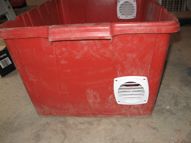

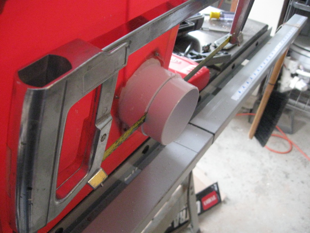

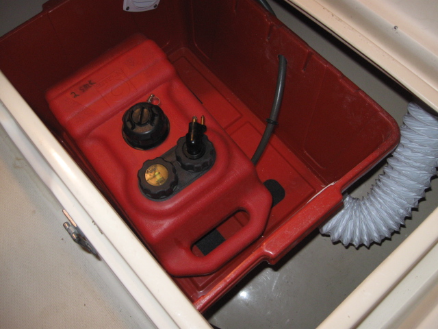

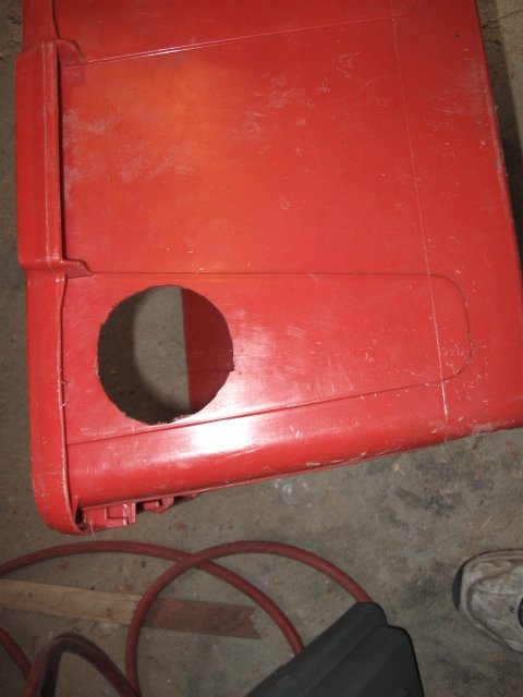

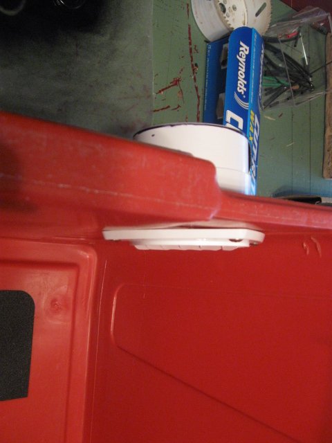

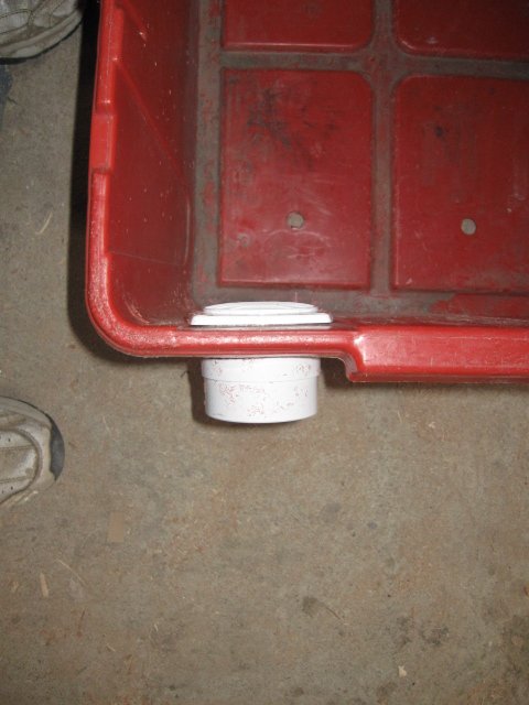

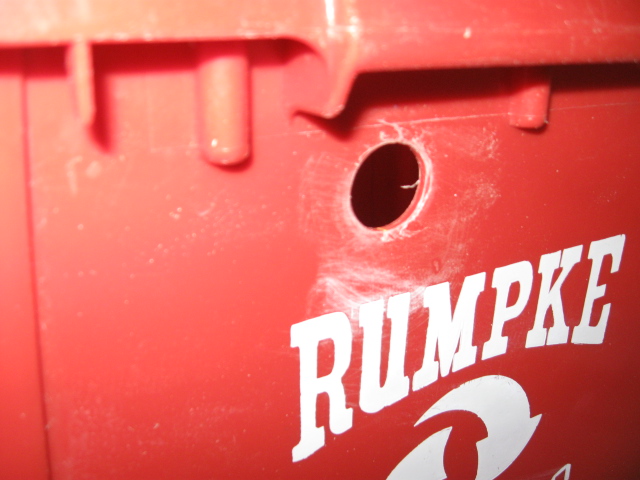

The fuel locker project is finished. Here's some additional images of the build and install. I had to cut off some of the protruding flanges to get it to fit in the port locker. You can see there is plenty of room for storage of motor oil, a funnel, etc. The fuel line is routed out the side and that grommet will be in place, then it goes thru a tight fitting thru-hull well above the water line to the motor. As soon as it gets above freezing I'll test the water tightness of that fitting with a garden hose. There is a lid that snaps onto the box.
My thanks to Ken, whose idea saved me a ton of fiberglass work.
