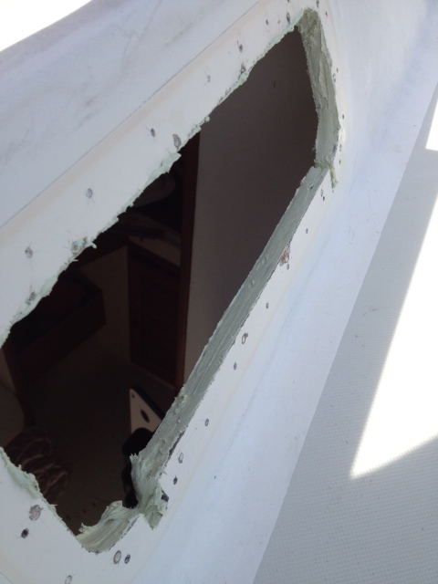

Thanks for the replies. I dug out the core because it was soft. Not rotted completely, but soft and punky, and it looked like it was disintegrating.
Dan - you are correct. The gap is between the filler I used and the core. Here's a picture showing the cutout. You can see the filler has sealed off the gap between the hull and inner liner. The filler probably extends 1/4 - 1/2" down into the gap. I probably took out about 1 - 1.5" inches of core, so that's where the air gap is. This morning, the folks at Beckson said it's probably fine the way it is, as the filler should add sufficient rigidity to the joint. I'm not sure. Part of me wants to grind out the filler and fill 'er up properly.

You could always back fill it. Drill small holes and inject epoxy to fill the gap.

It is always best on any cut-out thru a cored hull/deck/cabin to cut back the core some and seal off with either a thickened epoxy or polyester. You could inject but I've found that to be slow and potentially messy, esp if the space is large. The foam you might inject is quite soft so it will do little structurally.

The question for me is "What are the structural characteristics of that 3M Marine Premium Filler?"
We know that a reasonably thickened polyester or epoxy resin is strong enough to through bolt and support the compressive loads. Is that 3M stuff similar? And also, is the 3M stuff cohesive enough to withstand the flexion that a cabin side would be expected to encounter?
Perhaps a call to 3M is in order.
I think that if the 3M stuff is up to the task, if the new holes you must drill are all through solid filler, then you might be fine.

Since you say you've gone back 2", If that 3M filler is not too tough to get out, the ideal would be to get some balsa coring, sand to ideal thickness, dip in a thickened resin and push in. Or some rigid surfboard urethane foam (easy to shape), or Airex foam coring.

Answer from 3M
Since I work for 3M (not for the Marine division), I figured I'd call the help line to inquire. Turns out the 3M filler is fine for waterproofing the gap, but not as a structural filler :doh:. So I think a reasonable course of action is to drill a number of holes into the filler and inject epoxy until I see it coming out of an adjacent hole.

Reference mad dogs injection idea, I think that is the way to go - My rudder had a void along the whole length of the submerged part of the blade. I drilled a 1/4" hole at the top and bottom of the void, used a west system fillable caulking tube, and filled it right up with thickened epoxy - it's solid as a rock now.
Note that you want to inject things like this from the bottom, so as to leave no voids in the epoxy!

Today, I ground out some of the marine filler to get an idea of the cavity depth. It is about 3 inches deep all the way around the port opening, and the gap between outer and inner is 1/2 inch. I think the epoxy injection is the way to go. Now, I do remember a warning that large amounts of epoxy will give off a lot of heat. West Systems even says "do not inject into confined spaces". If the port is 14 x 4, and the air space is 1/2 inch wide x 3 inch deep, that's a LOT of epoxy. Should I be concerned? I'm sorry for the stupid question.....clearly a noob at this.

Go slowly, I would not expect to fill the whole thing at once. Fill the bottom of the port, and let it setup. Then do the sides, the finally the top. Epoxy does give off heat, but in using a filler with the epoxy to thicken it, you are reducing the absolute volume of exothermic material. The heat is surprising, but not excessive, and won't damage the boat. I filled in 4, 2 inch gaps in the core in my deck and it worked just fine. It will however melt red solo cups pretty quickly.

cut some 1/2 in marine plywood filler pieces to take up some of that 3 inch deep gap no need to make it solid glass...it will bond when you pack the thickend epoxy in there
Exactly what I did this weekend. Then I popped the new port in there, drilled the holes, and sealed with Dow 795. The prep was the hardest part....putting the new port in took 20 minutes.
