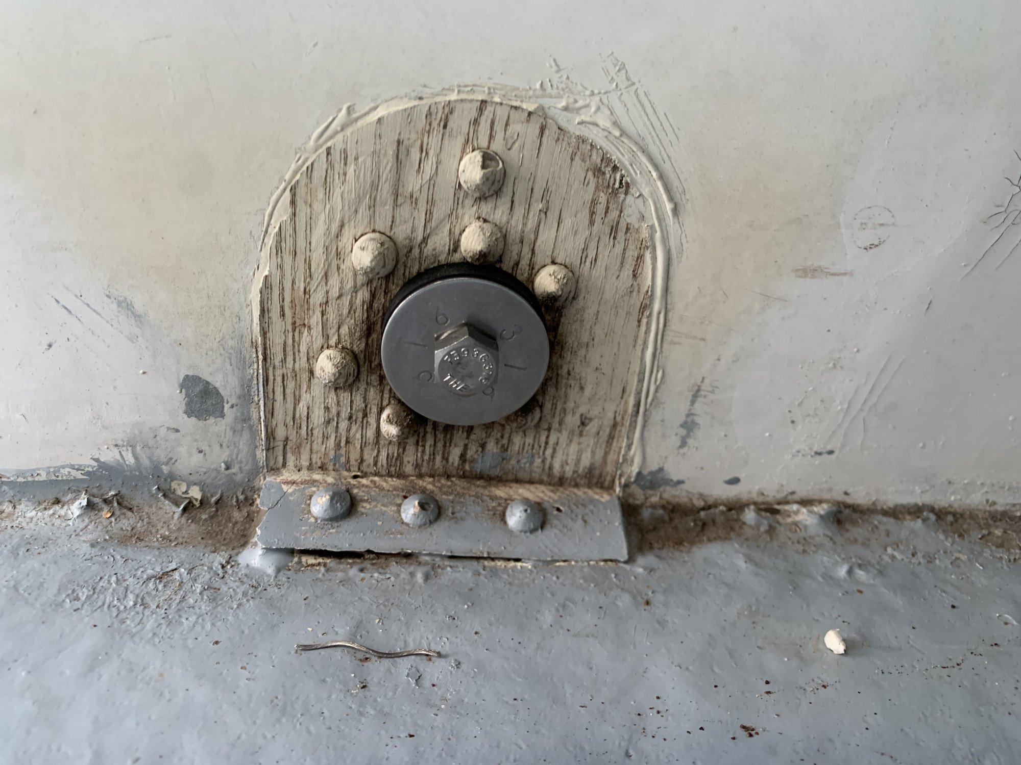

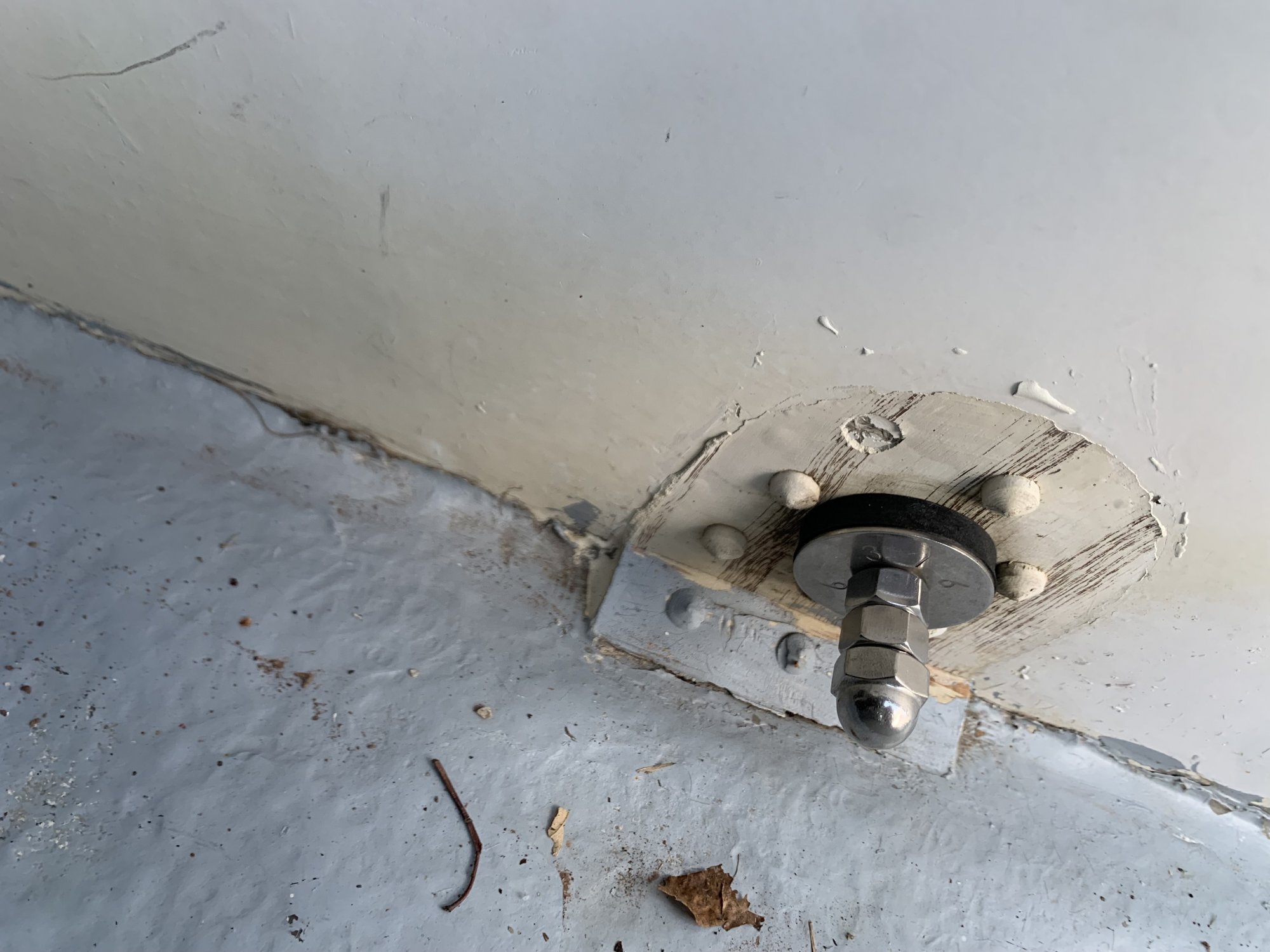

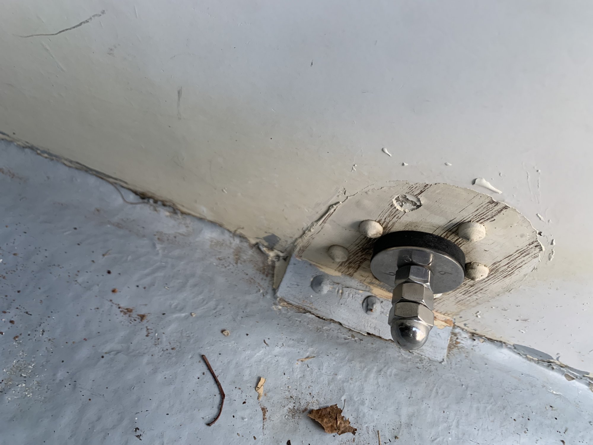

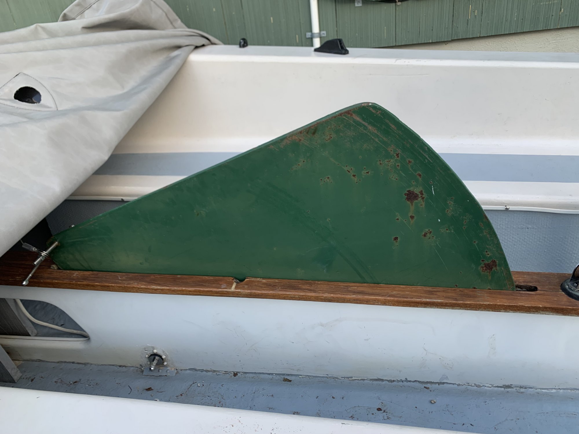

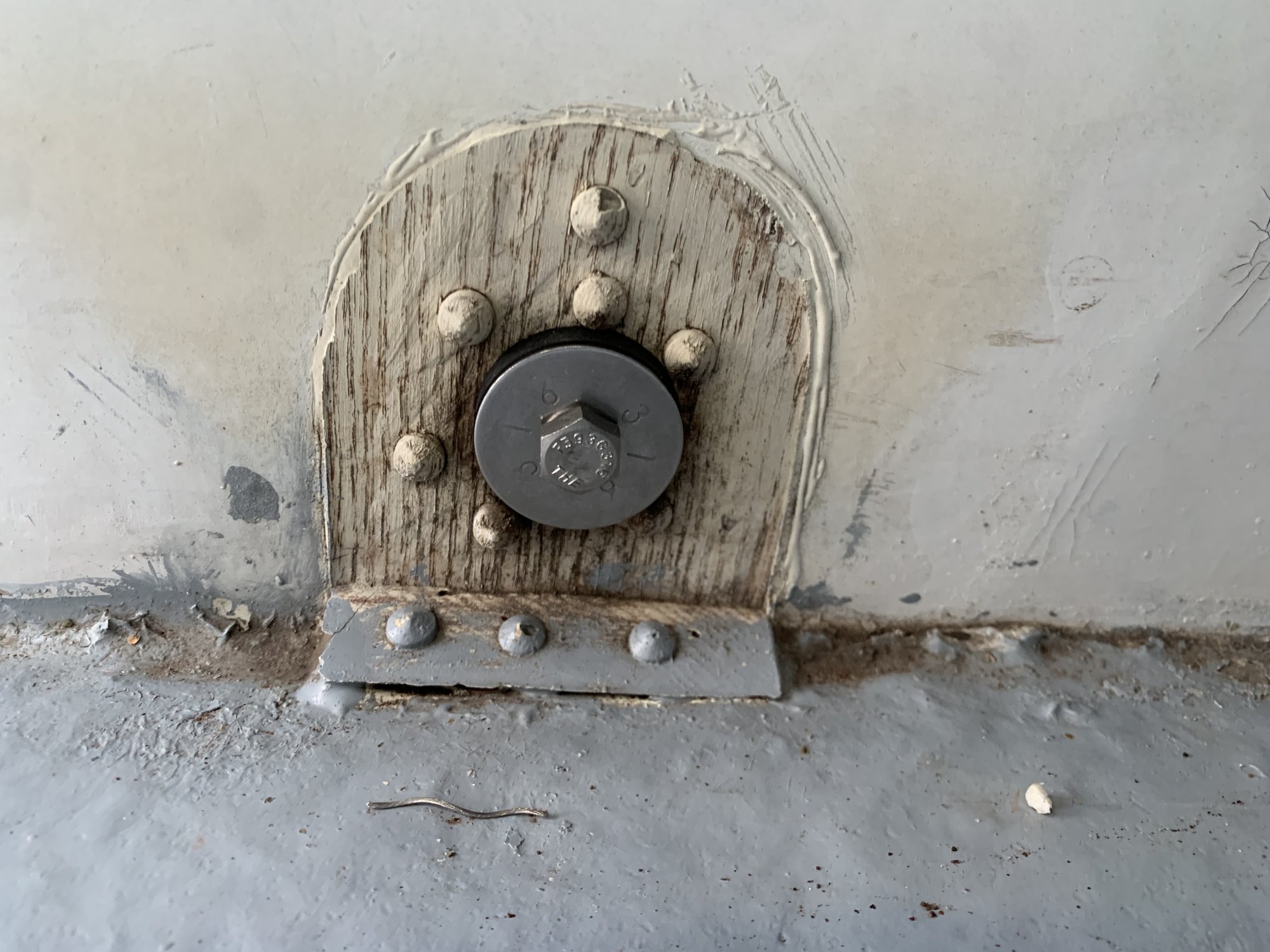

Thank you all for the help! I really appreciate it. Here are some pictures. You can see the bolt in the bottom left of the centerboard, this is the pivot bolt so it's going into the water (the water is on the inside of the centerboard cavity). The bolt doesn't need to rotate, the centerboard can spin around it. I don't know if this area is wood or fiberglass, I assume 4200 is fine with either, I just wasn't sure if it was good to use against a rubber washer.
Regarding the rubber washer, I saw that there was an old rubber washer there when I got the boat, so I assumed it was a good idea. And what type of rubber would anyone suggest? Or not rubber at all? I just assumed neoprene was good for water exposure (and like a wetsuit, this will get wet but mostly hang dry since the boat lives on the side of my house).
Also I tested the new washers without any sealant and it did stop a LOT of the leaking (compared to an old boat with worn old washers). But it still dribbled in pretty steadily.
Also worth noting that the bolt itself is cocked - it's not perfectly parallel along the beam like it should be. So probably adding to a lack of sealing there. It's all old.

The images help.
I now have a clearer picture of what you are doing.
I understand that the metal center board is sitting on your bolt. The hole in the centerboard is about the diameter of the bolt.
As the centerboard rotates and bangs about in the centerboard trunk, the bolt is moving (creating an opportunity for water seepage onto the deck of the boat). At the same time, the center board is chafing on the bolt, wearing the bolt down to failure.
It appears that the bolt is held in place by pieces of painted wood.
Have I properly described the images?

Thank you for the photos, very helpful.
Neoprene is probably too soft. There is a gasket product BUNA-N that might be a better choice. Do some research on BUNA-A washers. This is the material many O-rings are made of, so it is firm and resilient. It is designed to be under pressure and not distort.
If the bolt does not align, it will be very difficult to get a good seal no matter what washers are used. I would suspect one of the bolt holes has gone oval or it has been repaired in the past with the hole having been drilled cockeyed. The solution is to drop the CB and inspect. Depending on the CB trunk construction it may be a wood working project or a fiberglass project. It won't be an expensive repair (unless the CB trunk is seriously rotted) but it may be bit fiddly and time consuming. If the boat is in otherwise decent condition, it's a repair worth doing. It will also answer the question about the trunk material. If it is all wood, then water is definitely bad for it.
