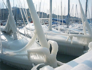

That picture horrifies me. It looks like a recipe to put a boat on the bottom. Our latitude is 48 degrees and we get frost and snow on rare occasion, but all that ice? The only reason we can't sail year round is when we have ice in the marina (usually 1/4 inch for a week or so each winter.) Having said that we don't often sail in winter as it isn't as comfortable as in the warmer seasons and it's frequently raining.

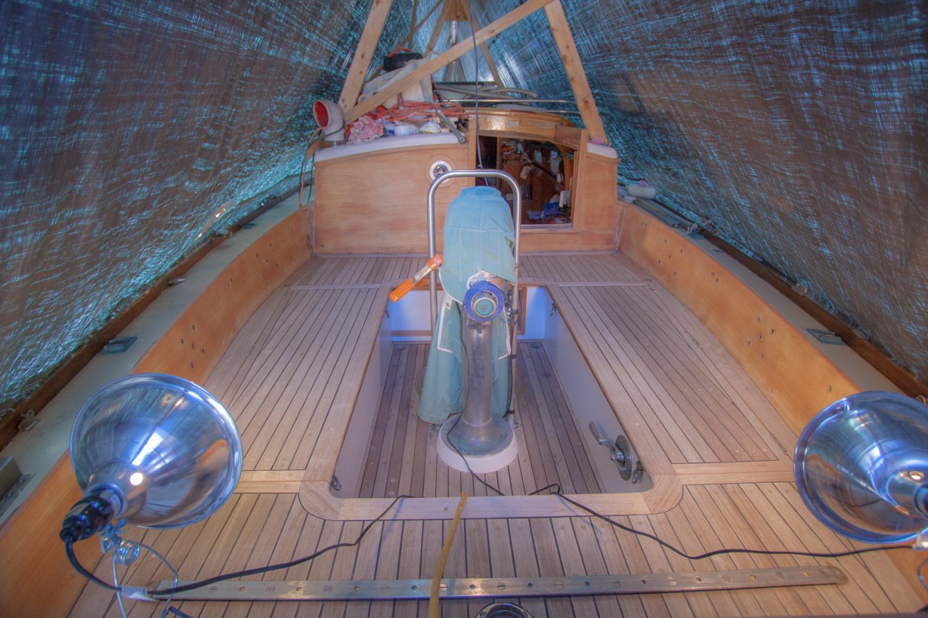

Winter prep: I removed our headsail because it's new and I don't want it to mildew. I open up inside cabinets, head, and the engine compartment and turn on a small heater to keep the temp above freezing (around 50 degrees or so) which also helps keep moisture down.

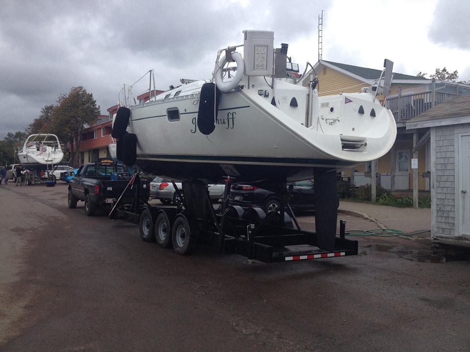

Here's mine, approx. a month ago at the club lot, it's home now, only another 6 1/2 months until she's back in the water, (ahhh, east coast living!) Winterizing involves, flushing gallons of the pink stuff through everything, disconnecting the batteries, winter cover install, and shore power hooked to my shop for the electric heater in case I get lonesome, good side is I look out my kitchen window and it's there!

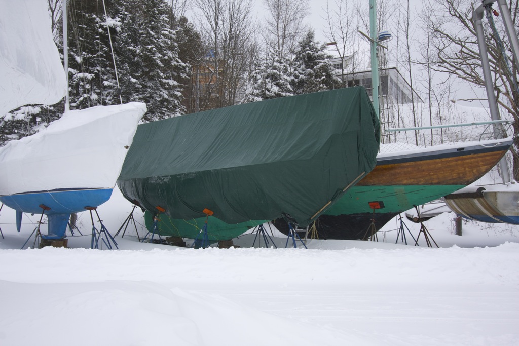

Sealed with a bow (and a stern, too).

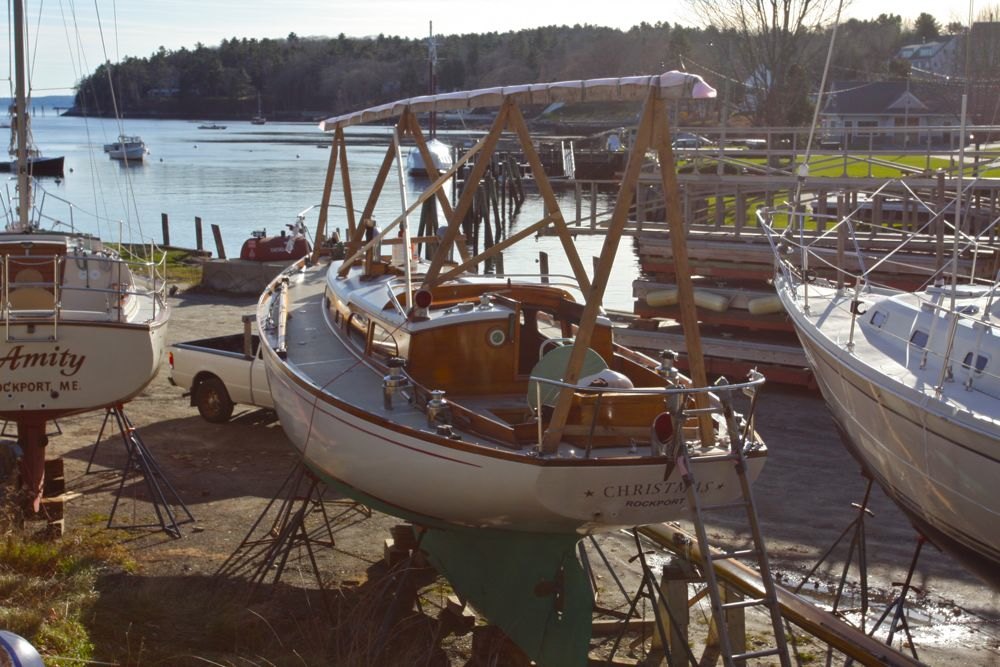

Phil's header is kind of what I do to cover the boat. I've settled on this method:
4 A frames support a high ridge.
A 30' X 50' plastic tarp is thrown over the frame. I run the oversized tarp down over the topsides and between each jack stand pad and the hull. Each pad is tightened and lines are run through the tarp grommets and tied.
As for 'sealing the bow (and stern), I take a 4' piece of 2X4, hold it at the angle of the bow and stern, and roll the tarp up around it until I reach the hull. Then I take another piece of 2X, and screw it(long screws), into the first 2X, now rolled deep in the tarp. At this point, the tarp captures the hull. I leave an adjustable opening on both ends that allows some air flow but no precipitation. It sheds most snow but wet stuff can stick and require an occasional push from inside.
This arrangement (used now, 10 years or so), allows me to leave hatches open to ventilate the boat during winter. I leave pretty much everything onboard over the winter and it all stays dry. Plus I can get a few projects done under the tarp in the early spring as it warms up nicely in the sun.
Indoor is best, shrink wrap is next, a tarp is probably third. And costs are in the same alignment.

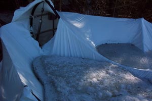

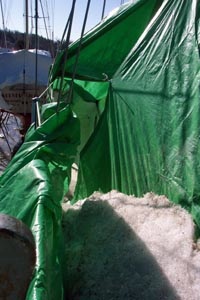

Ice dams, that is the problem in our area. Often starts as wet clinging snow. Some covers can be worse than no cover. Once a dam or pocket forms, each rain and snow storm adds weight. If you're not there to clear the tarp,
the force can do some damage.
Even shrinkwrap can collect wet snow. If the frame isn't up to the weight it can easily collapse.

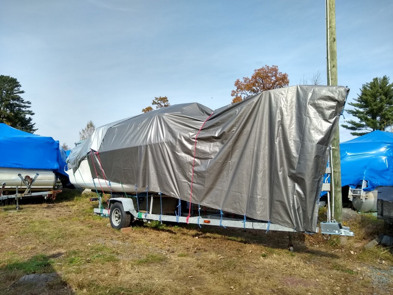

Other than the cover, I put the outboard in the basement, remove the battery so I can service it, remove most of the cushions, open the lazarette covers and lift the floorboards, and remove sails. Boom stays in cabin with lines attached.
To cover, I have gone through various iterations. This year I have a PVC frame, (hopefully) an improved design from last year. I pull lifelines from stanchions, leaving them coiled in cockpit. 4 in diam PVC drain type pipe goes over the 4 stanchions, about 4 or 5 in above top, resting on deck. 90 degree elbow at top of each lets a length of somewhat smaller (3 in?) pipe go fore-aft between the 2 stanchions on each side. I cut a "slot" at the top of each vertical pipe on the side facing the center-line of the boat that lets a 1.5 in PVC pipe rest in it. Drilled a hole fore-aft through both the 4 in and the 1.5 in pipes (at the top of the vertical) and pushed a smallish PVC tube through, sort of like a clevis pin. Secured each end with a hitch pin. These support 1.5 in "A frame" like trusses, one across the boat at each stanchion position, with a 45 degree elbow glued to form each peak, about 2 ft above the prone mast in its normal position on crutch and pulpit. A 2X4 ridge goes from the rear peak, over the front truss, and about 2 feet further. I also have a pair of 1.5 in pipes wire tied together that hangs over (and is wired to) the mast about halfway back in the cockpit, each lower end resting on the deck against the molded toe rail on the 23. So the tarps are supported by the mast at the rear, these "legs" over the cockpit, the ridge plank, and the pair of "roof trusses" at each stanchion position. The pulpit and mast support the front of the tarps. I fashioned 2X4 crutch like supports to support the mast in 3 places against the deck, and also against the bottom of each A-frame, so any snow weight doesn't crush it.
A pair of silver Harbor Freight tarps (one large, one medium) that cost me about $60 total on sale cover it. Tied tightly to trailer at every grommet with the cheap braided synthetic line from Home Depot, the kind that has a foam-like core. I like it as it seems to last a number of seasons and is easy to pull tight using something like a truckers hitch or even just wrapped on the trailer frame. Hope it has enough angle to shed most snow, we'll see next spring.
