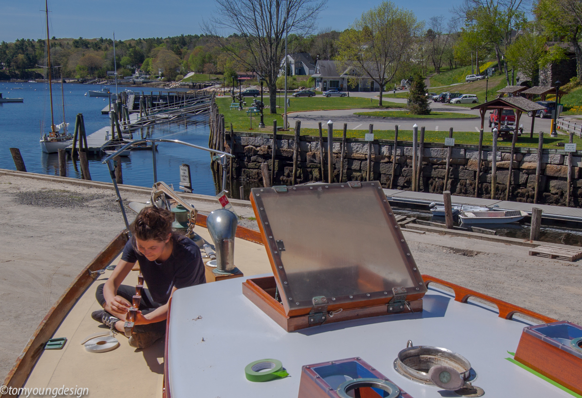

Sometimes with my boat, I need a good 'splooge' type of caulking.
I used Life Caulk when I cut new trim for the fixed ports in my mahogany house. This has to be one of the toughest joints to seal as wood moves. Polysulfide fills voids, joints in wood to wood and seals to the glass.
I think the step that is over looked in sealants used with wood is that the wood has to be well sealed or the sealant will dry out prematurely. Once cut, I sealed the trim (and the mating surfaces in the wooden house), with several coats of varnish.
Poly sulfide is a mess to work with! I apply it generously, tighten things down, and walk away. I think it's easier to deal with the squeeze out, after it has partially cured.
That was 9 years ago and despite the seasonal wood movement, not a single drip has come through. I attribute that more to the sealing of the surfaces than the sealant itself.

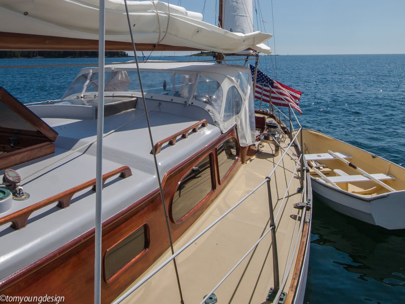

However, when I re-installed my handrails on the cabin two seasons ago, I used Butyl tape. It made more sense: Small bases fastened to fiberglass house top. These surfaces are subject to tough forces so the sealant should stay pliable.
I still don't clean the butyl up initially. The next season the butyl came off at the joints with a plastic scraper.

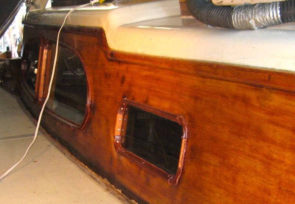

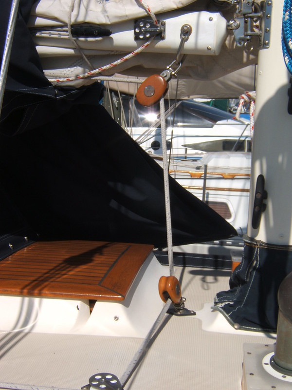

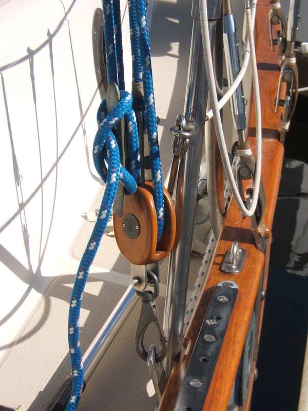

Bob , that is a very good question . I will find out for sure today and to be truthful I didn't know there were two different types . Also I'm not looking for bedding compound , but thank you for the suggestions . I'm looking for a sealant that will stick to a teak to teak joint and a teak to fiberglass joint and not dry out and crack , at least for a reasonable amount of time . Here are some examples , first is my caprail and that will need teak to fiberglass sealant next is my turtle and that will need teak to teak . Thank's guys , Mark .
IMG_0185 by mark westi, on Flickr
003 by mark westi, on Flickr
24,797
Pretty glimpse of your boat.
On inspection your "cap-rail" if like the side rub rail is attached to the boat using counter sunk screws covered over with plugs then varnished. The screw attaches the teak to the boat. Then you just need a product to stop water from entering the hull.
This is where a bedding compound or caulk is used. I use the butyl tape available from Maine Sail https://marinehowto.com/bed-it-tape/. It seals yet remains flexible. Last for years.
You could also look at the various poly-sulfide sealants. Butyl seals yet allows for removal in the future without destroying the boat. Bedding compound does the same. A sealant adhesive like 5200 not so much.

Thanks for the compliment jssailem , original construction method for all Westsails was when they were fitting the cap rail to the gunnel they would first lay down a "bedding compound" and like you say screw it down with a counter sunk screw . The area of concern is where the cap rail sits on the gunnel I over the years seal it up on both sides . Some Westsail owners get so frustrated with the cap rail that they remove the cap rail and glass over the lap joint , I'm not in that camp the cap rail stays . And the joint gets fixed . OK , some SBO folklore . Actually my cap rail is ok for right now , but I can see some trouble spots . A while back there was a guy posting here asking about a good liveaboard boat , I got to talking to him and long story short a Westsail 28 was for sale near him . It was perfect , the boat was on a mooring (mid California) he bought the boat and the mooring . He and I have stayed in touch , one of the problems he is dealing with is the dreaded cap rail leak .
