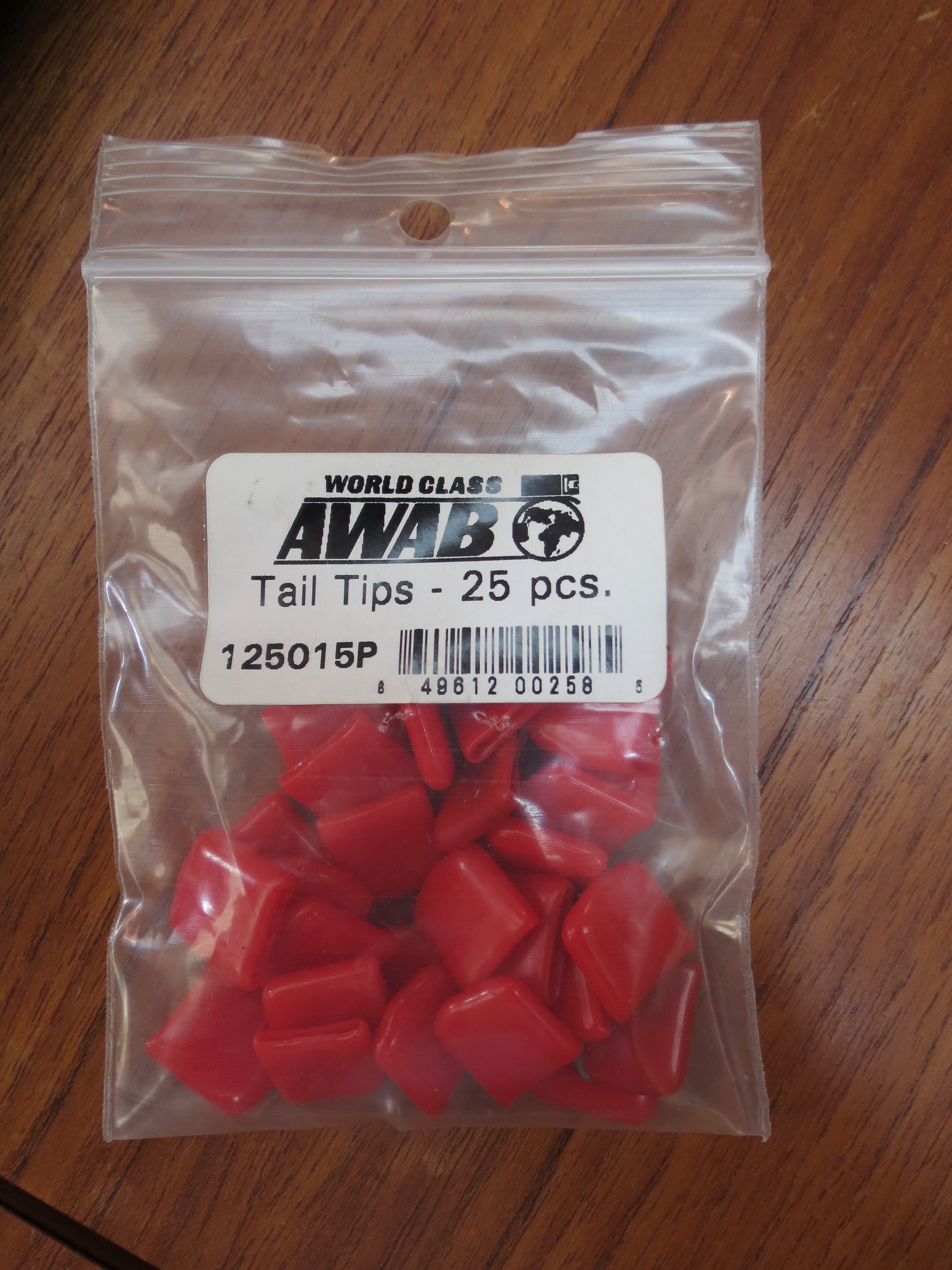

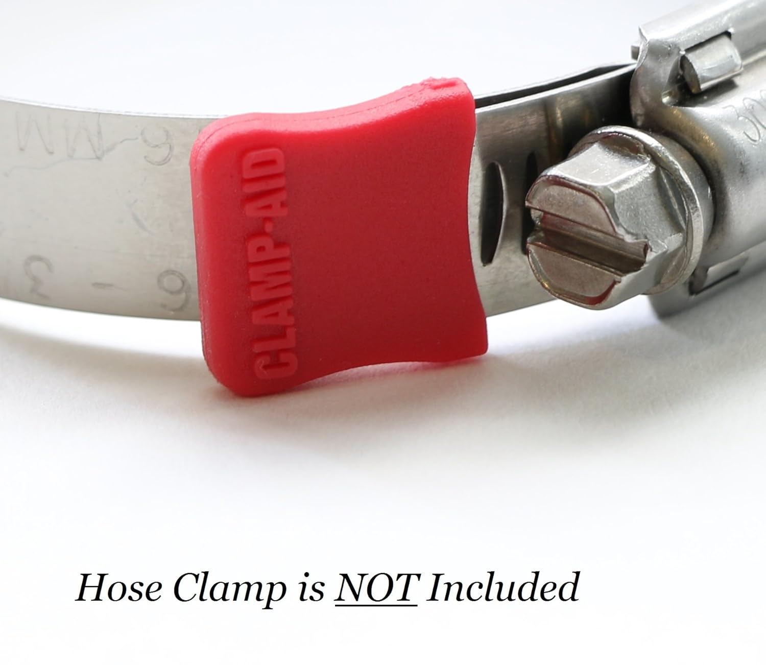

Absolutely. But I have some little red plastic push on covers for the hose clamp tails. The stupid things are about 25 cents apiece but they are removable and reusable. Since clamps are occasionally removed I think the red plastic covers are the way to go for clamp tails.Rich, do you think that elastomeric would work on the sharp edges of the ends of hose clamps?
I got onto as a result of a bunch of PS testing. It struck me as the most predictable of the low-strength sealants. Also better adhesion to polyethylene, though flaming the surface really helps.capta: I recommend Sudbury 321 Elastomeric Marine Sealant. It is available in a variety of colors and will stick to mast aluminum and stainless steel cotter pins. My rigger put me on to it. He and now I use it to coat cotter pins to protect against snagging. The great thing about it is when you need to remove it all you do is grab a piece of it and pull. It comes off cleanly without leaving lots of little pieces to pick off. Skins over quickly and cures in one day at 70 degrees.
Where? They sound neat.Absolutely. But I have some little red plastic push on covers for the hose clamp tails. The stupid things are about 25 cents apiece but they are removable and reusable. Since clamps are occasionally removed I think the red plastic covers are the way to go for clamp tails.

http://www.defender.com/product3.jsp?path=-1|2243574|2243584&id=669092I can't remember the source but here is a picture.
