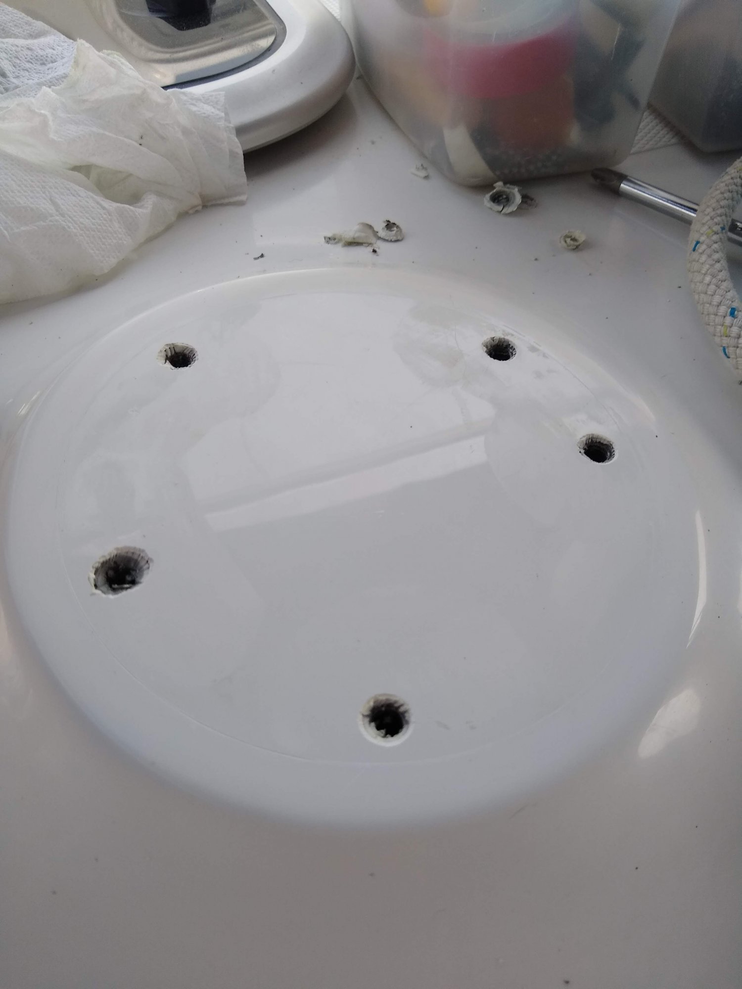

rgranger, yes that it! I have attached a picture of the gelcoat that was under the winch after I cleaned it. I honestly don't know how I ever would have removed the winch without damaging the gelcoat without using the DeBond.
