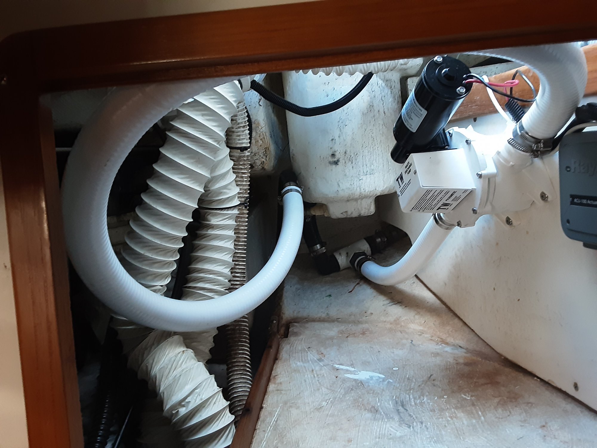

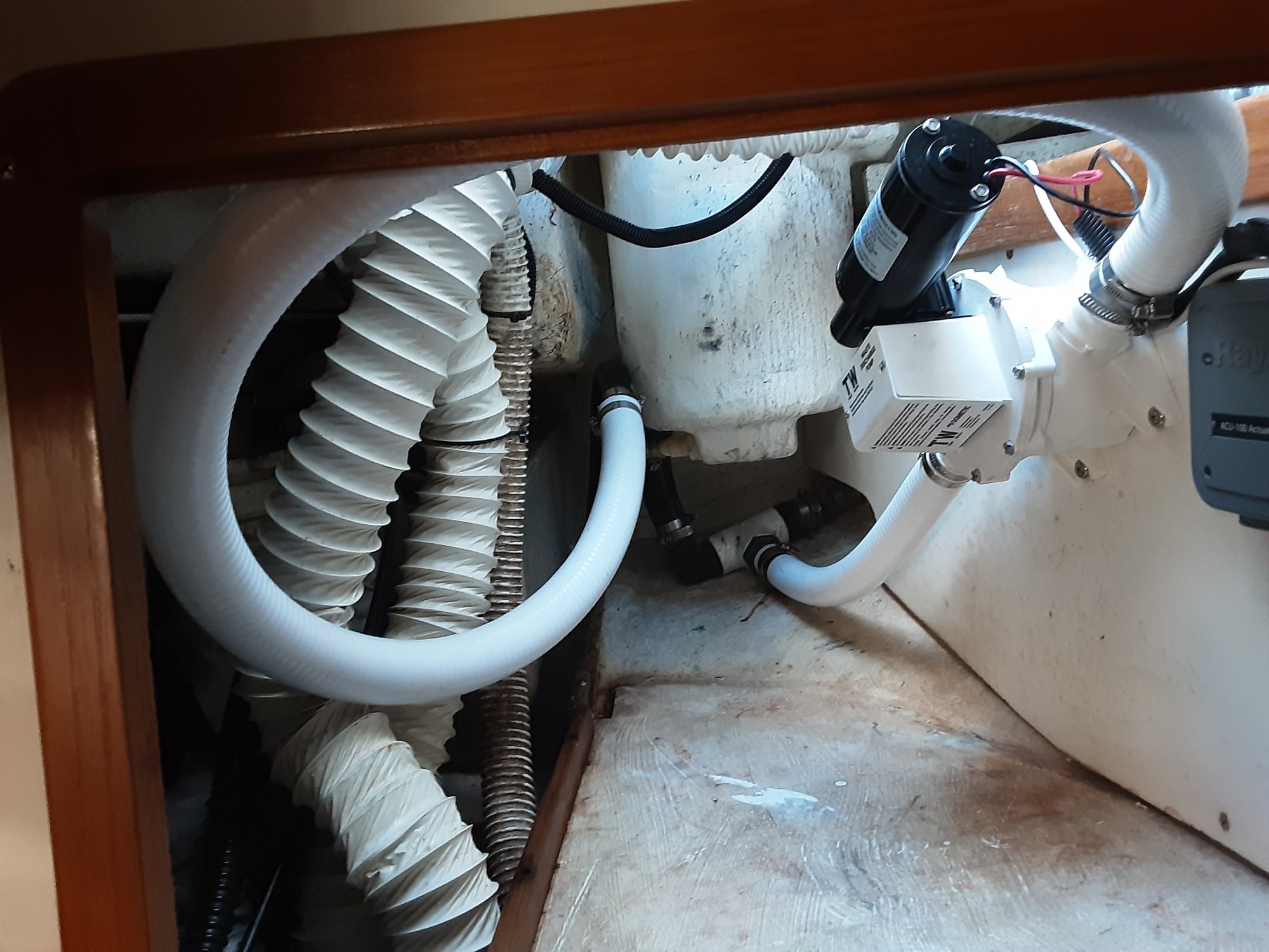

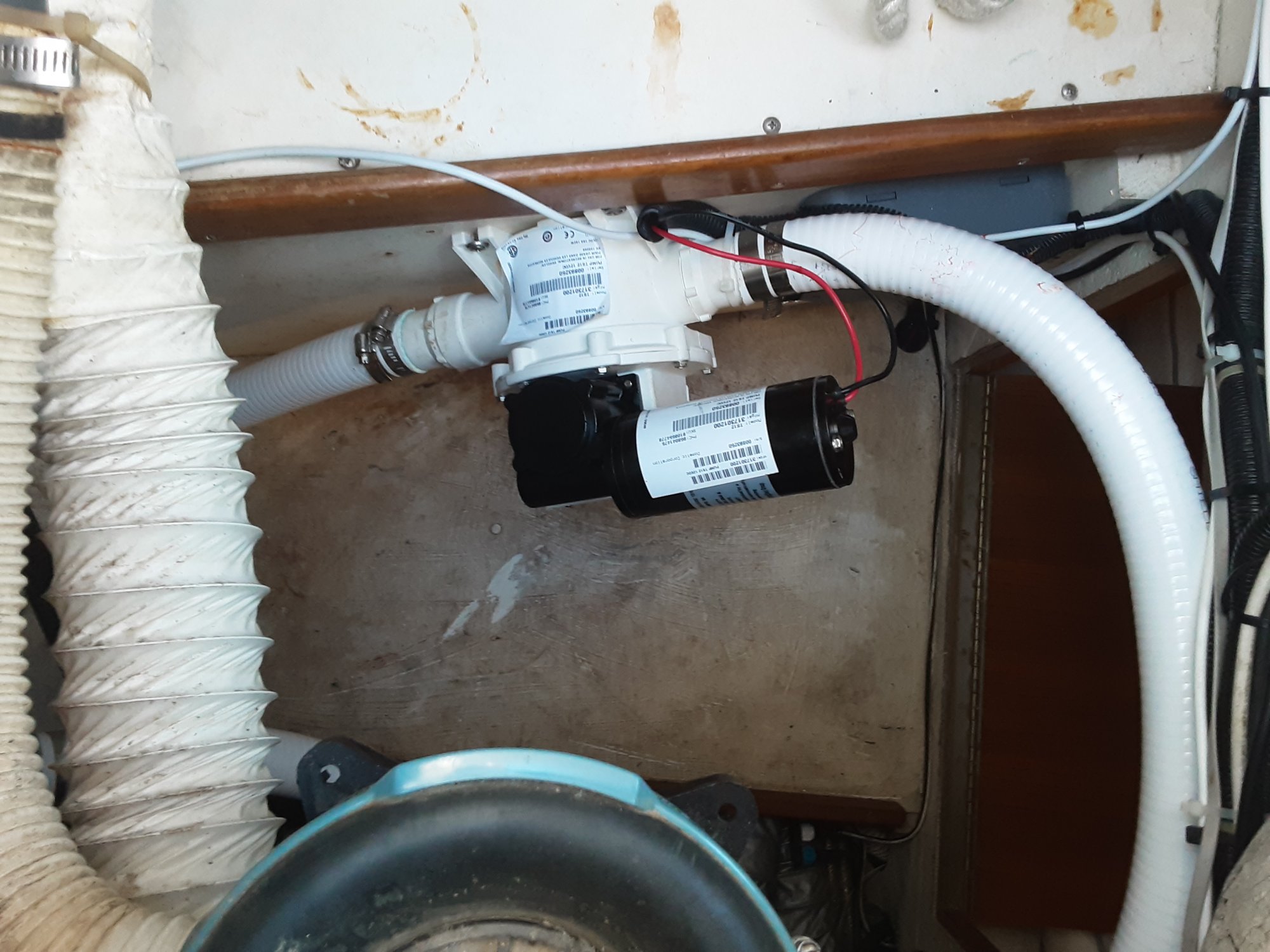

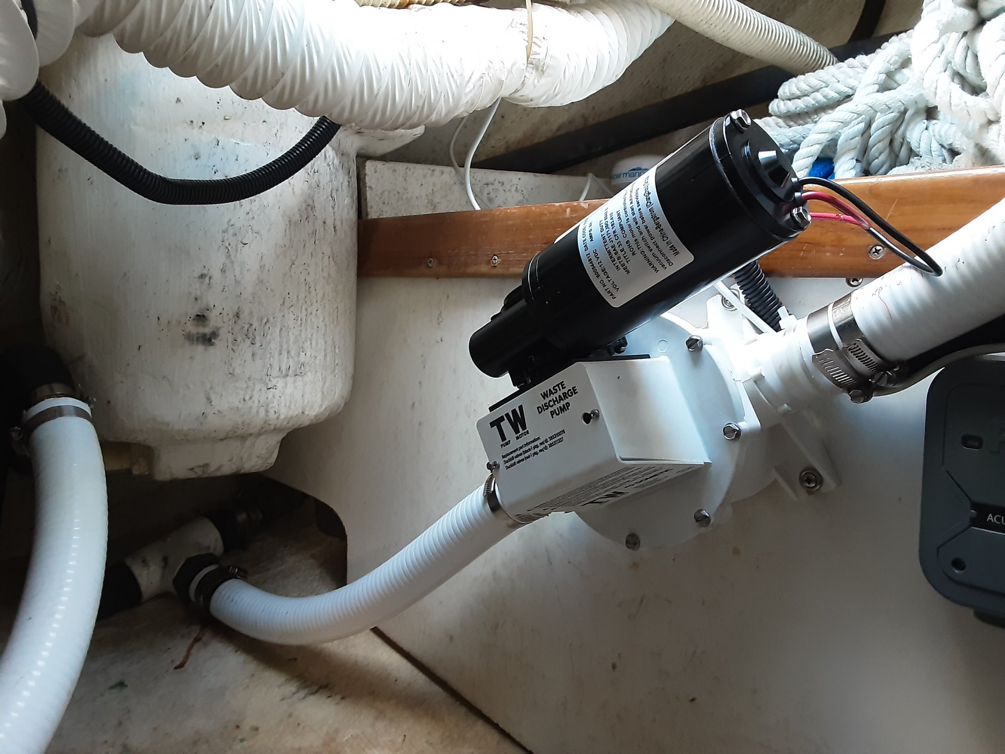

I have taken you advice and replaced the jabsco macerator pump with the Sealand/Dometic T series pump on my Catalina 310. Read and followed the directions using 5 extra feet of 1.5 inch hose to couple with the existing discharge hose to the thru hull. Attached is some pictures of the installation. Right after I finished yesterday I was convinced that the pump was not actually emptying my holding tank (which I filled with fresh water for this exercise). Today I pumped more out and when I went to refill the tank it seemed to be almost empty or at least not full. Based on 300 GPH pump rate I figured it would take 3.5 minutes to empty my 17 gallon holding tank. The macerator emptied it in about 10 seconds and it was obvious when it was empty. Question is: how do I know when the tank is empty? With this pump there is no difference in the sound whether the tank is full or empty. If there is an obvious difference then for some reason this pump is not emptying my tank. Thanks for your help because I am puzzled and a bit frustrated with this....
D
Deleted member 117556
One more detail Peggie. I installed this pump in the exact same location as the macerator which is about even with the top of the holding tank. This was what the instructions specified also...

Not Peggy, but since that is a positive displacement pump, you should see/hear bubbles from the thruhull .. When the tank is empty, the pump will push air thru the hose.

The T-Pump is a diaphragm pump, so it does take a bit longer to empty a tank than a 12 gpm macerator pump, which is impeller driven (That "accordian" thingy in the top of the pump is the diaphragm, pushed down and pulled up each stroke by an "arm"). So I suspect it's just gonna take a bit of getting used to. However, also unlike a macerator pump, the one of the best things about the T-Pump is, it can run dry for quite a while without harm (I got distracted and let mine run for at least 10 minutes once), so it's not necessary to keep an "ear out" for the change in pitch when the tank is empty...there won't be any...the pump will just keep making the same "chunka chunka" sound till you turn it off. Just check your tank level indicator when you think it should be empty (you DO have a tank level indicator??). If not, I strongly recommend you install one! The SCAD "solo" TM™ Tank Monitors | Technologies LLC isn't expensive...the sender goes on the outside of the tank...and the amperage draw is negligible.
