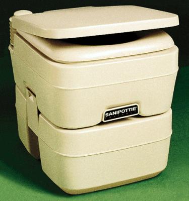

If you have purchased this head can you give me your opinion of it? I'm looking to buy a new 5gal MSD head, so I can have deck pump out. I like this unit, but have read some poor reviews.
Currently I have an old SeaLand SaniPottie 2.5 gal, that works perfectly, despite it's very old. I'd like to think SeaLand would put out a good product in this new 975 model. I can get a new larger 5gal model SaniPottie, MSD, but I kinda like some of the features of the new 970 series.
I'm curious to know what some of you think about this unit.

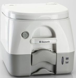

I ended up getting a Dometic Sealand Sanipottie 965 MSD, it's got a 5 gallon holding tank. I bought it from northeastsanitation.com for $113.35, no shipping, no tax.
My 1991 Macgregor 26S, came with a Sanipottie 964, which is only 2.5 gallons, not MSD. It may be original to the boat, and I must say it's almost like new, accept for some color change from age. But the thing is really exceptionally durable, it can take a lot of abuse by being hauled in and out of the boat ove the years.
So I decided to go with the same brand, just bigger holding capacity, and I really want deck pump out capability, so that's why it had to be MSD.
The Sanipottie 975 MSD caught my eye because of the pressure flush feature and it's styling. But I did read some bad reviews. Also I looked at one and saw that the handle you pull to flush, is attached to a plastic shaft, which is exactly what the bad reviews were about. Apparently the shaft can break. The older 965 model has a stainless steel shaft. Much less high tech, but a very proven unit.
Also in my case, I'm limited to the hieght of the unit I chose, the Thetford is something like 16.75", vs the Sealand 965 which is 15.5", one more inch in height would not work for me, because of cabinet doors that would hit. And another plus for me is that the new unit fits right in the same footprint of the old hold down brackets. All I had to do was swap the brackets for the taller ones.
I haven't installed the deck plate yet, but I did purchase a SS deck plate along with OdorSafe Plus hose.
Something I forgot to buy within this purchase is a vent fitting, so I guess I'll need to get that. Will I need to get odor free hose for that too?

I installed the smaller Sealand msd toilet on my v222, after an unfortunate portapotty accident...:eek:, the larger one was too tall for the space in the boat, works fine easy to install, no leaks. Being able to pump it out means not having to drag the tank through the boat.
