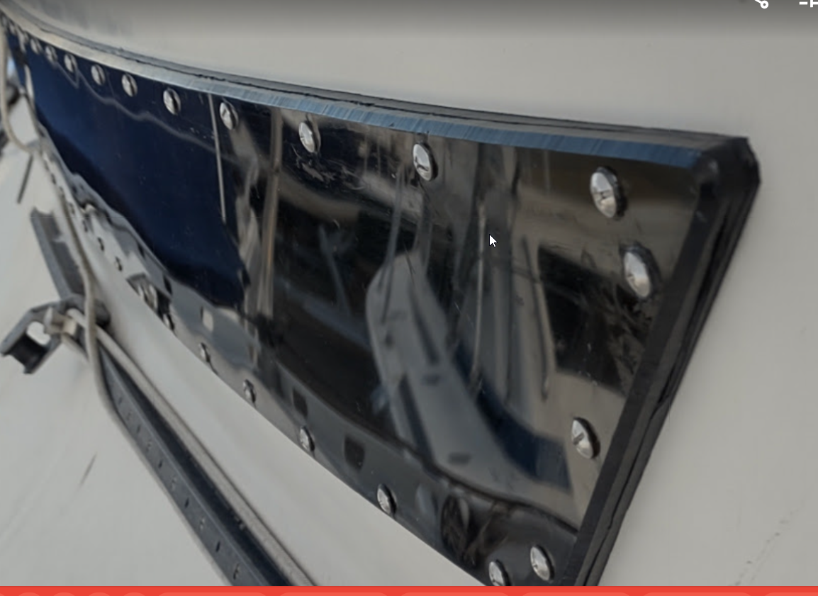

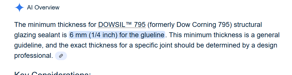

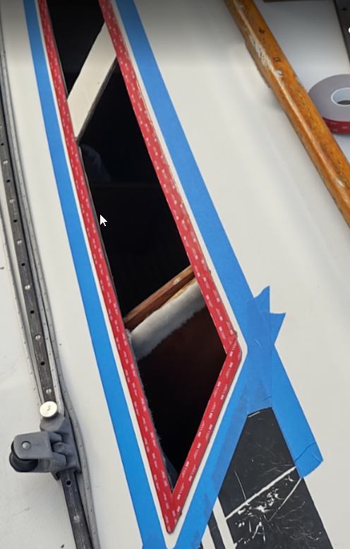

just to complete the VTB+795 discussion - I did this a few years back - and I did not see this mentioned in any of the discussions: 795 requires a minimum layer thickness - I had to double my VTB tape to get close to that. If applied to thinly the 795 will not be able to accommodate the required stretch and may peel off.
