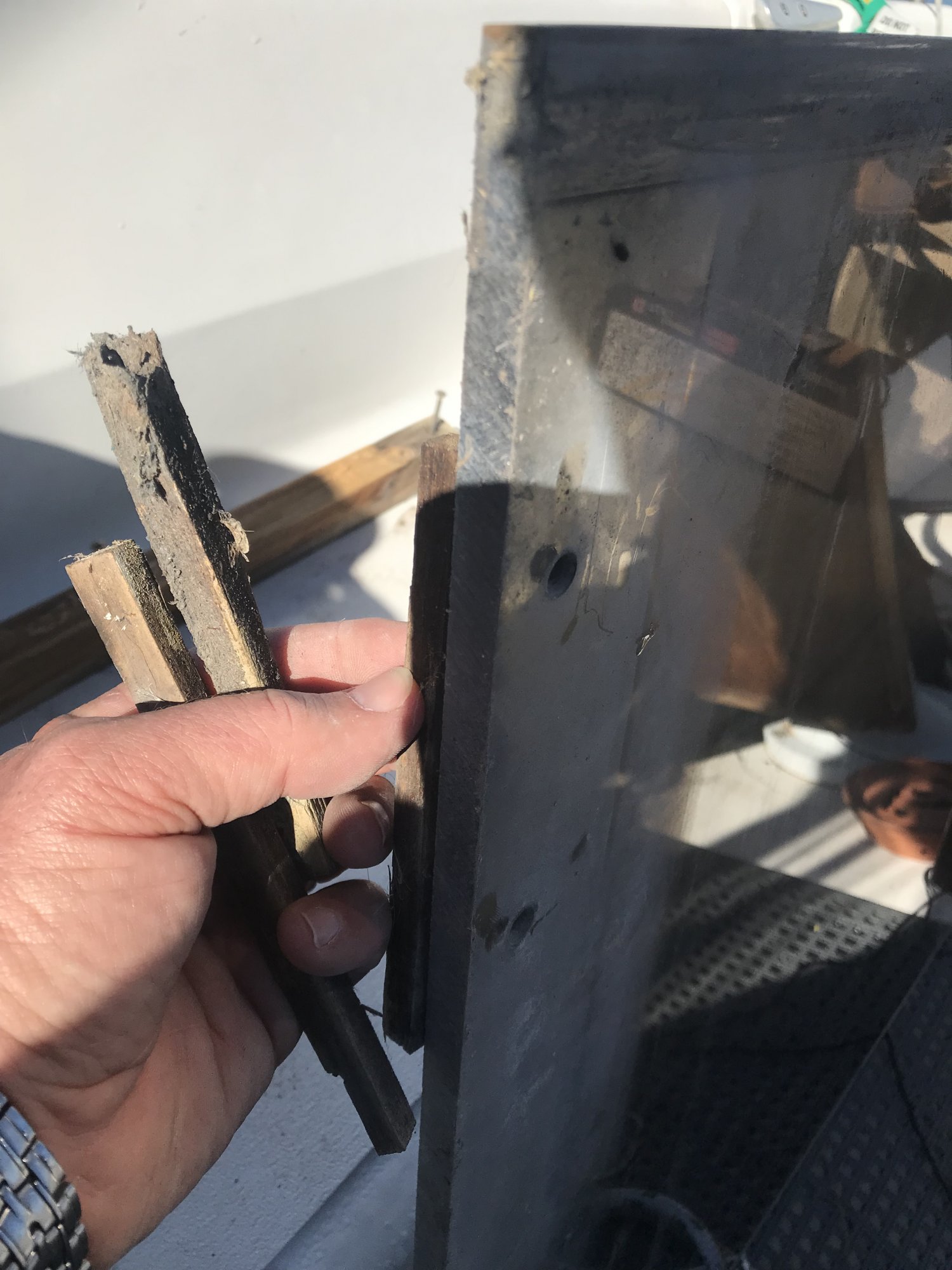

We have a terrible leak over the companionway. My husband removed the seahood today. It released easily and we found lots of dirt in the drain channels. The wood stop on the lexan slide had rotted away, which probably increased the water flow down the wood walls of the companionway. We will clean things up, install a new wood stop (teak?), and reinstall the seahood using butyl around the screws. We hope this will lessen the leak significantly, if not stop it.
