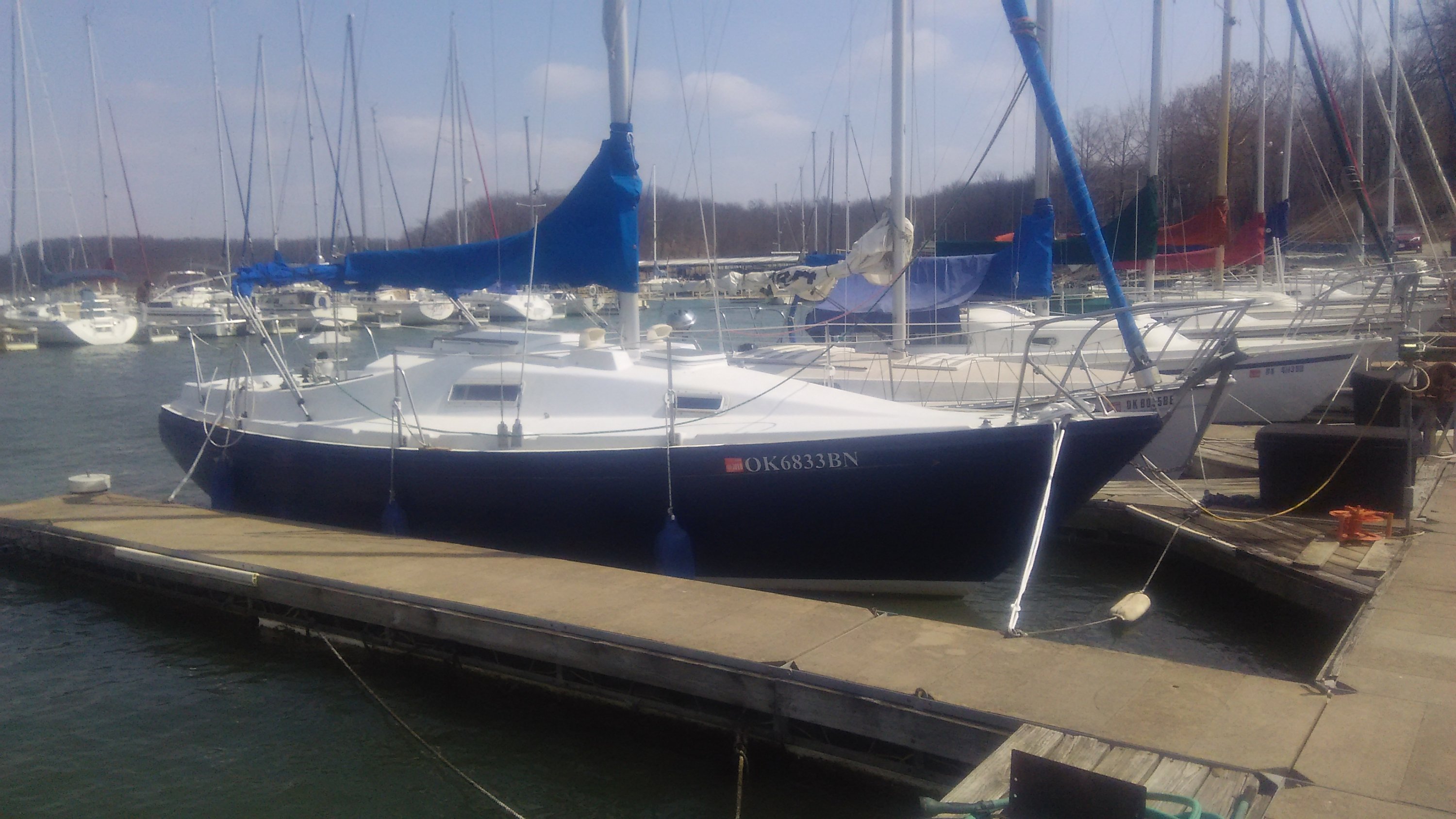

I am considering buying one, a 1976 model that appears to be in excellent condition. Current owner has done a great deal of work on her, selling because his wife has developed a phobia of heeling and he bought it with the idea they'd sail together.
I can't find much info on this boat besides the specs on sailboatdata.com. I saw a post on SBO about similar model, except with swing keel, named ROMA, featured on "Coastal Cruising With Hugh & Suze" blog.
Anyway the post mentions a 20 hp outboard auxiliary, but the one I'm looking at has 8.8hp Yanmar single-cylinder inboard. Is that enough power for a 6610 lbs. displacement boat?
Any further information on this boat, especially the fixed-keel model, would be appreciated.

I worked at the Seafarer factory in Long Island one summer in about 1970, a few years before that one was built. Check these:
The ones when I were there had the deck assembly glued to the hull with thickened epoxy, and the chain plates attached to u-bolts that went through the deck but were not attached to the hull. I can't tell from the photo how this one works, but it looks like the chain plates bolt to the side of the deck. Check that area and the toerail area, as if it is designed the same way there is a lot of stress pulling at that hull-deck joint.
From what I recall the portlights were rather cheap plastic of some sort with the white frames molded in, and the inner and outer parts were screwed onto the glass surface with some filler under the white frame part (that is, not through bolted). Seemed prone to loosening and leakage to me - so check the integrity of these. If the holes are a standard size I suppoe it might not be too hard to fix if ever required.

That's a familiar looking place! :)
The 8.8 would be enough for the lake it's on now. Quite a few boats on Oologah have the single lung Yanmar and do just fine in any reasonable condition. Any questions shoot me a PM.

The seller and I went out for a test sail today. I like how she handles. I'm not used to wheel steering - I have always had a tiller up to now, but I like the wheel. The current owner tightened it up and there is no slop or play.
I did check the chainplates. They are indeed bolted to the side of the deck, but all looks solid and there is no separation of the deck and hull. The portlights are in good shape. The engine has been well maintained and runs good.
Upshot is, I'm going ahead and buying her (you knew I would). I believe I'm getting very good value for the money.
