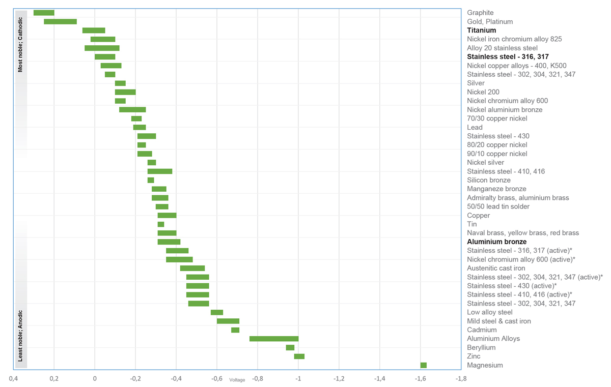

This is correct. It is the mechanism behind the galvanic potential charts you see floating around in different places:
