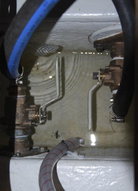

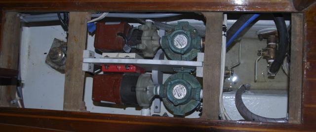

Yup, My 34 had gate valves too. The previous owner had those changed out to proper seacocks before I got the boat. Not sure about the sizes, Ryan.. On my boat, I think the sink, the lavatory, and the holding tank pump out are all 1 1/2" .. They aren't flush. The head intake and the raw water for the engine are the 3/4" ones. I have one more 3/4" for seawater to the sink foot pump and to the air conditioner.
The engine water intake has the proper slotted blister over it, and I think the hull fitting may be flush to accomodate that slotted strainer.

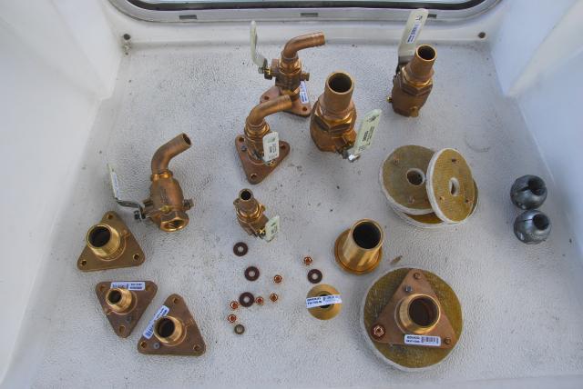

Good advice here. Your boat probably has never had a real seacock in it. Haul out, knock out every single through-hull you've got. Cut 'em in half with a dremel and just get them out.
Spend around $500 and build true, safe, reliable seacocks from quality bronze. I went with Groco and their modular flanged adapter set-up. Mainesail has some great how-to stuff on his web site. I don't have it but he's got a bunch of stuff there. It's good. I used his carriage-bolts-cut-into-studs-threaded-into-a-fiberglass-backplate method for my latest batch of through-hull upgrades last summer. Worked great. I highly recommend it.
Oh, and I wouldn't even bother with looking for a 1/2" valve (if they make one.) Just build a 3/4" and reduce after. The valve will handle a larger obstruction and you can disassemble downstream of a closed valve for cleaning whenever you need anyway.
Do it right.
