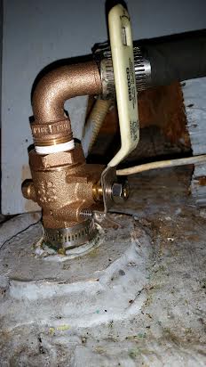

It appears that the PO attached a 3/4 to 1/2 reducer on top of the old gate valve. Then screwed in a 90 degree adapter that ended in a 3/4" pipe where the hose is clamped. Strange.... I guess they couldn't find one of these: http://www.overtons.com/modperl/pro...rko4Xn9-xmk_YBUsO3-30p-sHvfqr5tnjIaAj308P8HAQ
That setup is going to slow the flow of water and possibly be a choking point for debris.
Thank you...but I do not understand...are you suggesting keeping the reduction from 3/4 to 1/2 and just add the 90 with barbs on the end to grasp the hose better?

Oh, I think I understand now...the 3/4" comes from the thru-hull threads...then reduced to 1/2", only to open up to 3/4" again at hose. And your rec'd is to keep 3/4" all the way, right?

Right... Toss the reducer, elbow, and pipe and replace with a single Groco 3/4" elbow with 3/4" nipple.
Thanks, I ordered that 90 degree 3/4"on both ends bronze fitting from WM today...will update forum when item is delivered and installed...you must have a nice keen eye for "strange" plumbing setups. I believe your reply was true and really well stated.

Problem solved...Here is a pic of updated Ball Valve installation completed today with a 3/4" 90 Elbow.
