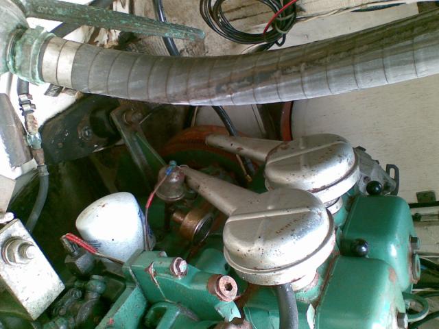

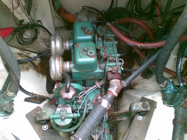

Here are a couple pics showing the seacock in question. They were taken shortly before I changed the hose.
Those look like old Groco's. The top fitting is usually male NPT pipe threads and you'll need a female NPT hose barb/tailpiece.
Do not replace them unless they are the model with the rubber pieces you can no longer get. Those seacocks can last for a good long time.
They could be Spartan?
Feb 6, 1998
11,772
Spartan's are a two bolt flange and the handle is different.. Wilcox Crittenden's were also two bolt on the later ones and would take a Spartan handle but early Wilcox seacocks were round flange and square handle peg... It was hard to tell the early Groco's from the early Wilcox...
The later Groco's were the ones that were problematic. They had a plate with two bolts that held the cone assembly in place and they too had moved to a two bolt flange. IIRC they were called the SV series but the op does not have Groco SV's..
