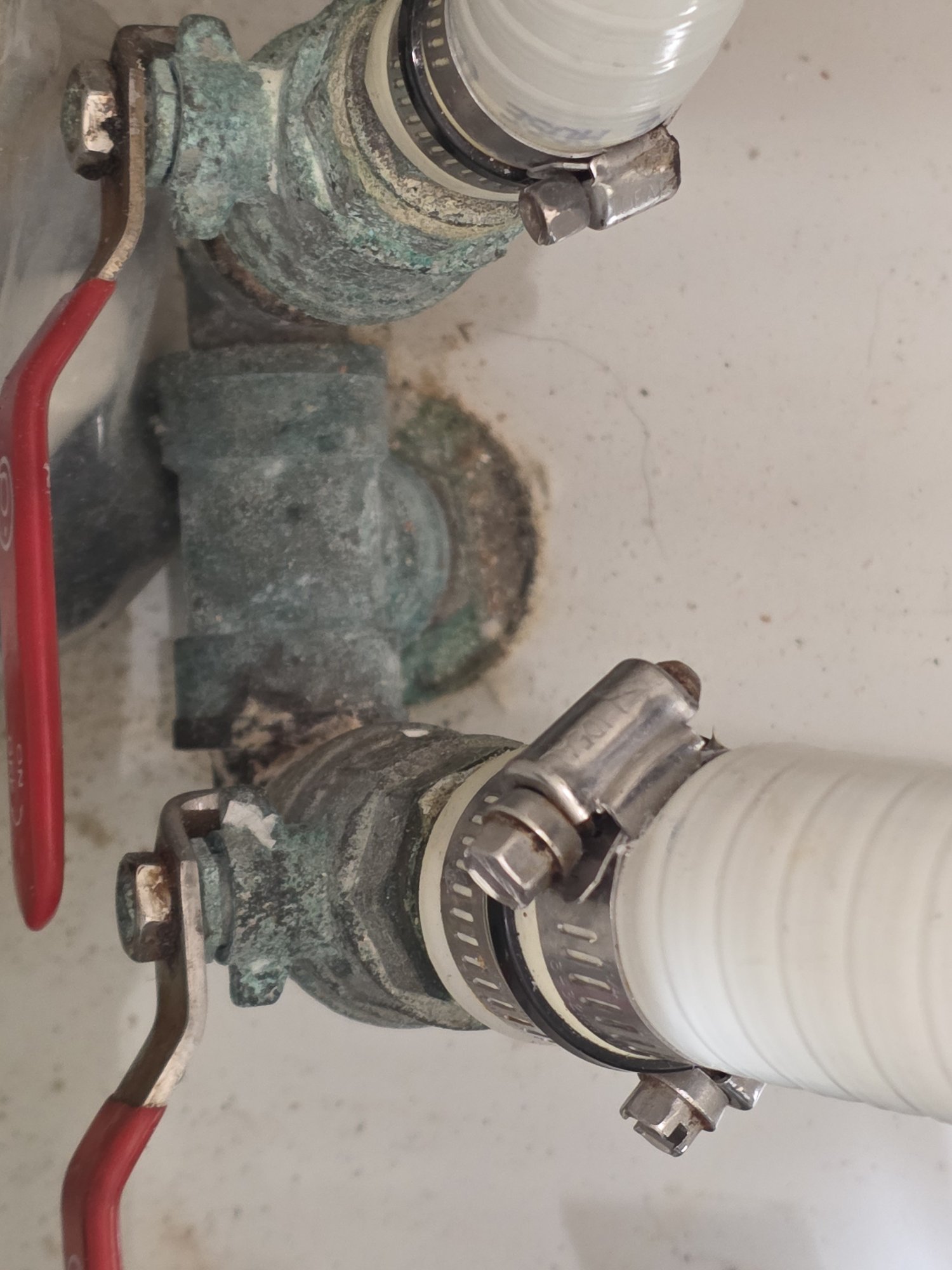

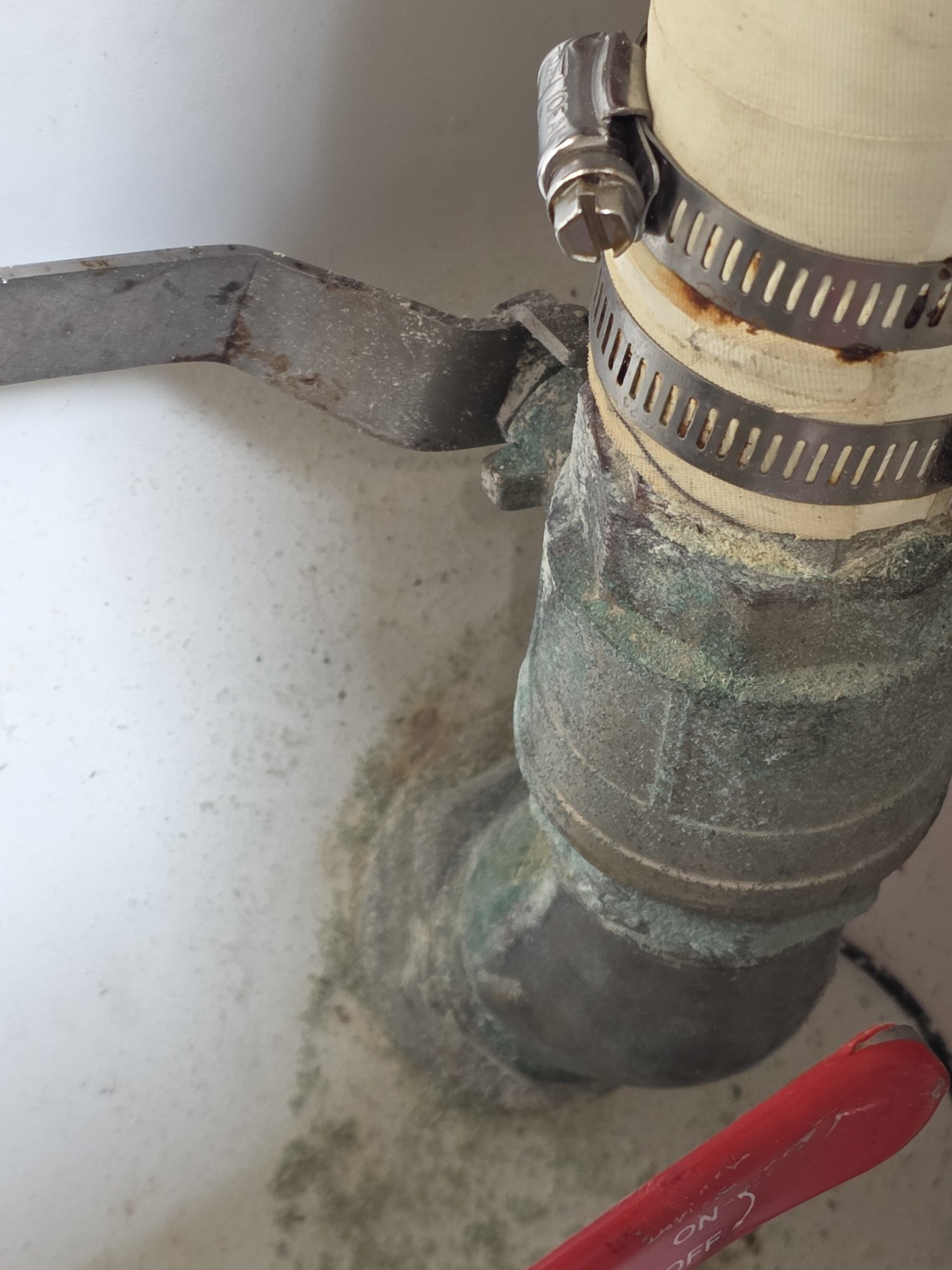

I've noticed some of the seacocks on my 2007 B373 are slightly corroded. The main one I'm concerned about is in the head under the sink. Because I don't use it much since I'm not offshore often, the dump to the outside for the toilet is corroded and working the handle very difficult. I'm guessing since it is not used much it just begins freezing up. But on the outside there is visible green corrosion. I'm not sure what it is made of but it appears to be some type of cheap alloy metal. If I don't touch this, I wonder how dangerous this is. I'm thinking of using a wire brush to remove the green corrosion. Is there something you can paint on this to protect it?

Hard to provide good advice absent pictures. Bronze can turn green normally. More concerning is that it isn’t “exercised” routinely which everyone should do with all seacocks to prevent th ball from ceasing.

I would replace it…… if it does not look good this has the potential to sink your boat. The original beneteau valves were not bronze and look silver unlike a true bronze part like a Groco valves….. with my 2005 423 I am slowly replacing all of the fittings, skin fitting (thru hull) as well as the valves. So far none of the originals have been that bad. Better safe than sorry.
good luck!
24,455
Good images. It is a tough call.
Factors.
  • Boat was built in 2007. That makes her 19 years old, possible that the through hulls are original based on observation of the valves.
  • There is some surface corrosion evident.
  • Valve operation (stiff / smooth) is unknown
  • No information about the need to change shaft zincs. If you have to change shaft zincs more than once a year that is evidence that where the boat sits has electrical energy in the waters and it is attacking the zincs. There could be galvanic corrosion going on inside the valve or through hull.
This is a judgement call based on as much evidence and factors that you can develop. We are looking at the outside of the valve (seacock). Unfortunately you can not see what is happening inside the valve or to the “through hull” metal.

Nothing in the picture scares me much. There’s no pinking or signs of severe corrosion, just surface patina. Having said that, they are 19 years old and if they’re not moving as smoothly as they should I wouldn’t be afraid to replace them.
