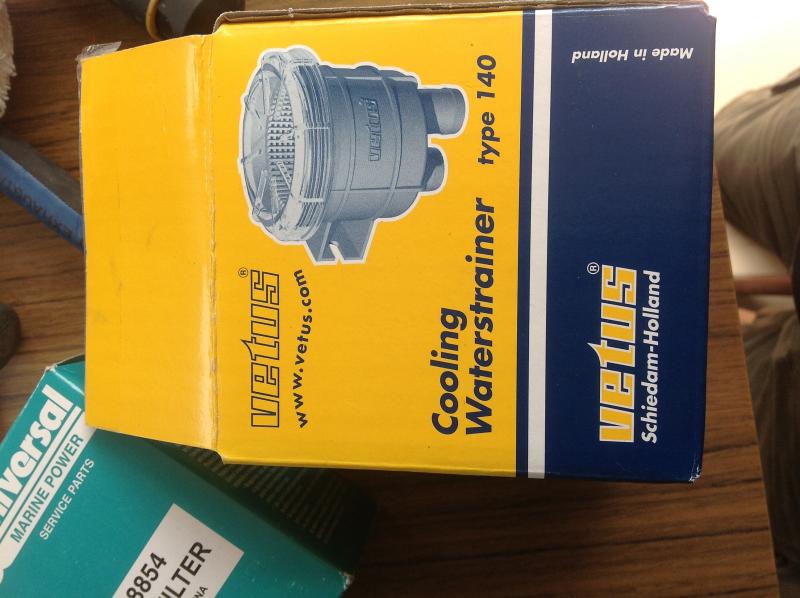

Vetus makes a nice small plastic one that I mounted on the stb. Side of the engine room. It is high up and forward so you can easily pour antifreeze in it and is at or just above the waterline. I also increased the hose size to 3/4 inch from the 1/2" hose that went into the engine.
So far, it works like a champ. It took about an hour to install. I will look up the model number and post it.
