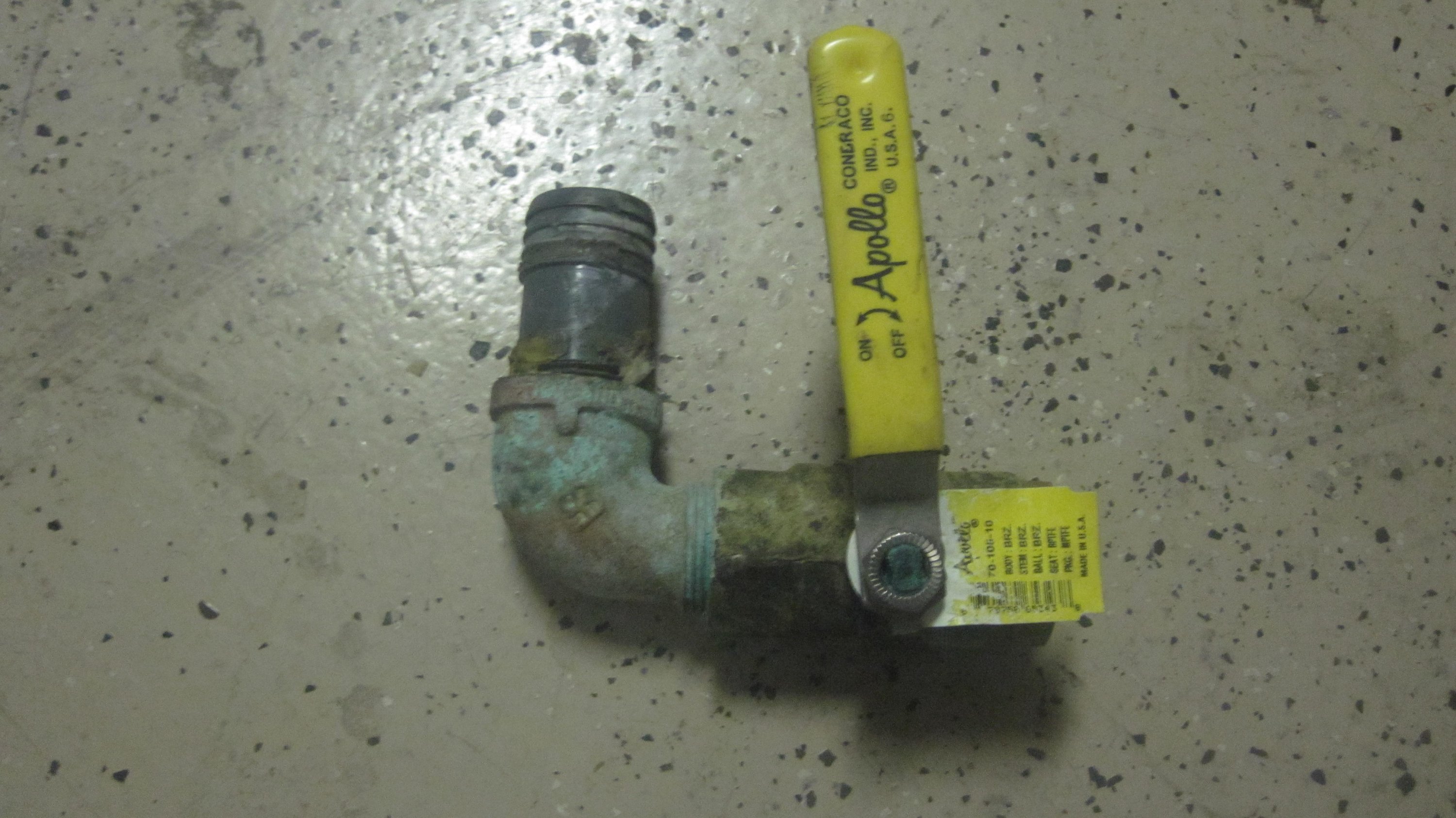

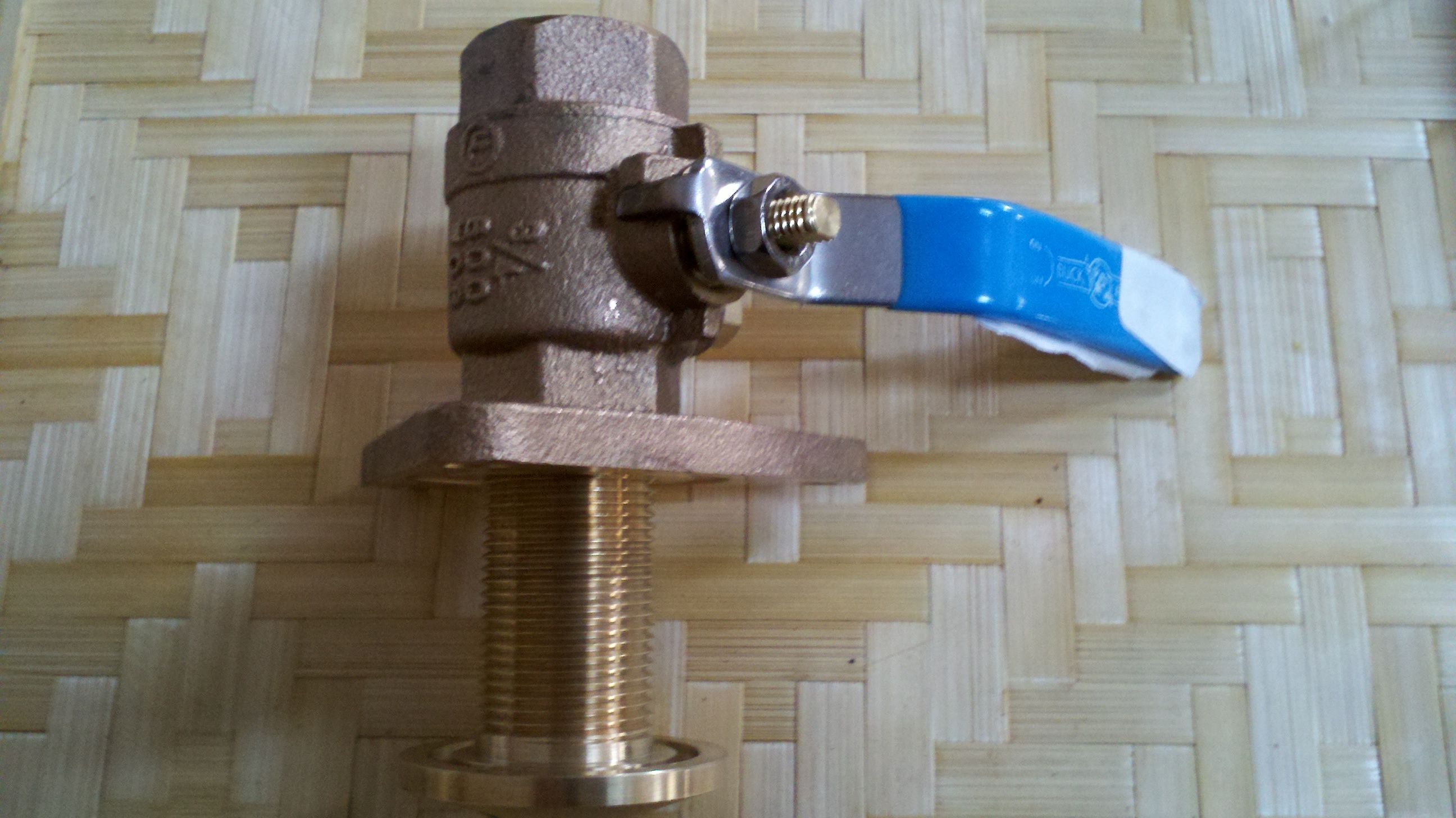

What valve is on the thru-hull? Our Cherubini's came originally with 1/2" gate valves(bronze faucets). Some of us have installed a 3/4" thru-hull so that a true seacock could be installed. Before I got to that I put an elbow on the thru-hull with a bronze 1/4 turn shut-off.

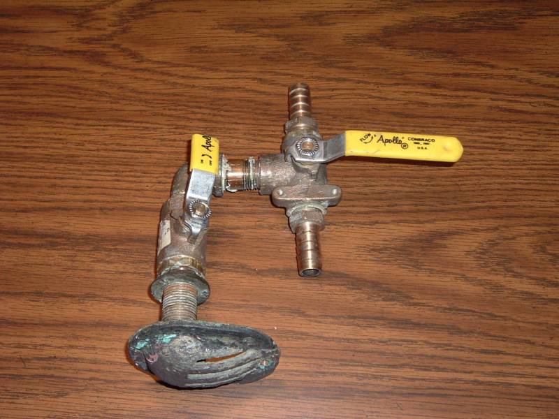

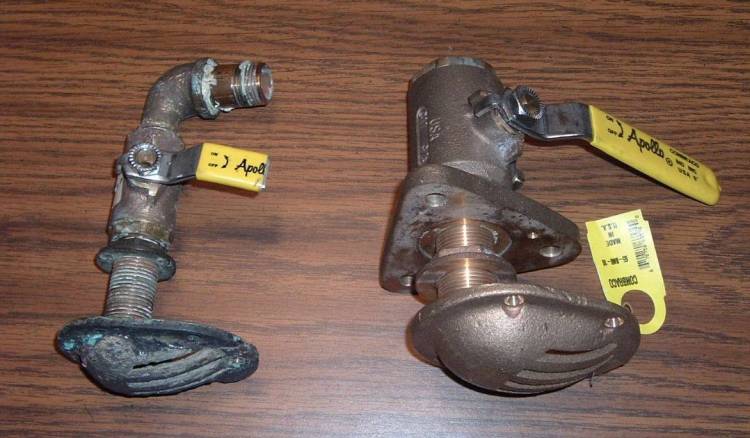

While you have it apart, add a tee in place of the elbow (or some convenient arrangement). Add another shutoff valve with a fitting to take a garden hose. You can use that to help winterize the antifreeze, or to pump out if there is a flood. I also use mine to drain the 40-gallon water tank and run it through the engine prior to antifreeze.
Jun 2, 2004
5,802
I use a T-valve also. It is used for the air-conditioner input. Originally I had it on the 1/2" thru-hull and now on the 3/4" seacock.

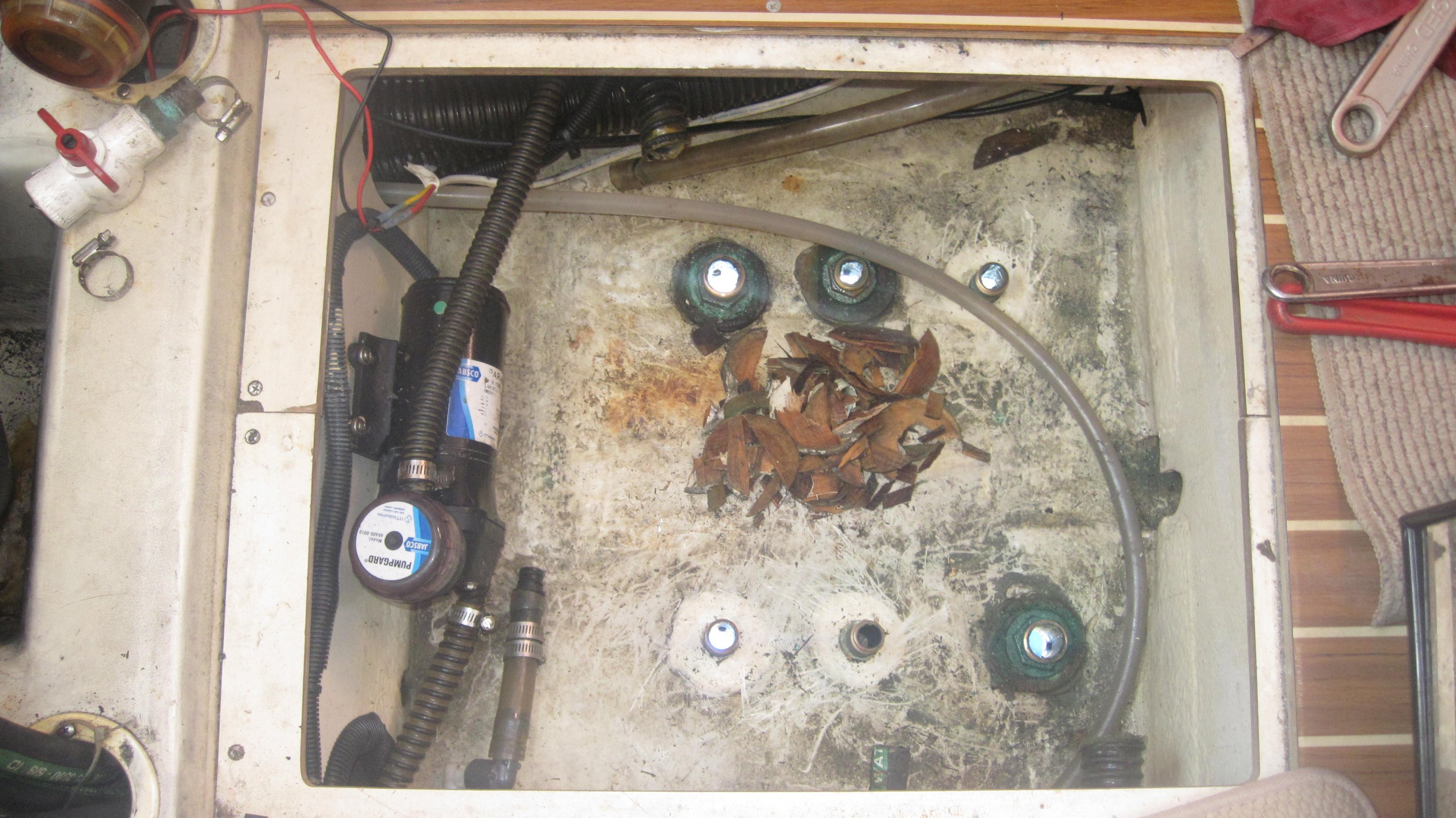

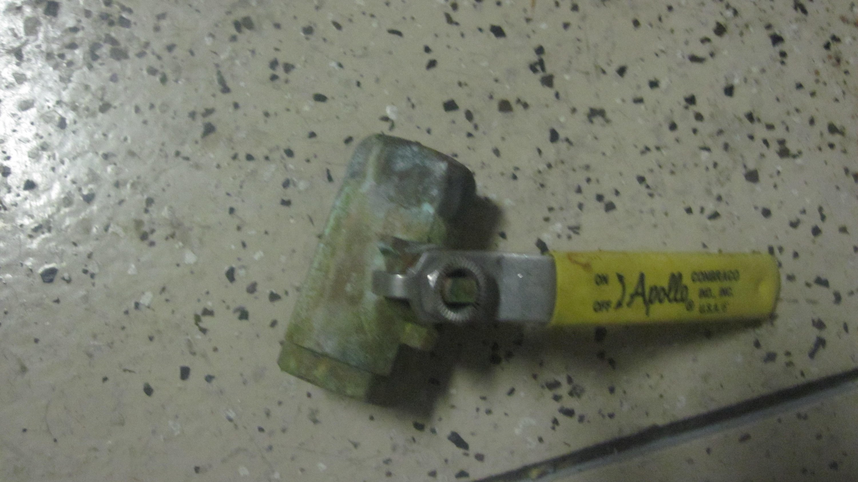

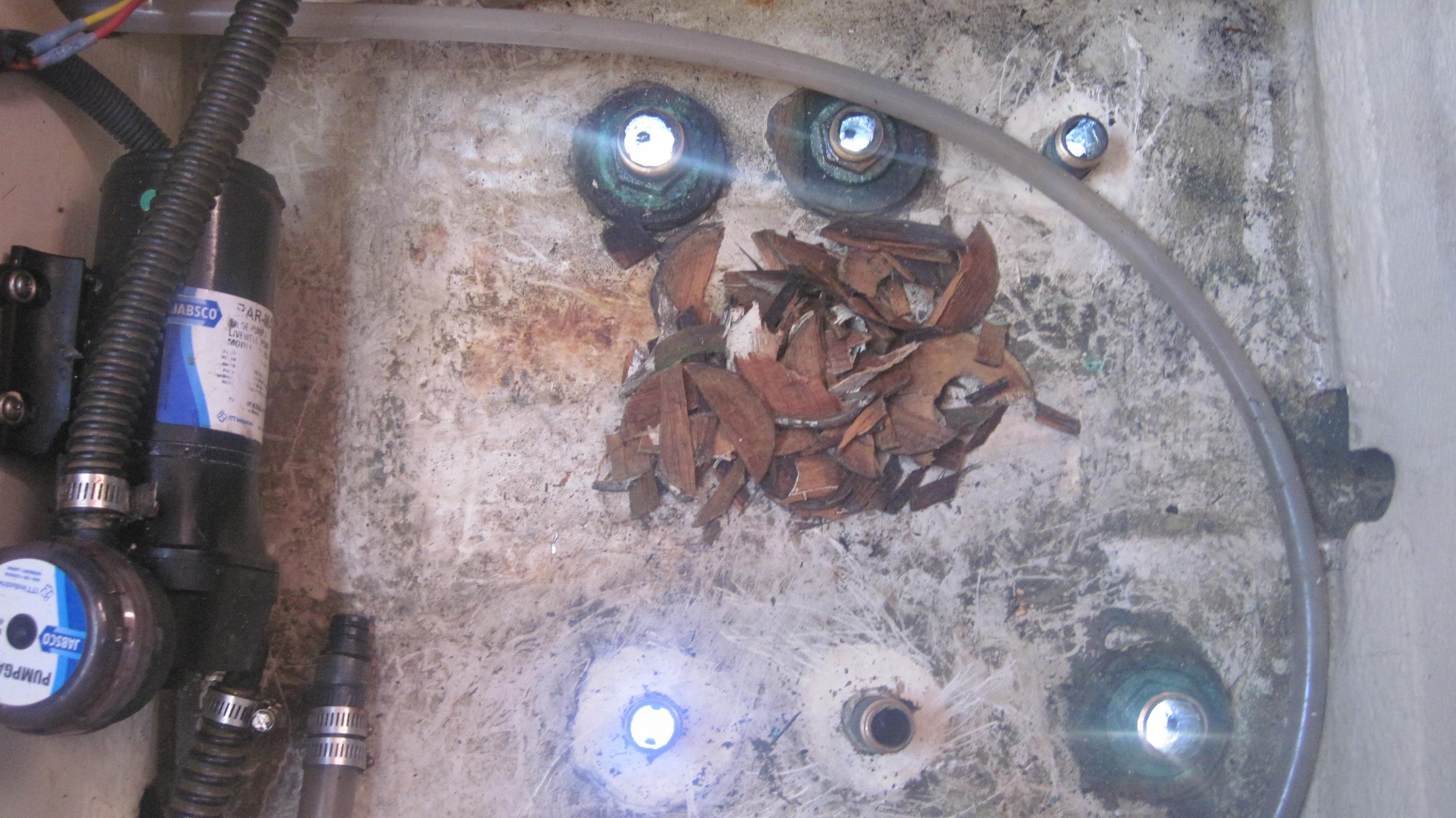

Dec 19, 2006
5,834
Hunter 36 Punta Gorda

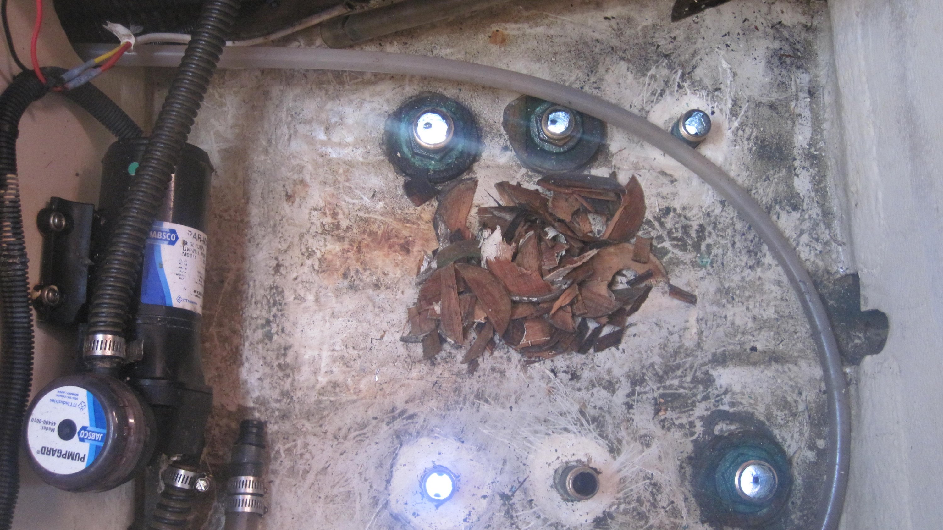

Problem is that most likely if like my H 36 the value unscrew
Off the thru hulls part and when you try to unscrew it the whole thing will turn.
I am doing this now but my boat is out of the water and removing all thru hulls to lub but had a he'll of a time with tool up into the thru hulls to keep from turning while unscrewing the value and yes they all were turning and still trying to remove one that is still stuck.
I did wait for the bottom job haul out to do it so beware if you try this in water because if you make them turn they will leak .

Dec 19, 2006
5,834

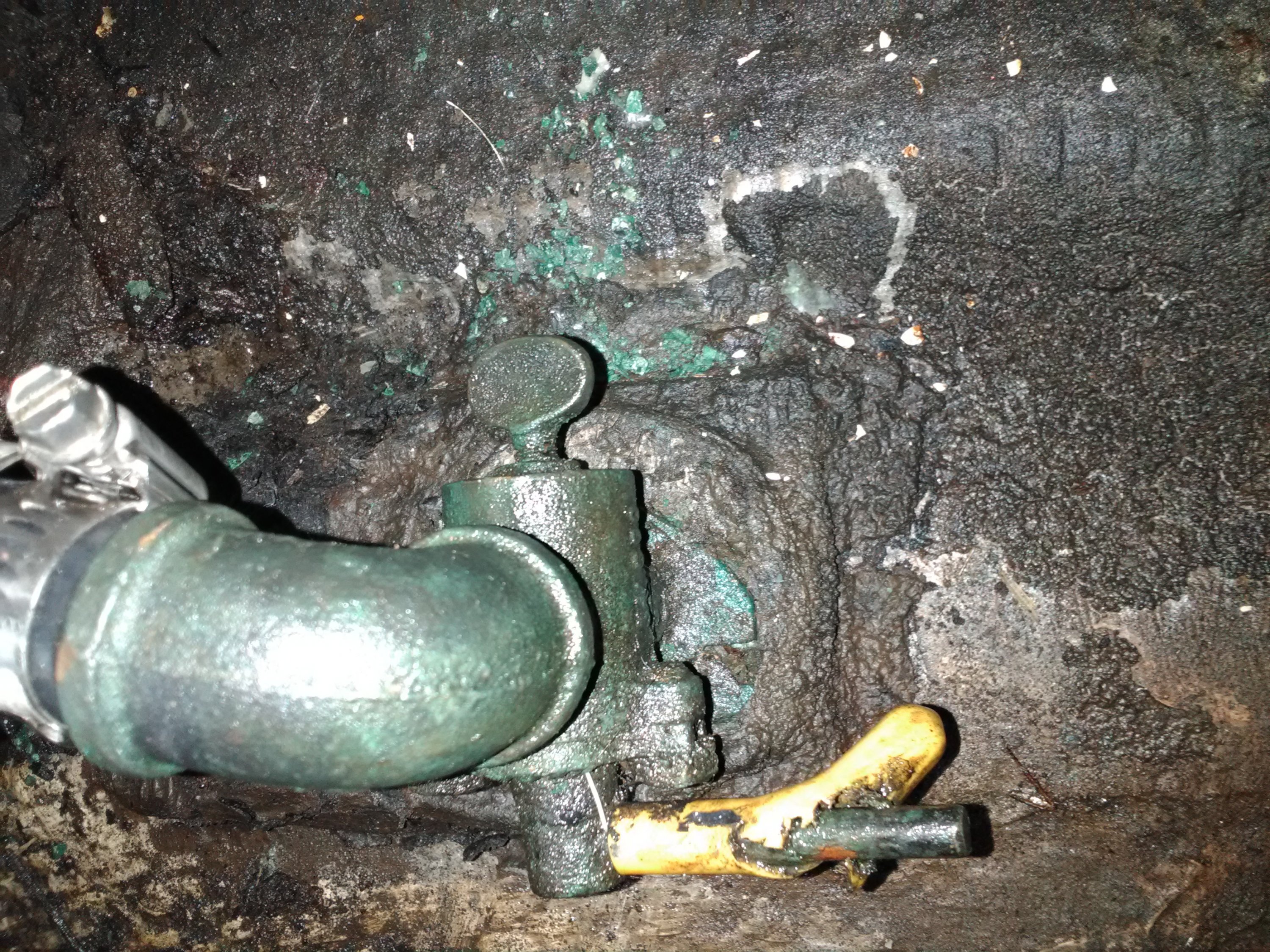

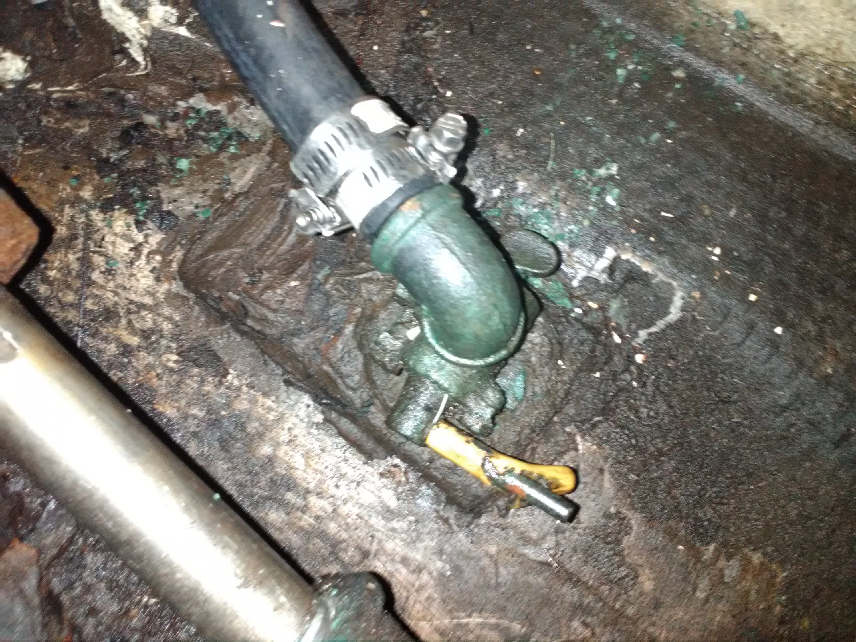

After looking at yours in photo I would not touch that thru hulls until out of water.
1,099
I have to agree with Seadaddler - replace that sea cock out of the water. By all means, change the hose now, but wait until haul out to change the sea cock and maybe the thru-hull.
10,251
That is a tapered plug seacock I think?.. The thumbscrew in the body (at the 45 deg in the picture) jambs a tapered plug into the tapered body. If ya tighten/loosen the jam screw a turn and tap the center post (gently and with backup) to free the plug, then it will turn. then to get it to seal again closed, ya tighten the jam screw again.. Re-open same way, loosen the jam, close plug, re-tighten the jam to seal.. Probably needs servicing next haul out.. Check this out from Maine Sail:

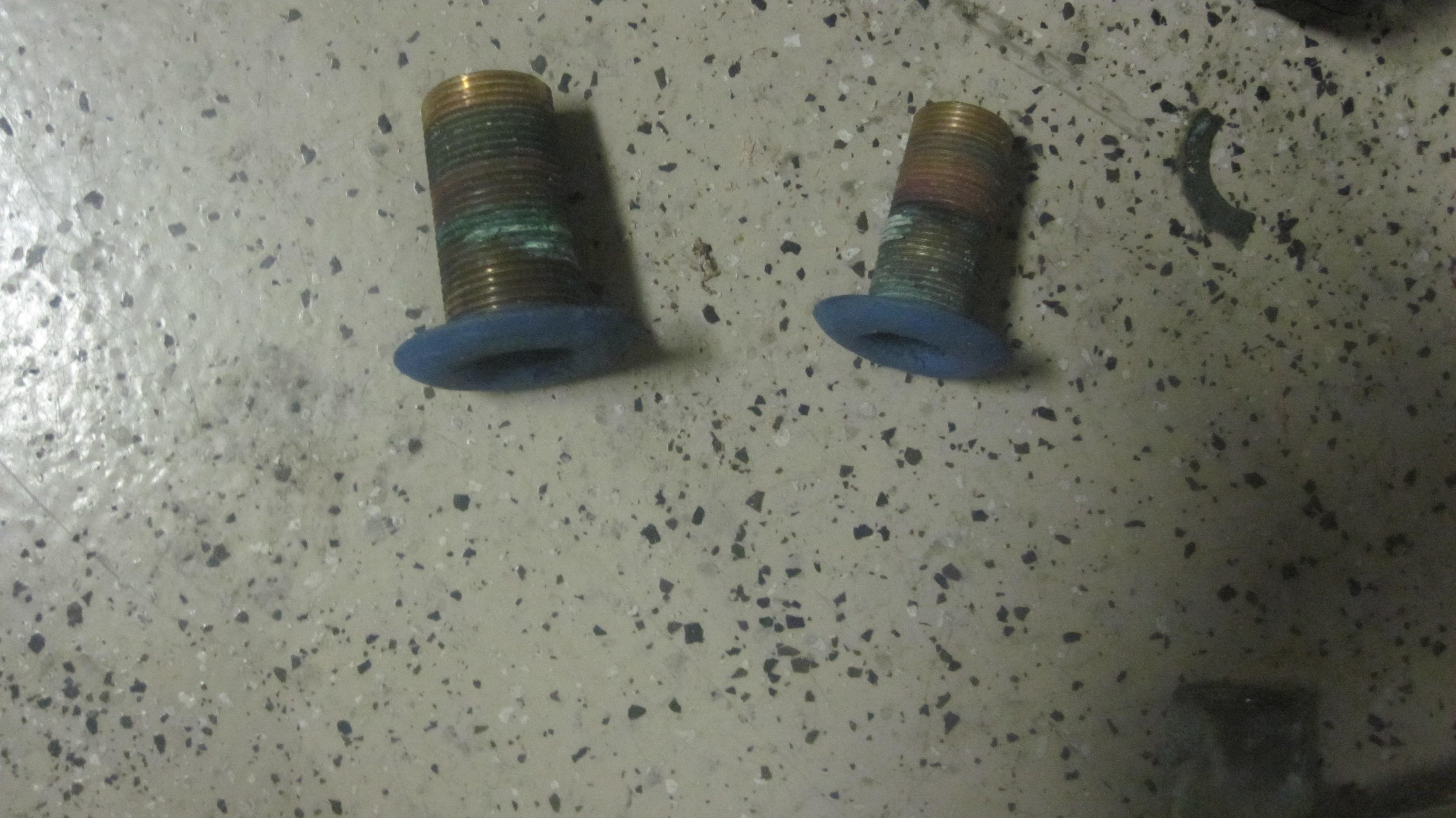

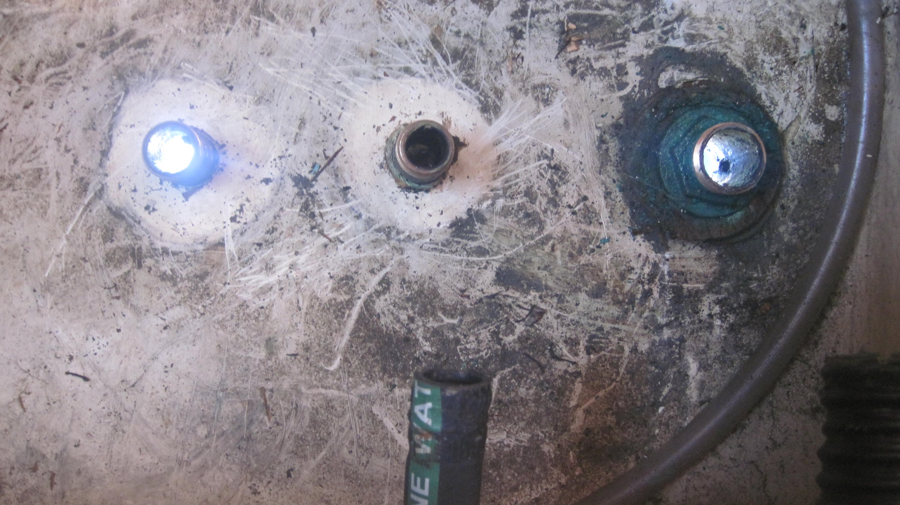

Dec 19, 2006
5,834

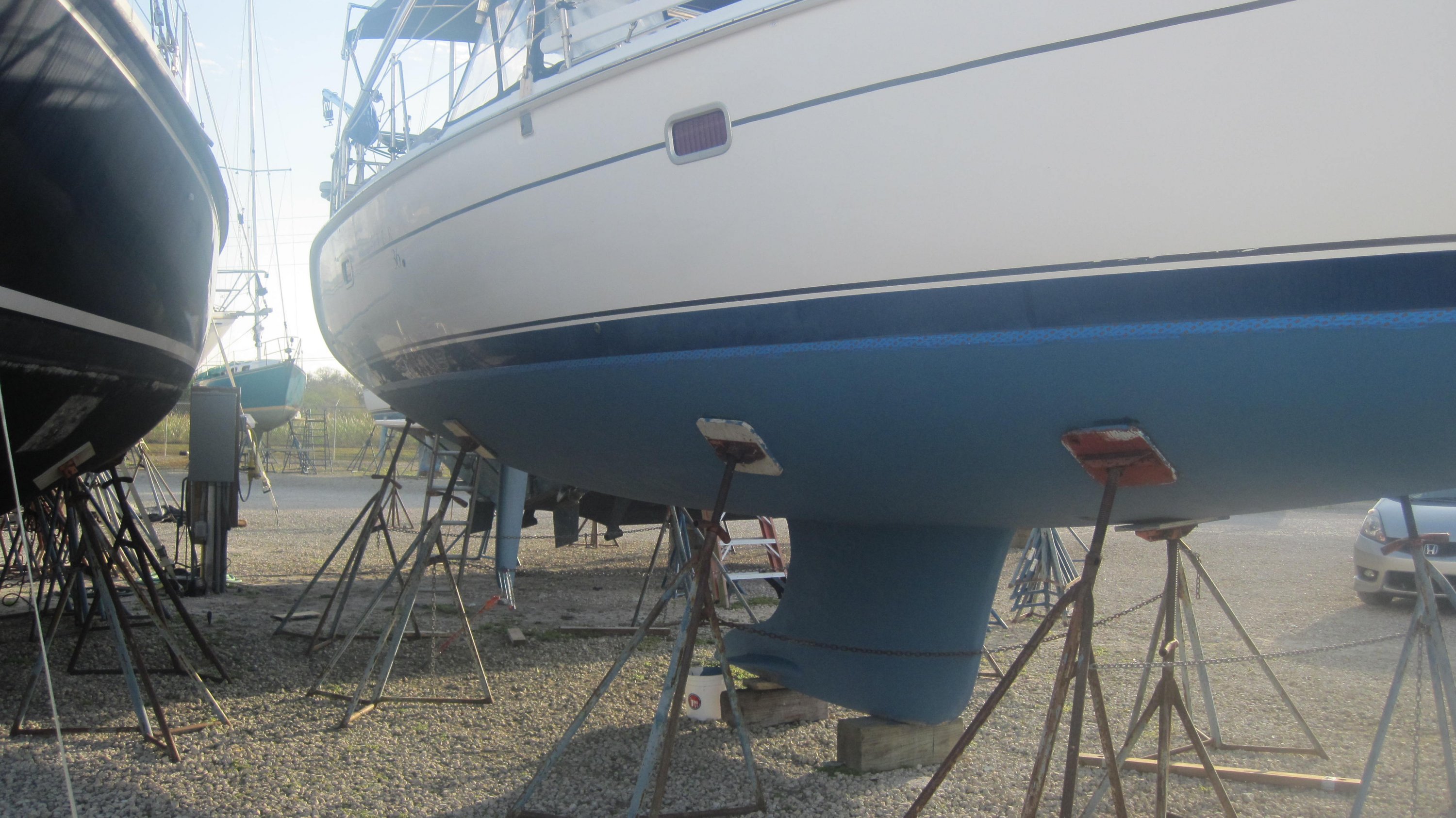

I will add some photo's again and as easy as I thought would be is not going easy and still trying to remove one
thru hull and when lubing the ones I removed found that one that was stuck open is not working properly and will need to replace 2 that both not working and even replacing the backing plates which are soggy and falling apart and so glad I waited to haul and taking much long than first thought.
I would try and haul as soon as possible and me I would not try repairing this thru hull of yours until out of the water because if some breaks or jams closed or any thing goes wrong than you are screwed.
I had a thru hull that when trying to open and close would be so hard to move the handles really scared me and just left open
so not to make it worse or do damage,I new I was going to haul for a new bottom paint this month so just waited.
I also have a Tri transducer that did not have the flapper to keep gallons of water from entering the boat and so never would remove it and than when my diver came even with his help could not remove and have ordered a new housing with flapper and doing the change while out of the water.
I have my boat in the yard for waxing Hull sand and paint and all these other projects and leaving it out for a few weeks
