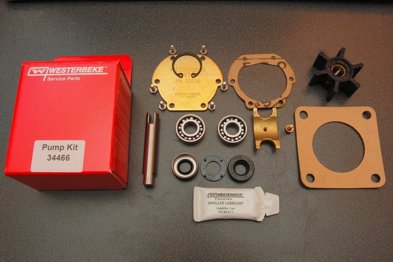

I'm soon to be rebuilding mine. I have oil leaking from the weep hole. I think the Sherwood is cast iron not bronze like Mainesail's. I have yet to remove her from the engine but plan on doing it over this winter. The rebuild kit was twice what Maine's cost. I read the C34 topic Stu references. Some really good posts on the subject. Mine will be done before she is launched the coming spring.

Hopefully you can post some pictures and some comments regarding the re-build. Who did you order the rebuild kit from and what was the cost?

I was told by a salesman at Depco Pump that Sherwood has obsoleted the G903 / G908 universal part #'s 302648 & 302837. It was replaced by Westerbeke # 42175. This was a deal between Sherwood and Westerbeke to exclusively make this pump for them. For a while there will be some parts available but they are no longer making the shaft which is the most important part. Sometime over the winter I will remove mine and take it apart to see what kind of shape it's in. Stephen, let me knowif you find anything different.

I replace my Sherwood G908 2 years ago. Purchased the pump only from MarineParts.com for $275 + shipping. If you also want to replace the brass retaining blocks you have to buy the complete assenbly from Torresen at $400. I reused th blocks and replaced all bolts with stainless. Be sure to check all hoses from the pump to the muffler. Mine was 95% clogged at the HX inlet and since the weep holes were rusted over sea water went through the seals and into the engine. I caught it quickly and did not give the water time to turn the oil milky but the oil level rose dramatically. Does not sound like your case but check the hoses.
